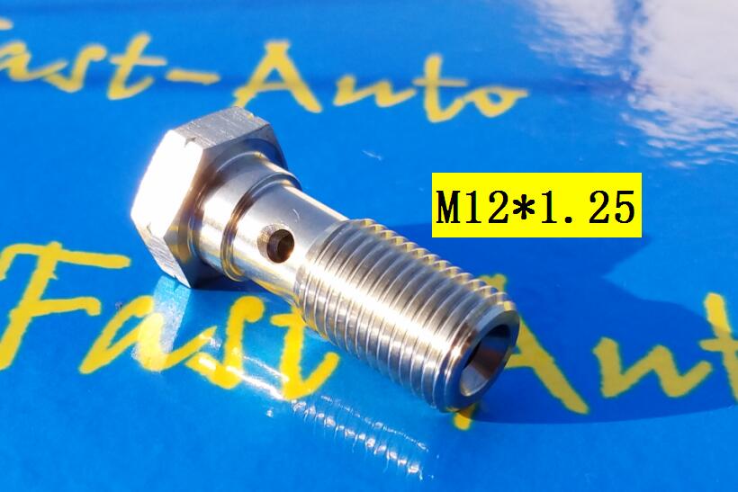

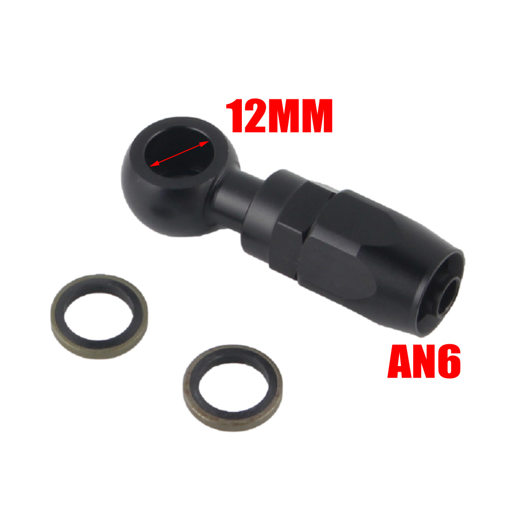

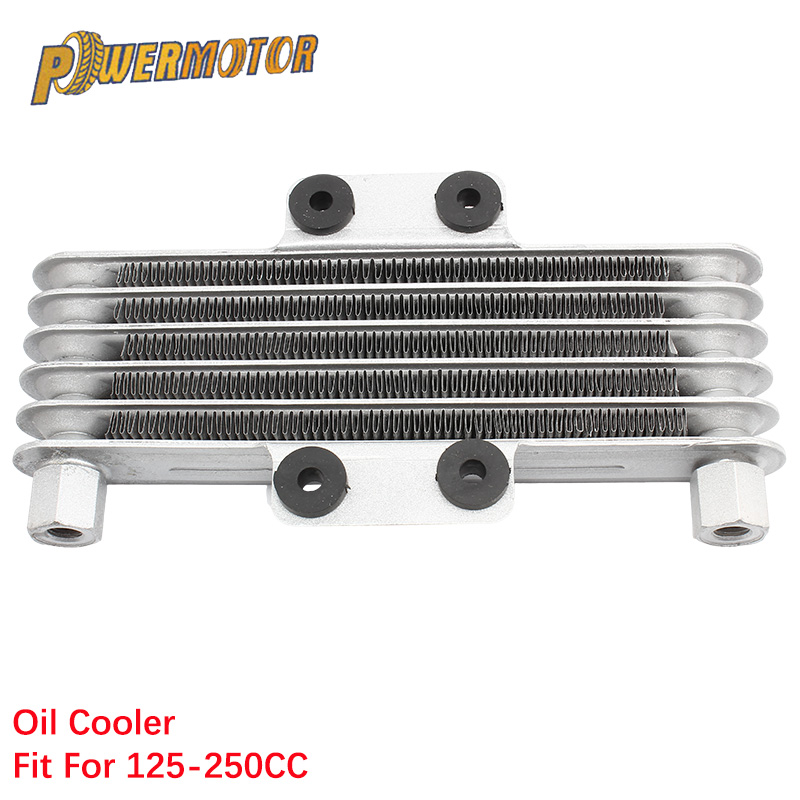

Bob, I am working on a "fit all" solution, I have just ordered the parts( perhaps they will all come together),
Shopping list so far, but not including Hose ( AN-6 )
Cooler, that measures 50mm longer and 11mm wider than OEM, should be a decent increase!
Banjo Bolts to attach to said Cooler.
Banjo Hose ends to suit the cooler and also to fit and replace the OEM oil lines
A bracket will need to be made no doubt although the hole spacing is the same so no biggy!

I see you liked my proposal! 😉m
Anyhow that radiator is available with both M12 or M14 thread. Wouldn’t be better to go M14 to maximize oil flow?
What about the stock connections? Are they M14 or M12?
I could only find 10 and 12mm, stock is m14.
That's a pity, I'm gonna dig harder! Just a question @Dool: do these AN6/Banjo adapters come in different banjo orientation? Say 45/60/90 degree of the banjo! it would be interesting to optimize the shape of the pipes.

IMG_20230223_105646_resized_20230223_111002984.jpgso today I got my cooler, pity it looks the part but has the wrong port size, I ordered 12mm.
Hose fittings and Banjo Hose End look good .
Cooler is Sufficiently bigger ?, well it bigger anywayIMG_20230223_105117_resized_20230223_111242626.jpgIMG_20230223_105209_resized_20230223_111242478.jpg
What did I tell you about the size? Isn’t it the same width as the original, just a little longer?
Hate to say I told you! 🤣🤣🤣
0.01mm, I can just feel it.
Supplier was quick to respond, send it back and get a new one, they pay the freight.
So I will probably not return it as I just so happen to have a 12x1.25 Tap and should be able to find a 10.8mm drill bit and tap it out saving the 3 weeks turn around. p :cool:
