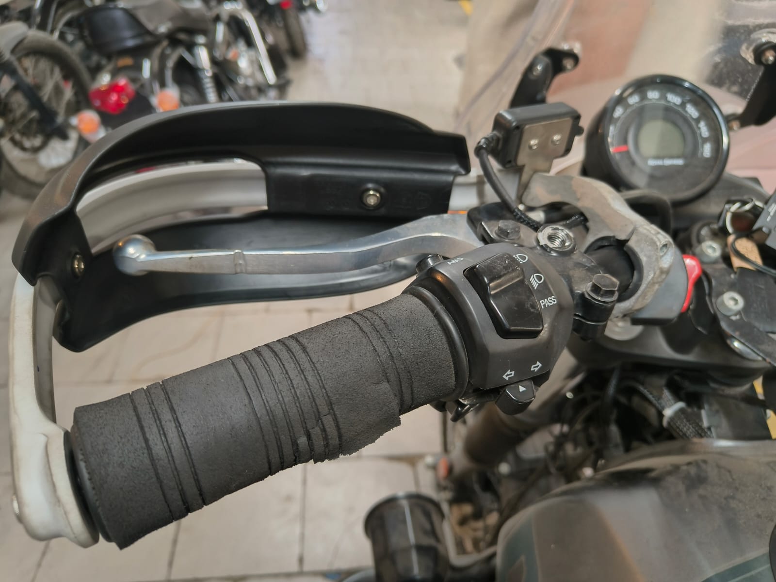

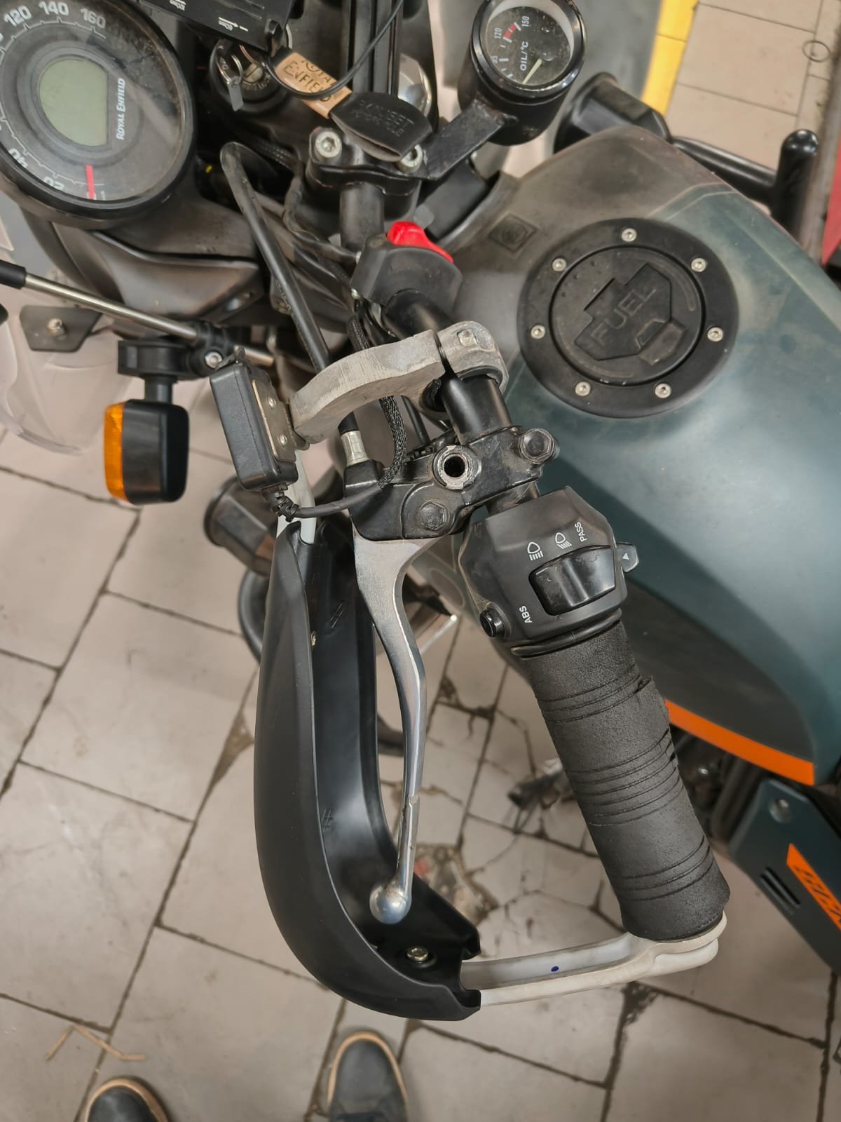

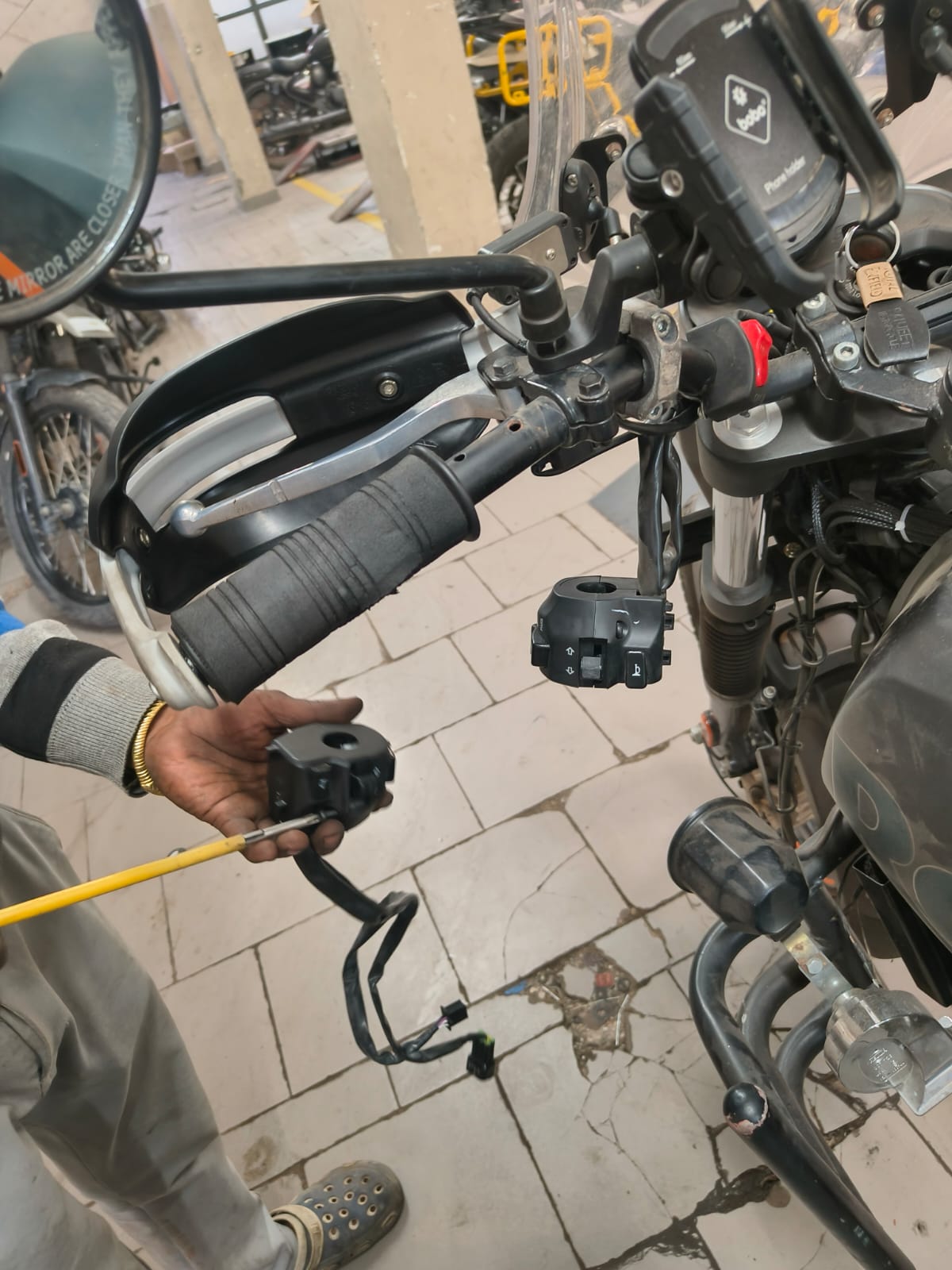

Today I did my "official" 5000km second inspection. I had done oil and filter change in Goa (full synth) so it was just the small cheap stuff, came to 270 INR (3 Euros). However I was informed that my left side switch needed to be replaced (on company dime) - why? nobody knew.

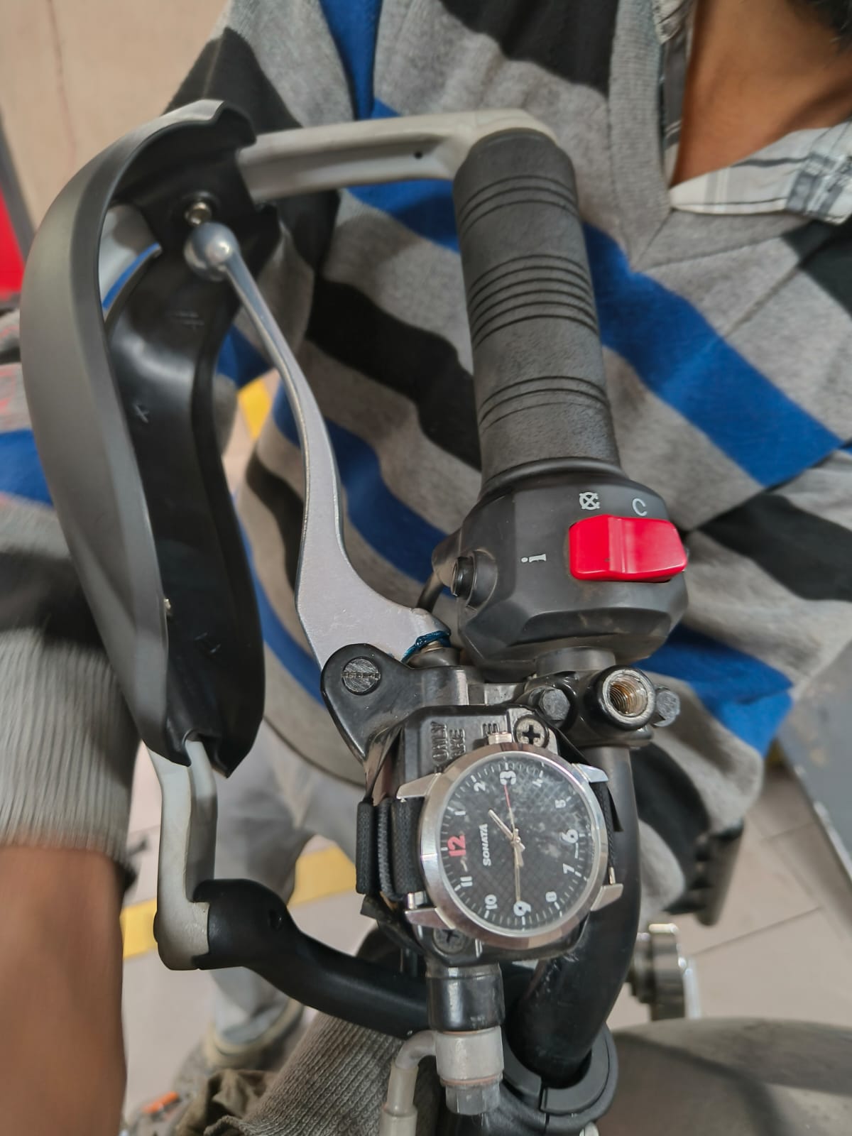

I also got the new and much improved RE hand guards installed as the movers and packers had smashed the cheap clones I used before. These are really very solid - however for the left side they had to use the clamp of my old hand guard, the RE one would not fit the 440. So some jugaad - but it looks OK.

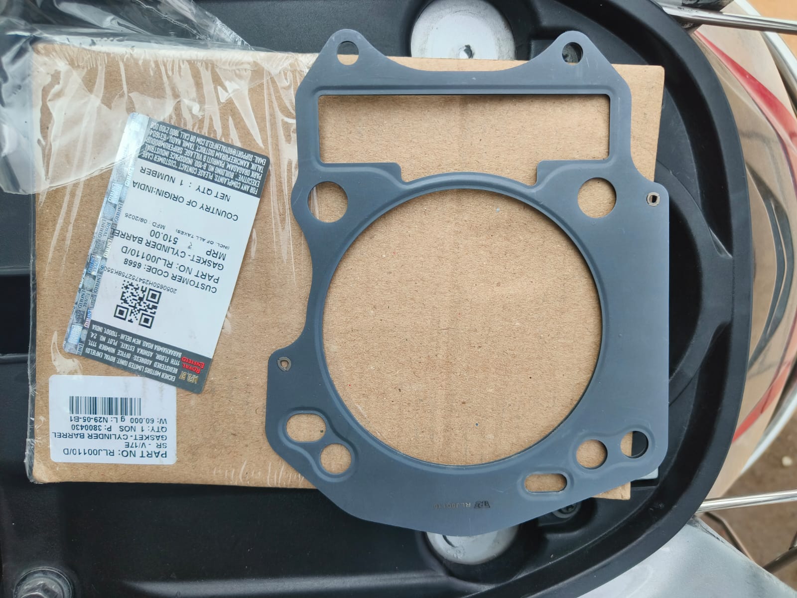

Just found out the base gasket for the 440 is now metal - and 3 times the price. The top gasket is still the same (bigger of course)

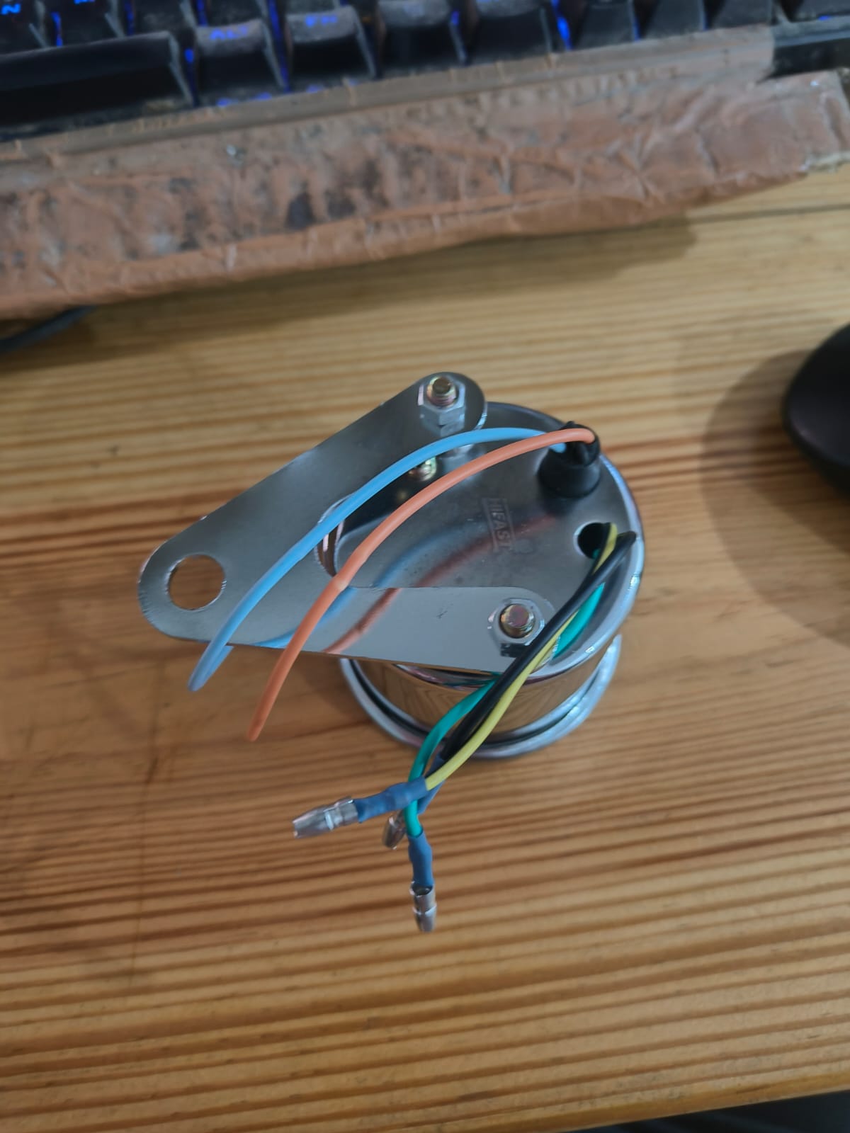

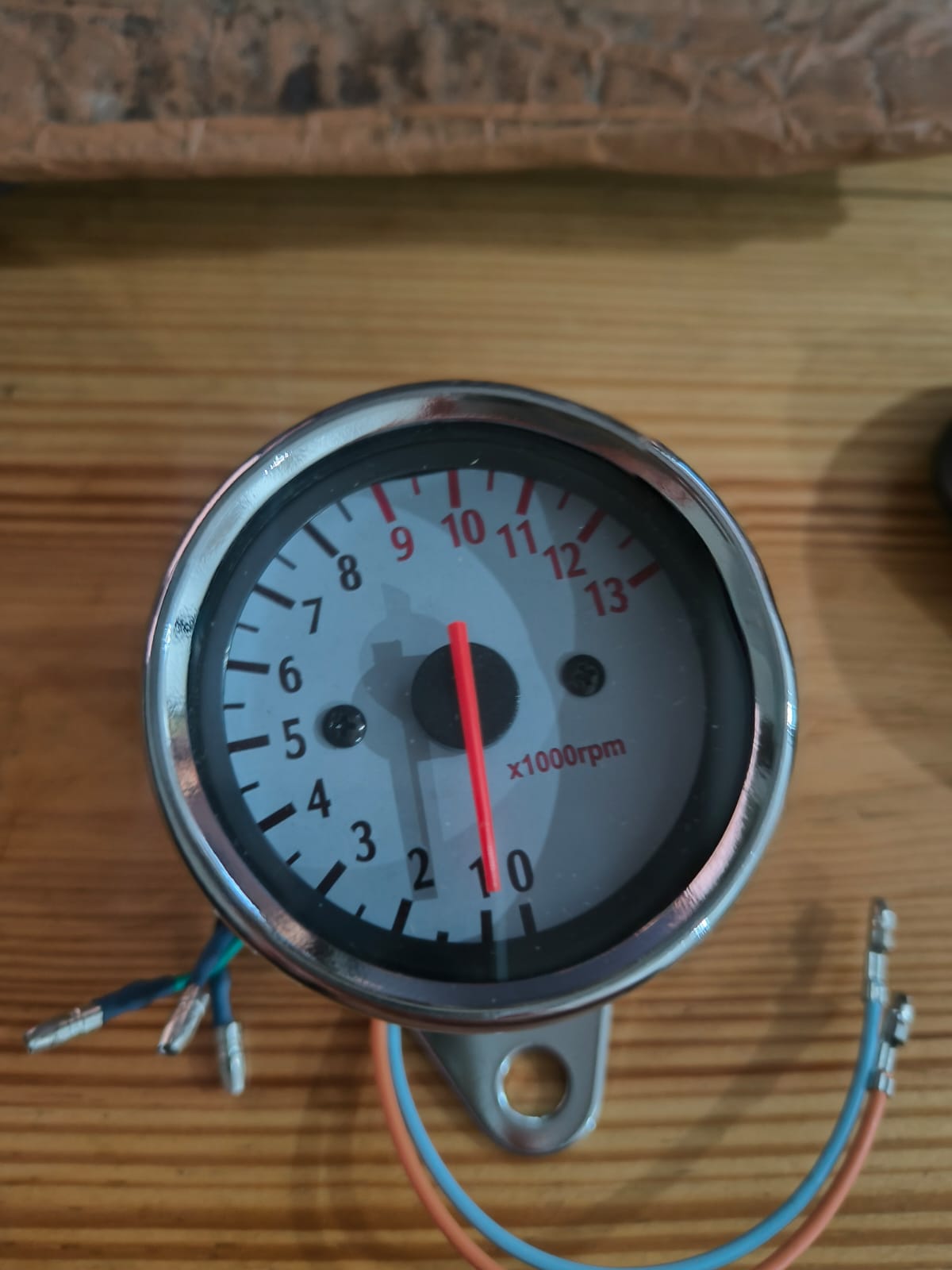

After 4 month (!!) my tachometer has arrived. Although it originates from China I had to order it thru the USA. I am curious if I can get it to work. Gemini AI has handed me a circuit diagram and instructions - but not sure if it hallucinated them or if they are real. soon we will know :alien::coffee::cool:
