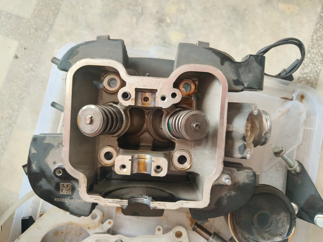

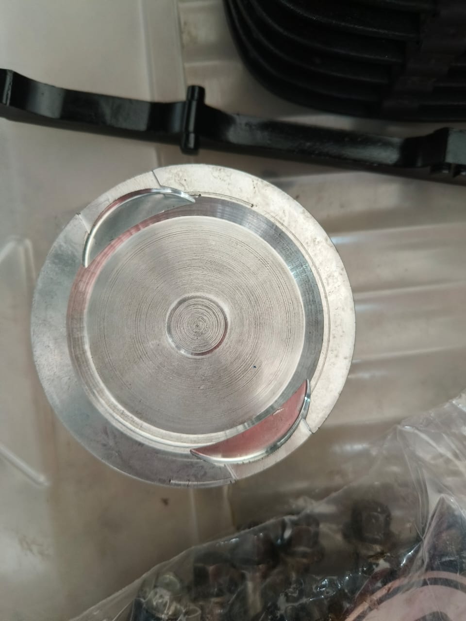

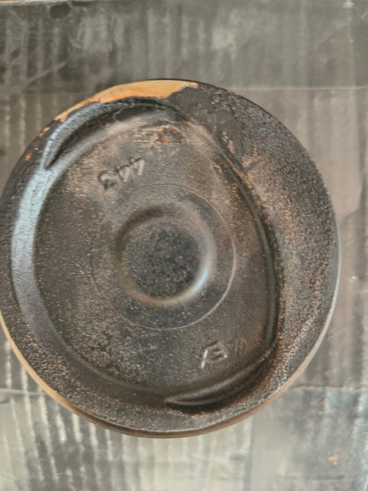

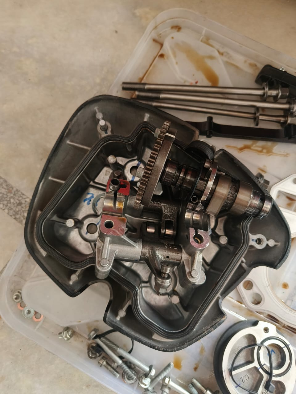

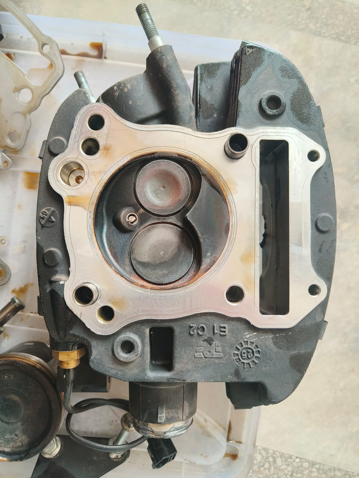

The 440 head is different and so is the piston, its not flat anymore. I am having a few mm shaved off the 86 to make it fit, bc its a forged piston it should take the load.

stuff looks different from Hima

according to you what are the major changes you have noticed so far in the head or in the entire assembly compared to 411?
The main question is, does it have bigger valves....
The combustion chamber design is interesting. It makes compression correction quite easy when too high

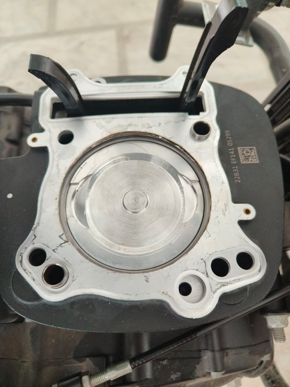

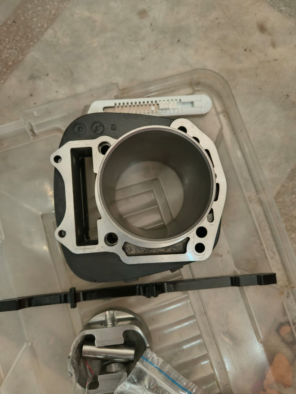

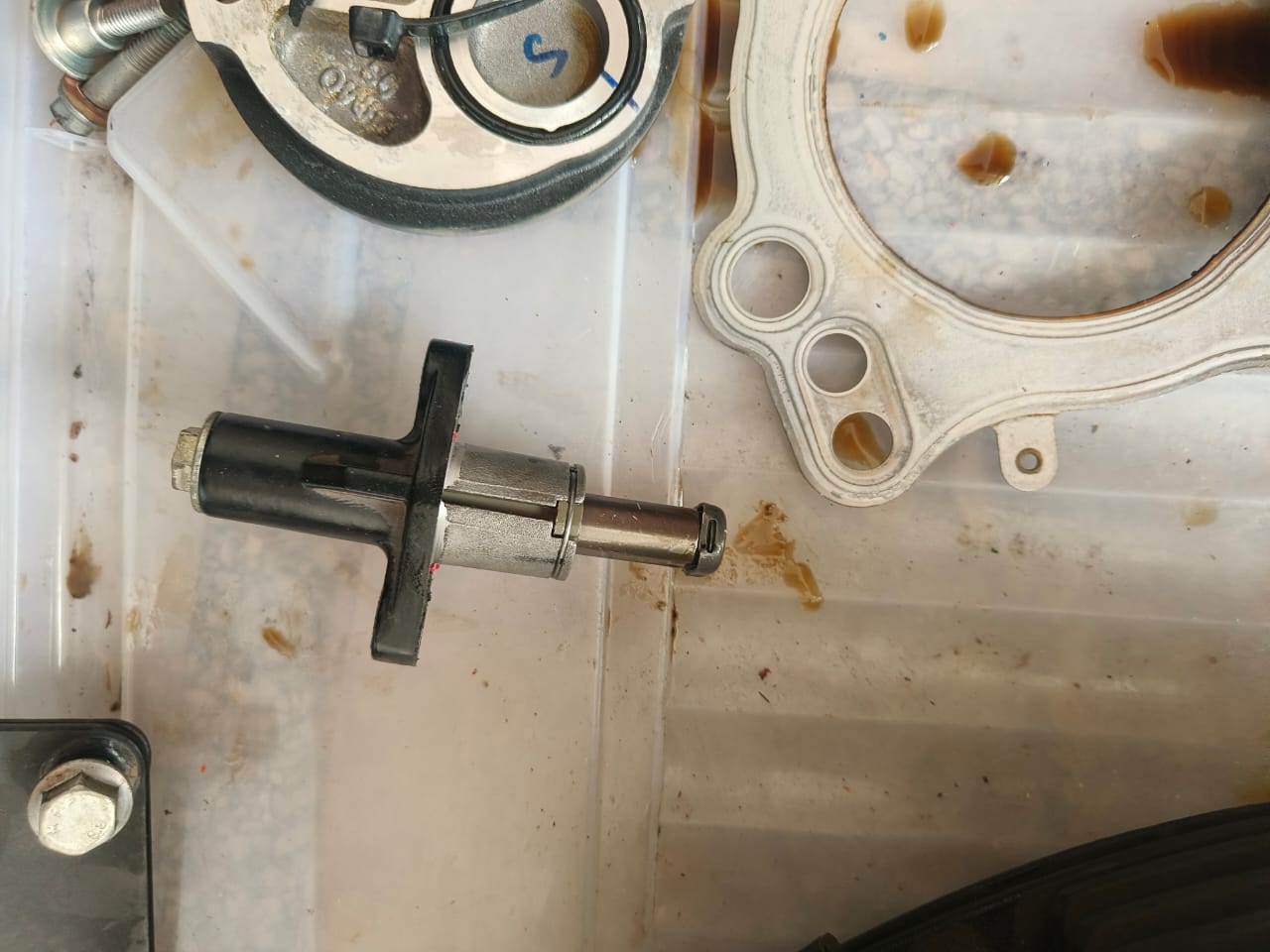

500cc installed, engine runs a little bit rougher which is to be expected. engine light is on and torque can not erase the fault code. AI tells me the codes on the 440 are not standard so I have to visit the shop to get it done. will do the test ride to determine if I need fuelx pro+ or not.
The engine body did not need any widening (compared to the Hima which does). We modified the piston to have the same indention depth as the original 440 piston. All should be well.

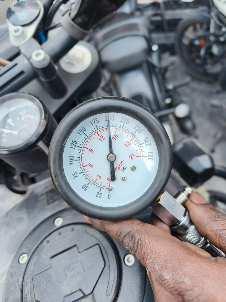

First impression (just 30km) - great punch, definitely a lot more than the native 440 and maybe just a bit short of the 500 carby I had.
I will go shanty for 500km, then let you know what the highway says. It will not be like the Guerrilla but I will still be able to go in 3rd or 4th gear everywhere and not break my foot on the gear switch lever. I have put the Guerrilla up for sale now - this bike is so much more fun to ride.
So far zero knocking, compression says 200 psi (cheap chinese gauge so plus minus 10) - and absolute smooth acceleration - so no fuelx either.

The AFR Gauge will be of value, sounds like good build but knowing the AFR will be helpful :)
200psi is getting into premium fuel territory.

so is the head different to 411 and if so will retrofitting 411 head on to 440 resolve the issue ?
the head is different. if you have a 411 and fit the 440 cylinder it will still work. I have a 440 - the reason I mod the head is only bc I take out some material so the volume gets bigger and the compression lower
