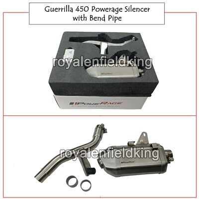

I dont know where the cat is located but I guess somewhere in the pipe. Need to find an alternative pipe then.
Called "Bend Pipe"
It goes between the Header pipe and the Muffler, saves weight also.

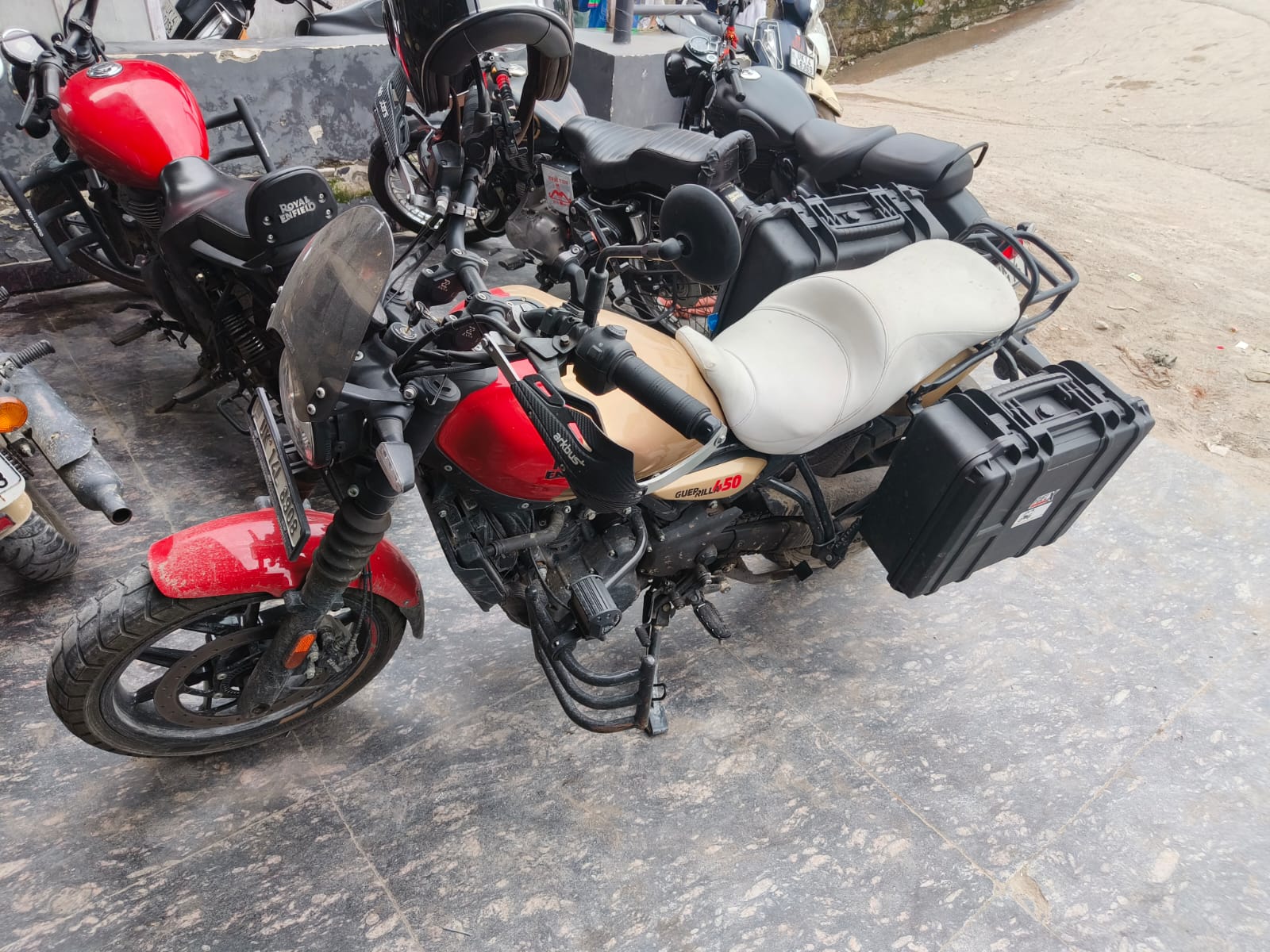

Got me a saddle seat made, mainly because on my last long trip the stock saddle did hurt after about 2h driving and I knew from the Himalayan that the saddle shape allows for very long sitting without discomfort (did 9h in one go once).
Of course nobody offers these seats ready made so I had to take the stock, rip off the foam and cover and also sacrificed a Himalayan seat just for the foam, then had my seat guy adapt the foam to the Guerrilla base plate.
Why white? because in summer the black seats burn your ass off if you do not park in the shade, and nobody else has a white seat so I can identify my bike easily and from far away in a parking lot. It also looks cool I think.
Deepak who had borrowed the bike for an extended trip with his GF was delighted, He also previously had complaints about the stock version, so I am hopeful my next long trip will be quite pleasurable - seat wise at least.
