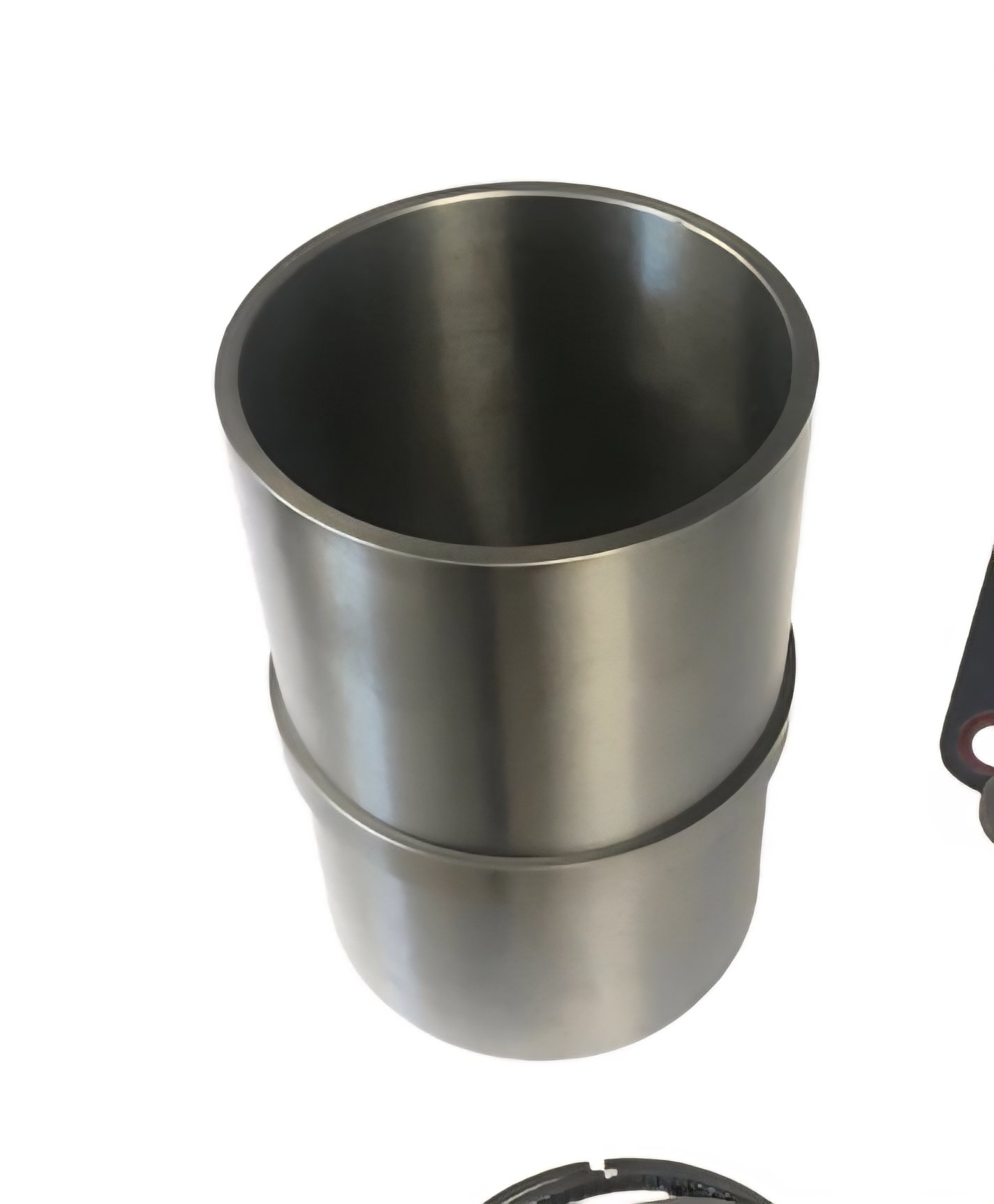

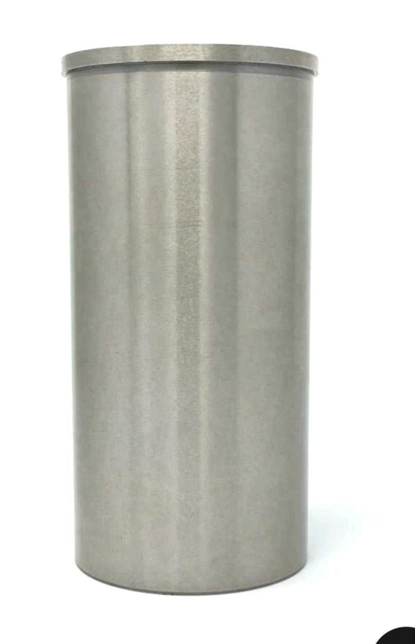

Look at this pic of a liner and see if it becomes clearer.
This is a longer liner ( than what HT uses but "you get the picture" like what
is that thing at the top?)
This is where I get to the point ;) (well almost!)
The " thing at the top" is what secures the liner as its bigger than the head so it can't go up and the way the Barrel is bored to accommodate this ridge, it can't go down( unless the barrel is not bored correctly!)
Now look at the first pic and think what stops the liner from going up?
Ill tell you, the Barrel.
Obviously not the Head:)
Now, what stops it going downwards?
The crankcase opening you may think.
So presumably the case opening is almost the same size as the OD of the liner and the "ridge" can not go down as a result because it is bigger.
WRONG:oops:
It is not that tight and was not designed to secure the liner.

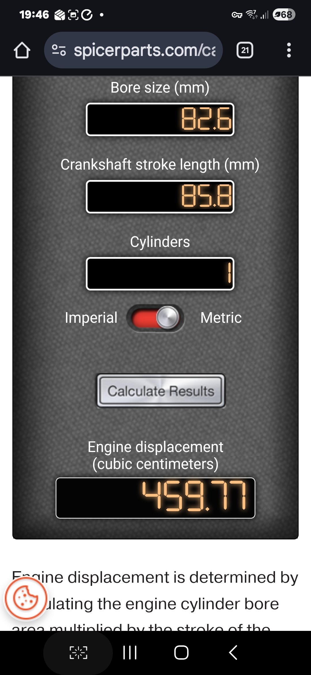

Well I don't have a LS410 (Real Himalayan), but I do have a J series with a Stroke of 85.8mm, so what is my Next Build?
You Guessed it, a 460 Bullet😁
It will be interesting to see if the stock ECU can still manage that. my guess is no (not based on anything, just a wild guess)

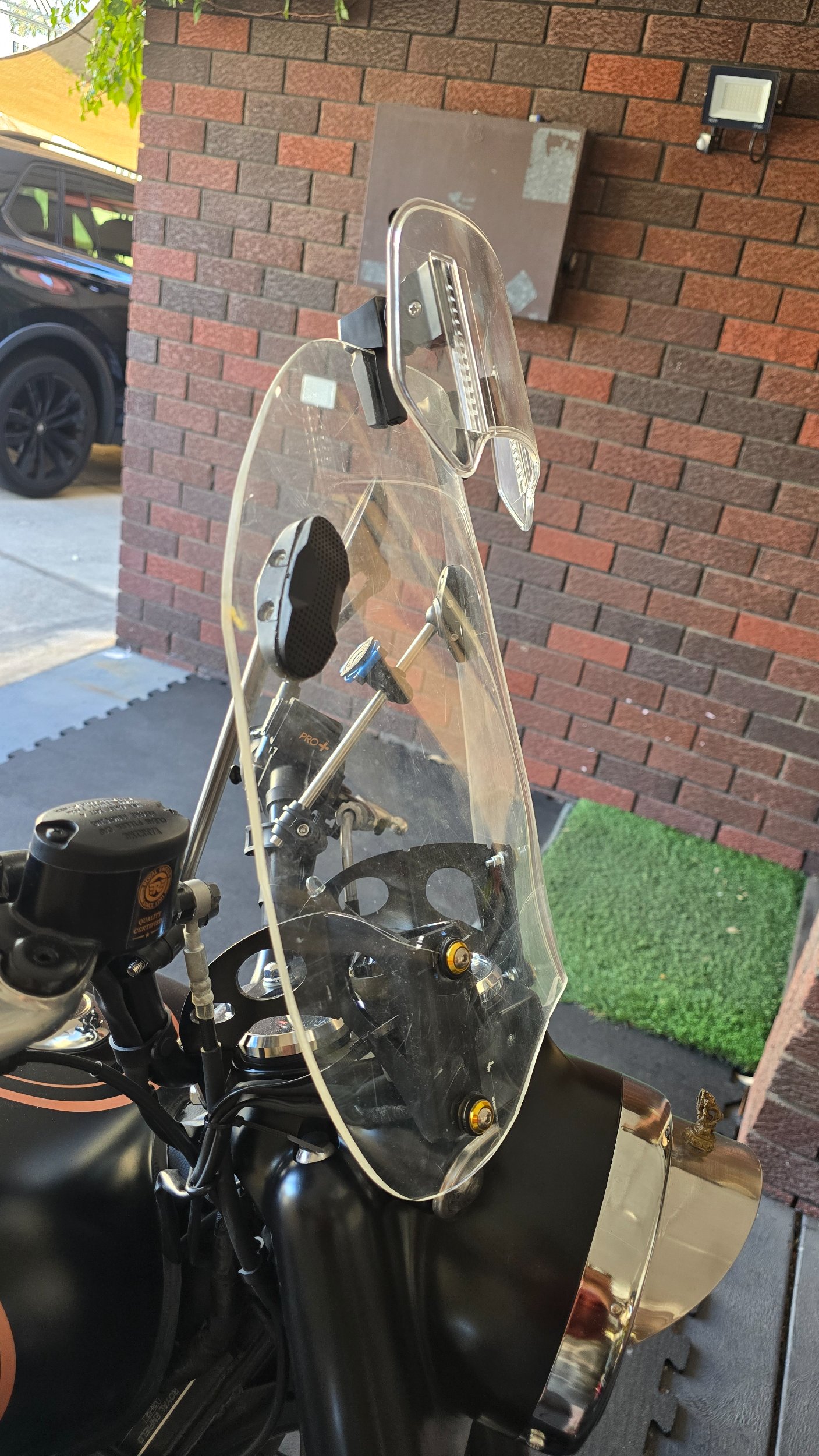

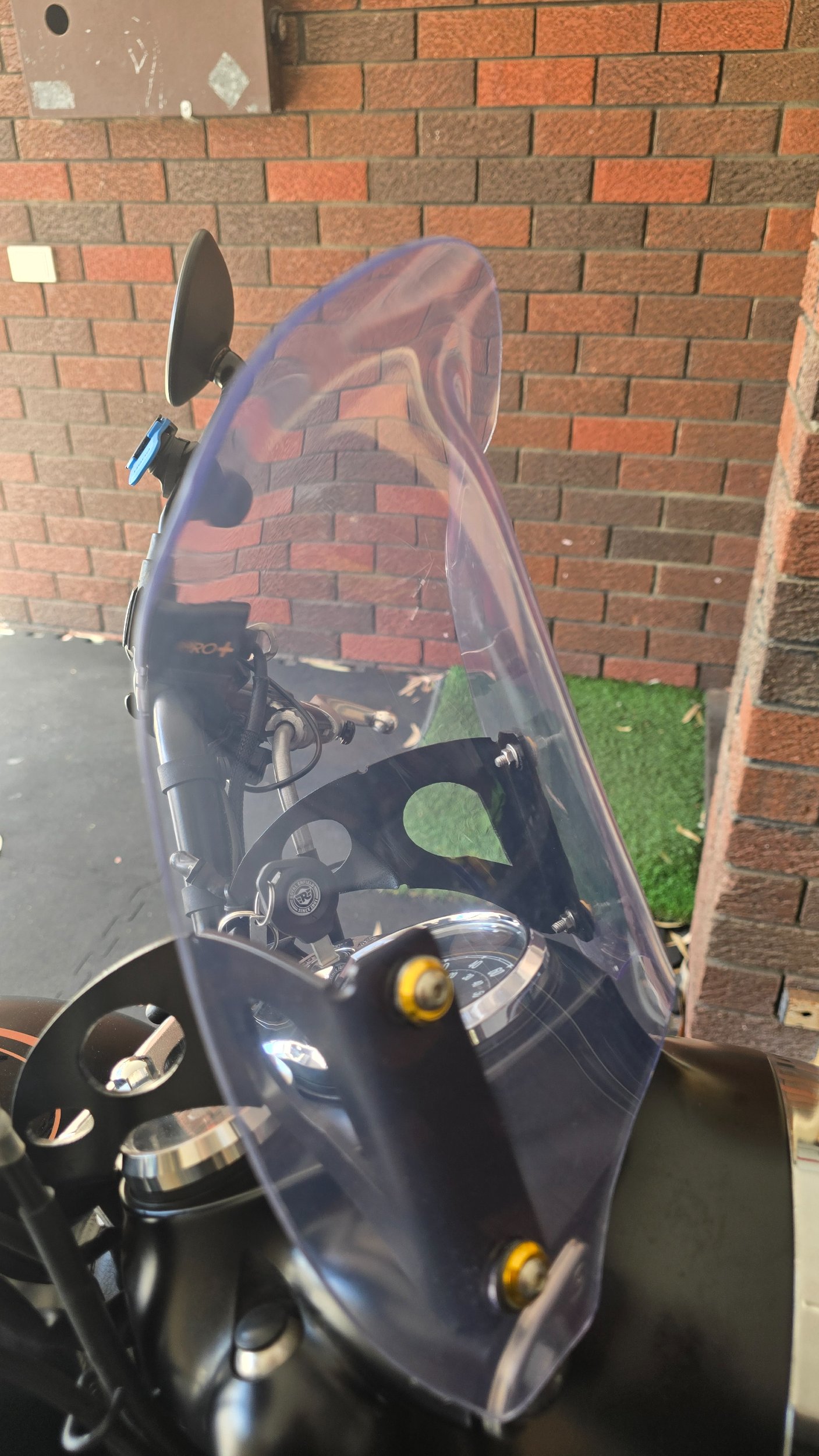

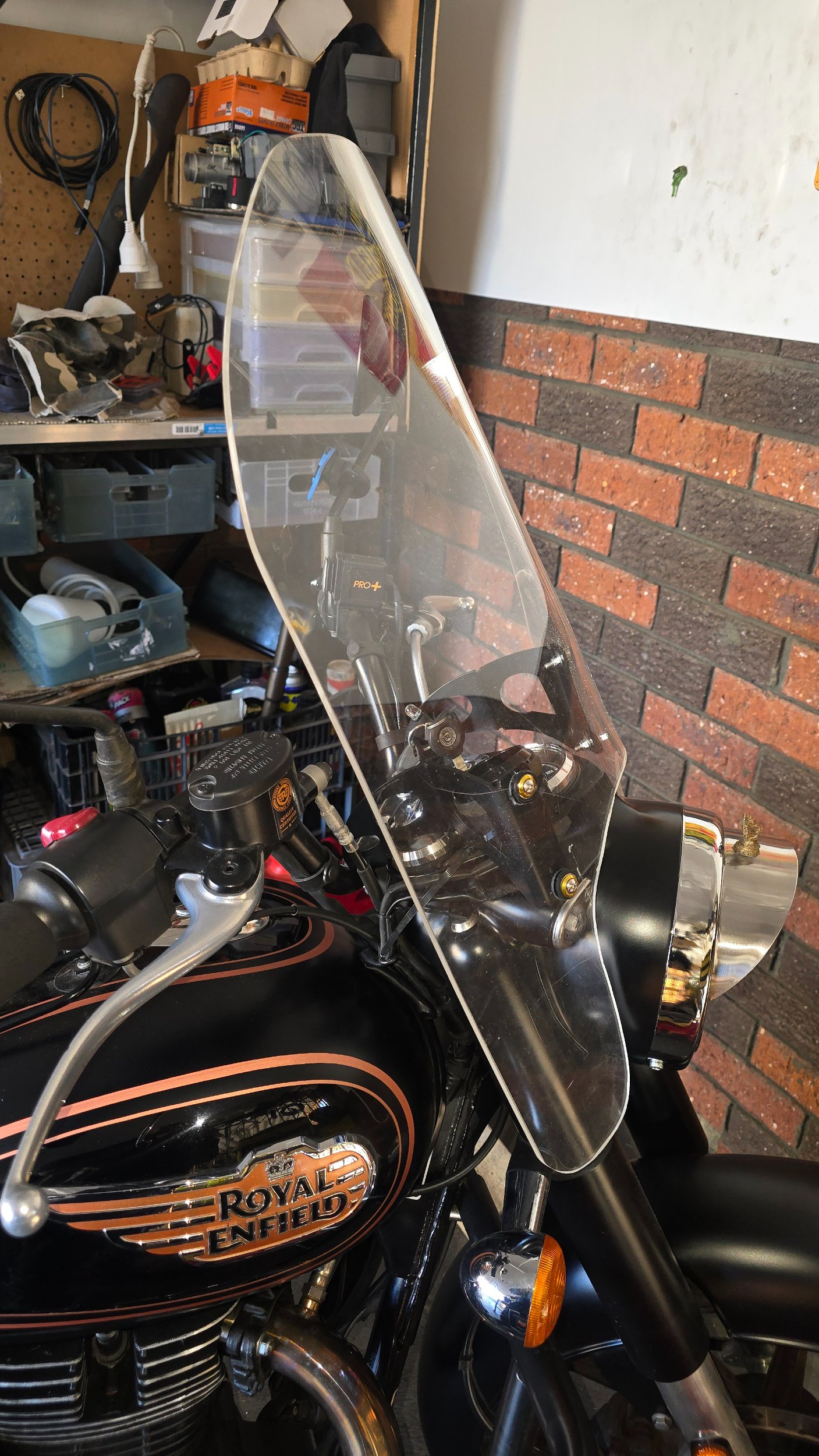

20260302_172037.jpgthis is where I am at with a Screen, not finished as it could do with some braces coming off the Handlebars a job for tomorrow. It is 4.5mm thick Perspex/Acrylic.
This was the shortest version made from 3mm Perspex, it kept the wind off the upper body but not the helmet.
Bit higher but the noise of the wind hitting the helmet was too much of a distraction.
First test of the tall screen only to 100kph, the extra load on the bike is noticeable and so is the noise, its a "trade off" :cool:

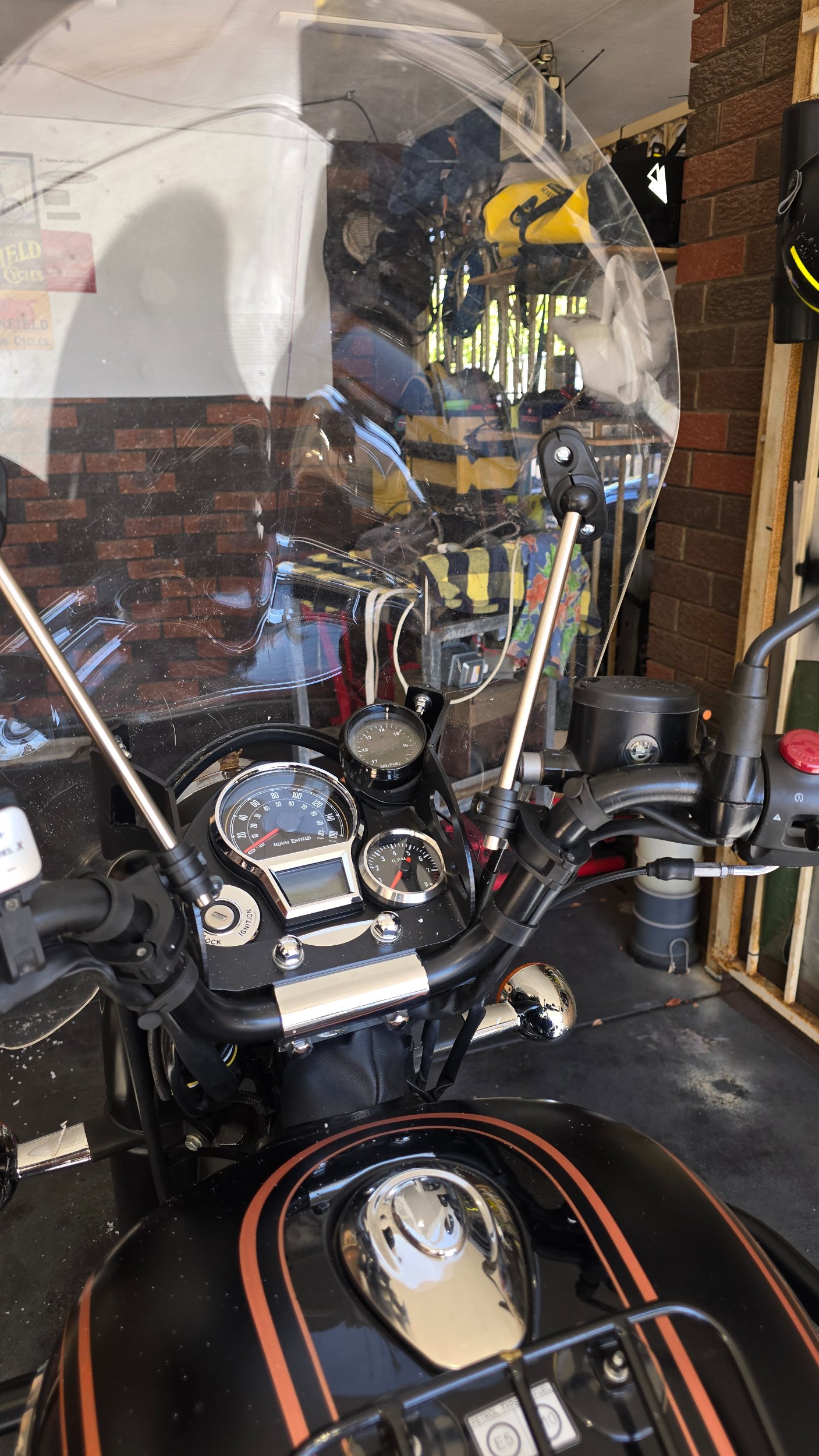

Solid as a rock! Makes the ride different, engine noise can be heard ;)
Never quite finished!

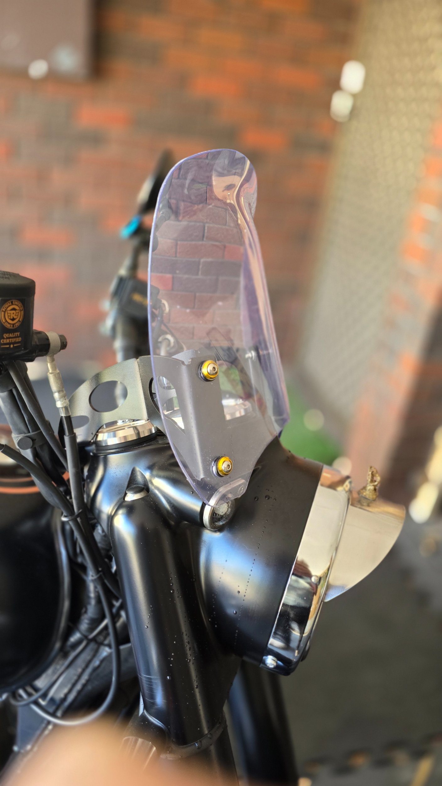

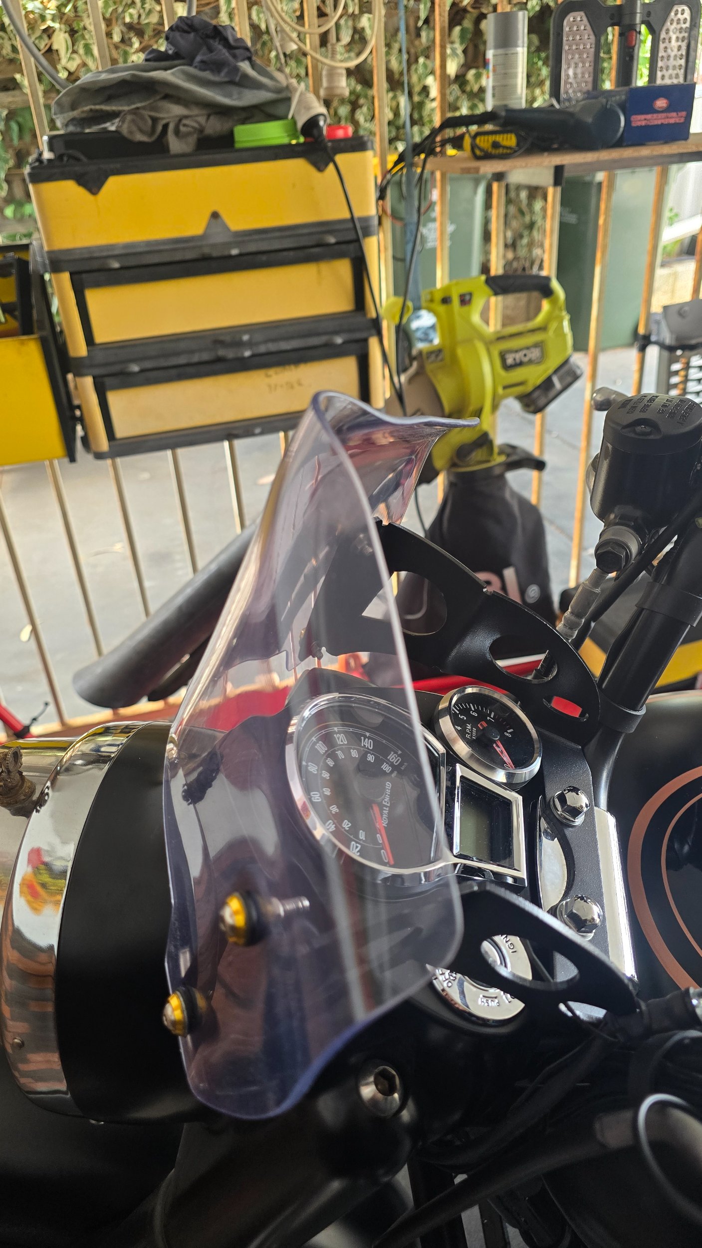

So i got this little screen topper from aliexpress, cut down the screen in height about 45mm and lopped off the lower section.
Now I can have the height I had determined to be about right and the option of going a bit higher if required.
Test at 100kph indicates a significant drop in helmet noise so I am confident.
Not that I like the look of tall screens but wanting to be able sustain cruising for a few hours at a time it is this or Cafe style and I'm too old for that!
Noticeable is the extra weight on the front wheel, air hitting the screen and creating downforce as opposed to hitting me and being transmitted by my butt to the rear wheel so I have added extra psi to the front tyre;)

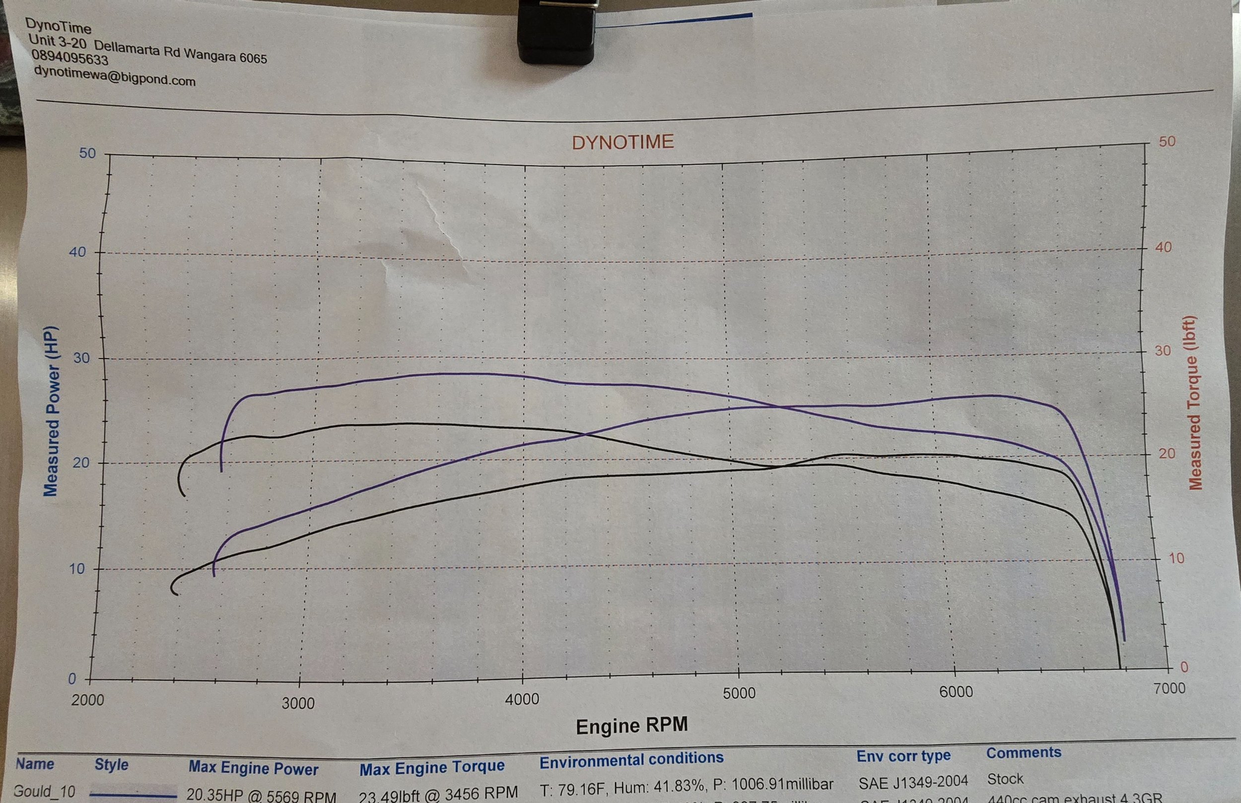

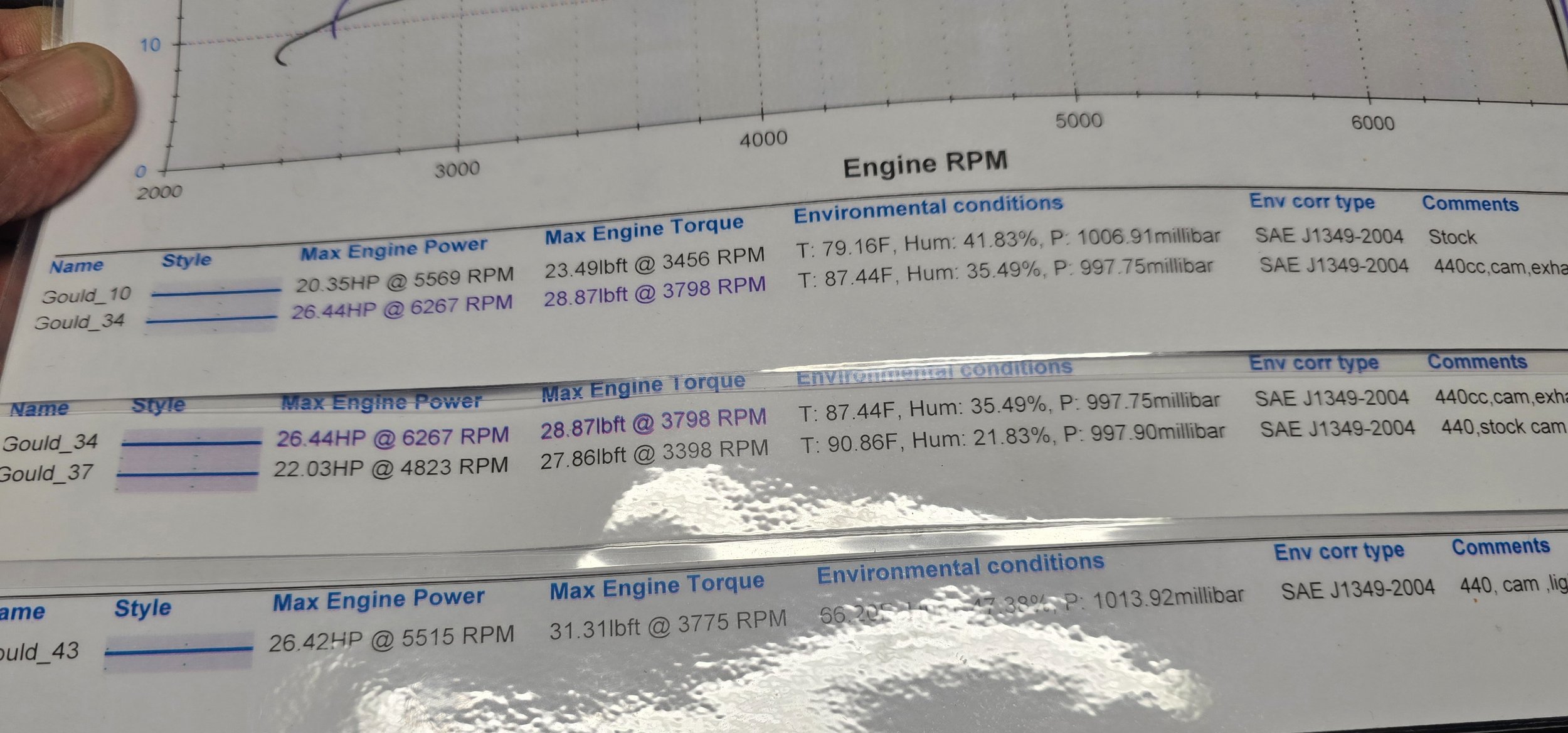

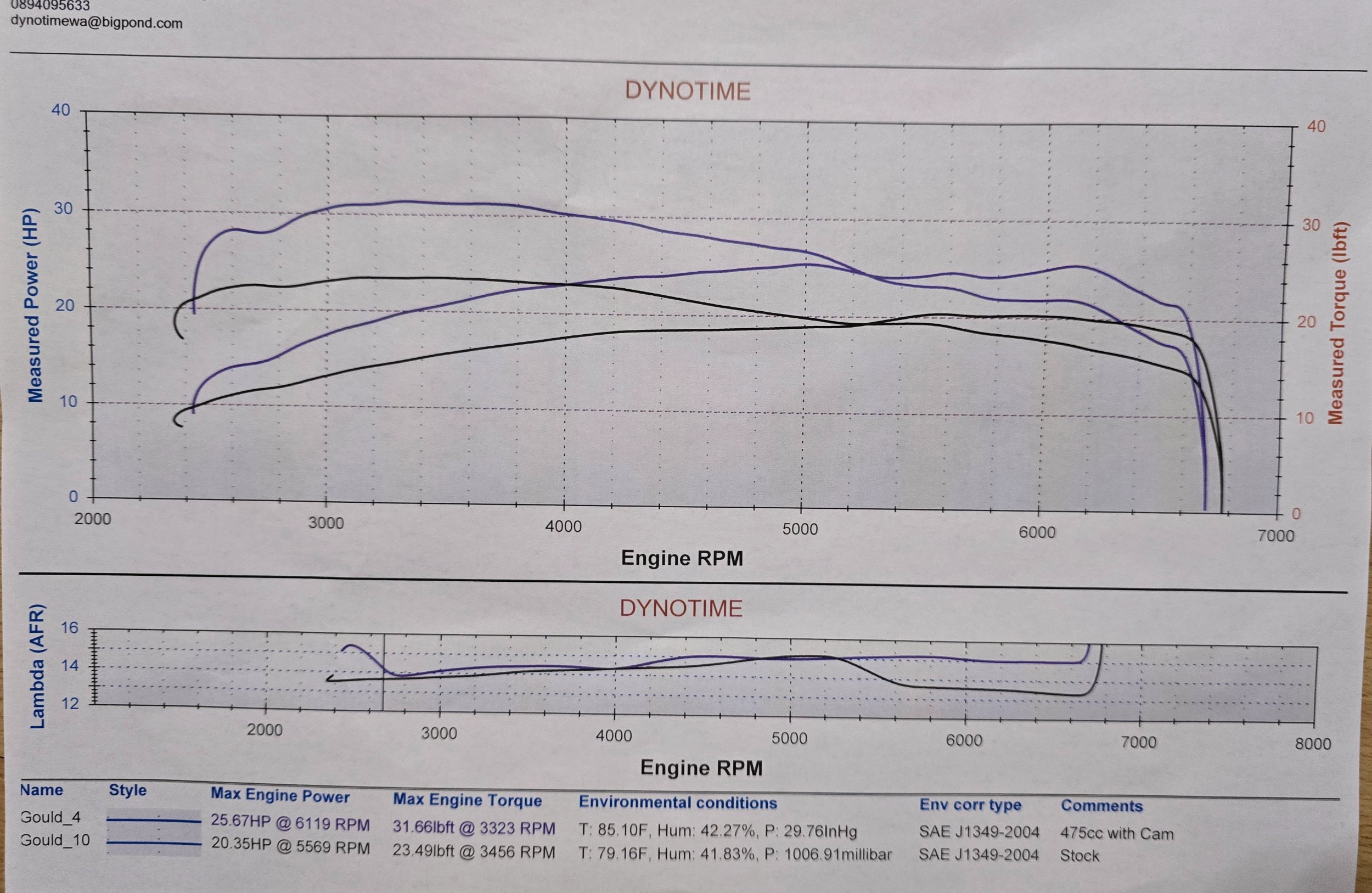

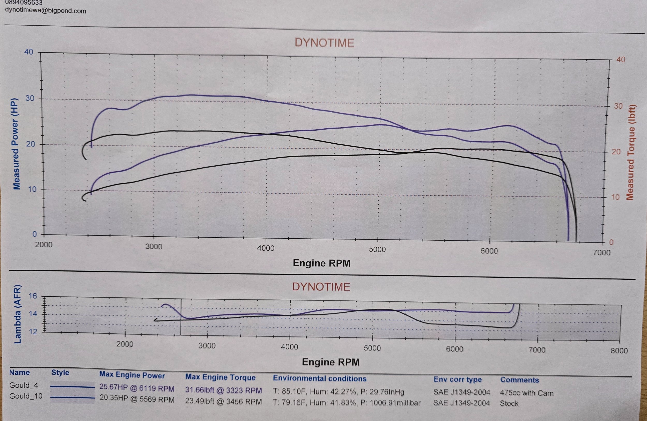

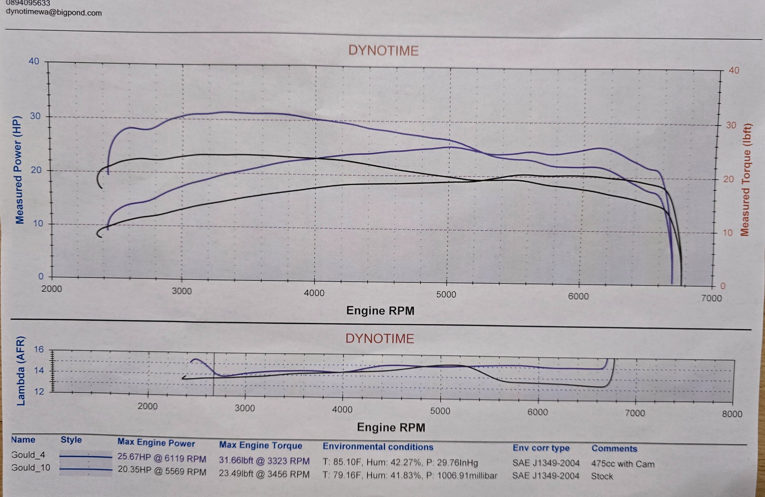

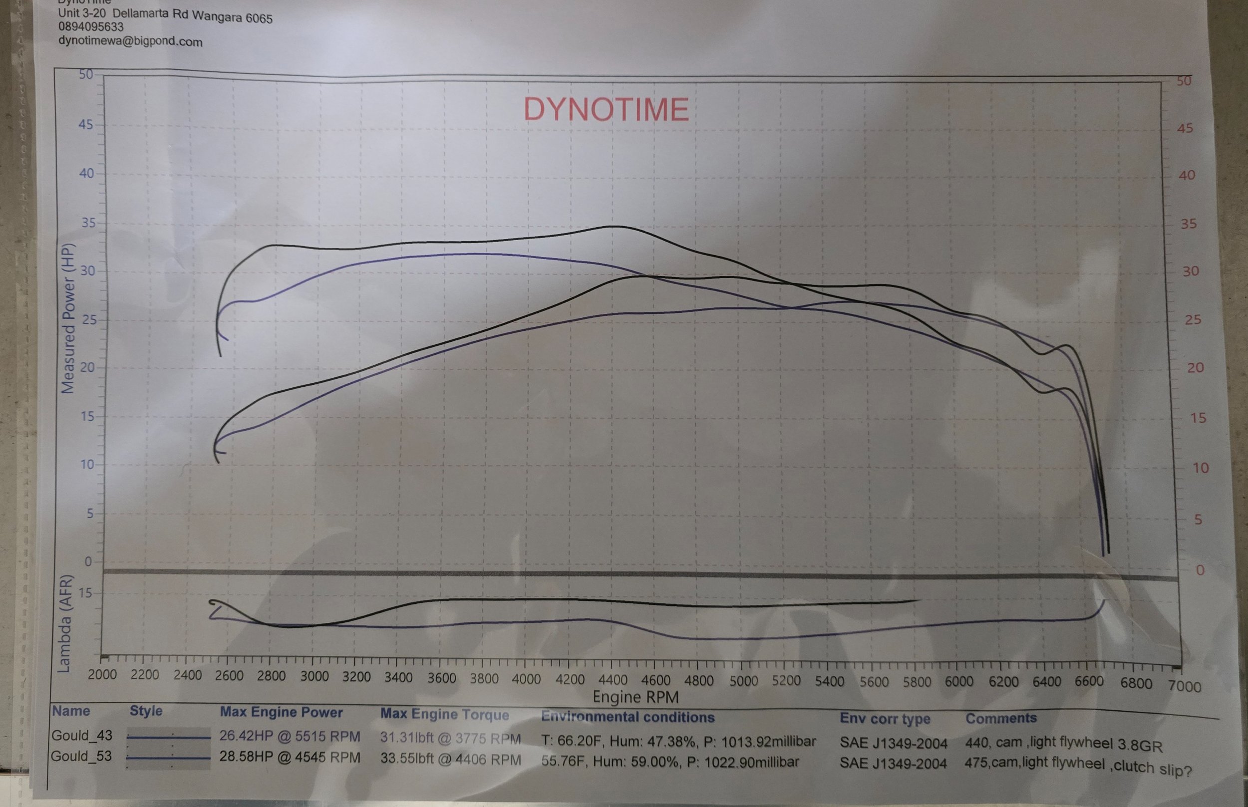

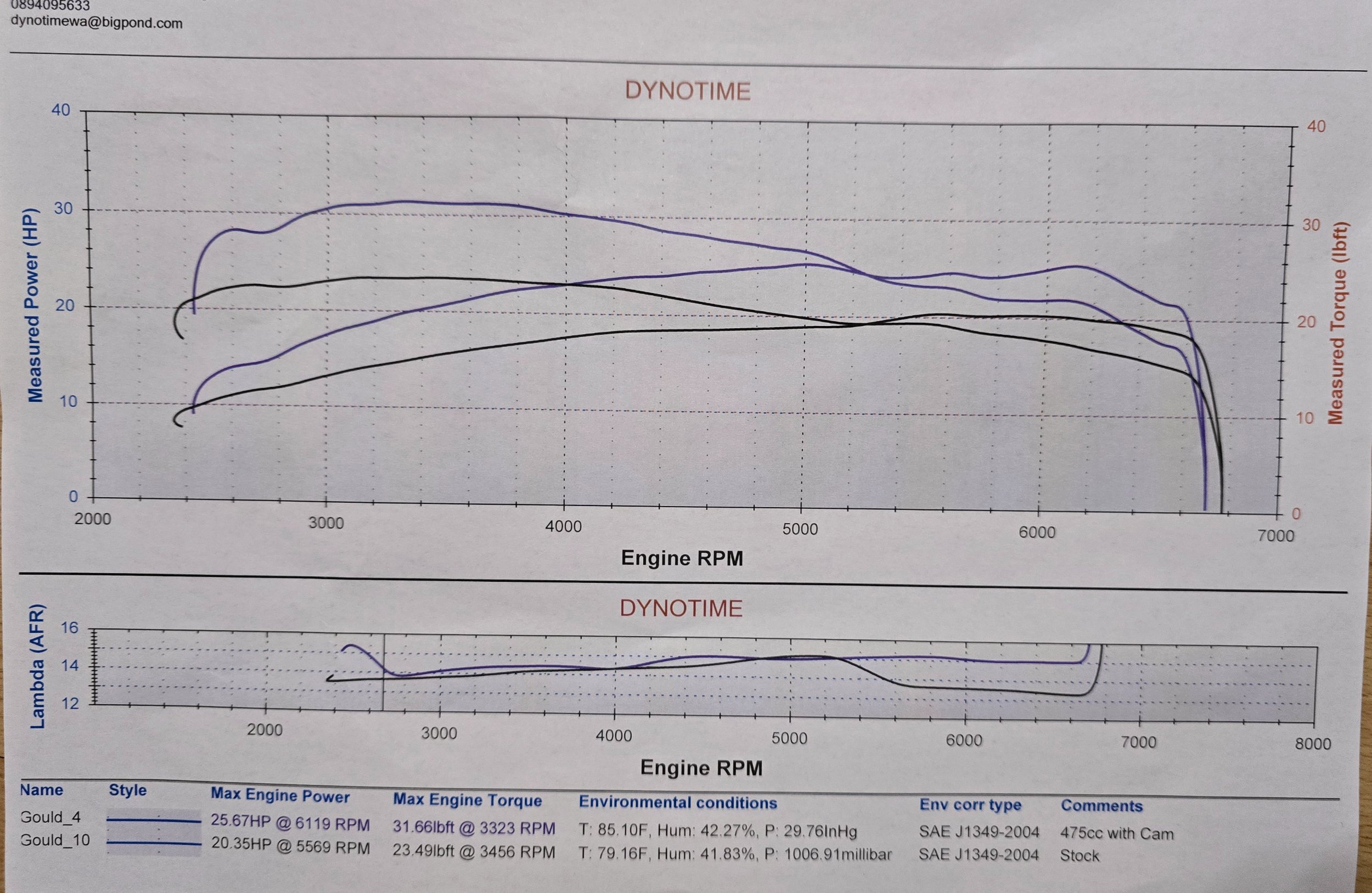

Results from Dyno tests showing improvements with 440cc over stock with the latest being ,440cc + Cam + lightened flywheel.
33.5% more Torque and 29.5% more HP.
What next?
