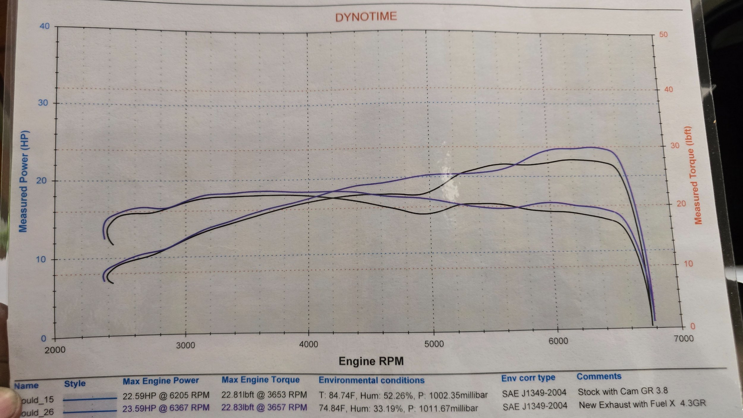

Base line today!
It will, hopefully, be way South of the 25.6RWHP recorded last week :unsure:

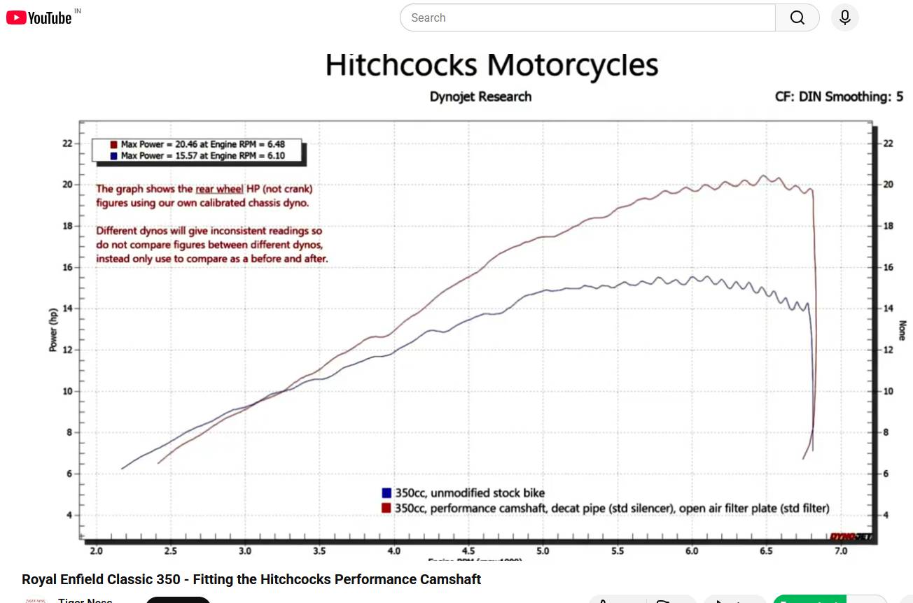

What appears to be a 5.3 increase in RWHP at peak.
Unimpressive if we believe Hitch who claims more with just the cam. As you are using the same cam I wonder what has happened here.
btw: took the pic from this "how to install the cam" video
Look at the difference at 4500rpm compare that Hitchcocks.
That is roughly a 25% increase in horsepower and a 35% increase in torque.
Torque is what is transmitted to the Butt, certainly a different beast to stock.
How much more can be gained is yet to be answered.
AFR readings are interesting, stock it went rich at high RPM under WOT and tuned with fx and pt4 went lean!
For me to watch? Surely not!
Hitchcock's may be lying! ;)
Reading these charts can be challenging but the thing to look for is the difference between the lines, this chart shows a 33% increase in torque, unfortunately the Hitchcock's chart doesn't show torque and they "add" to the scales with a decat pipe and free flow cover.
Not exactly Apples vs Apples.
8HP increase at 3500rpm compared to less than 1.5HP on the Hitchcock's chart! :cool:

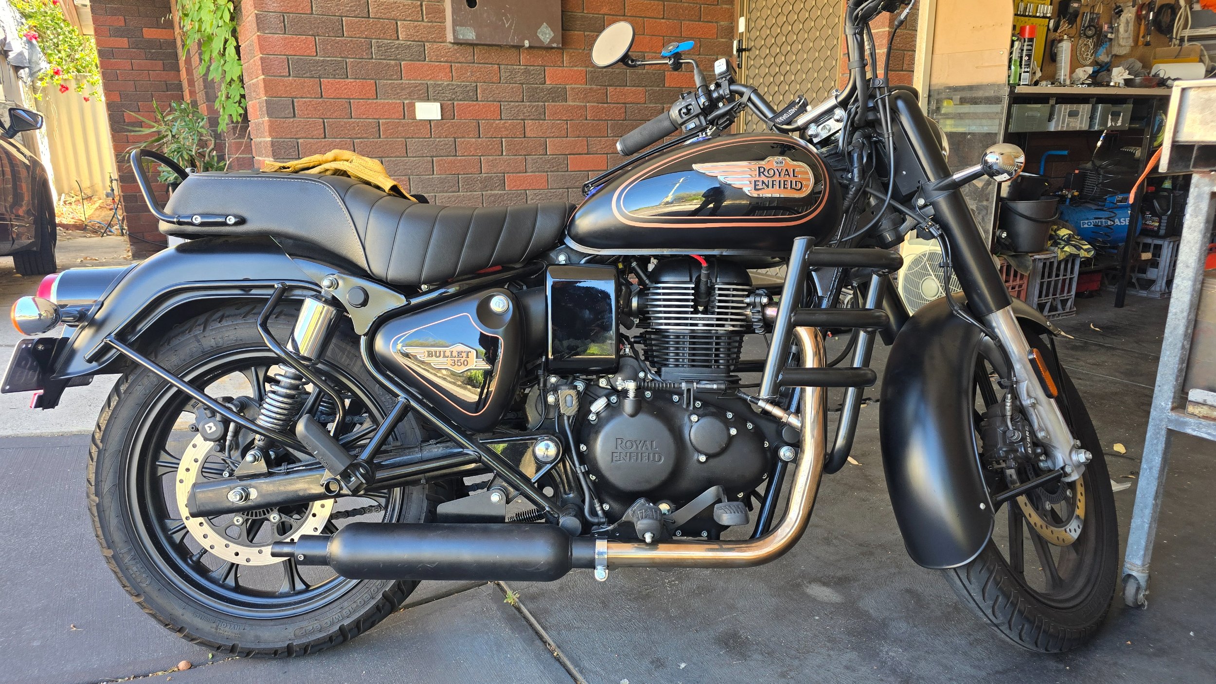

I have had 3 Delkovic Header pipes and Butchered all of them.
This is the latest victim.
The Himalayan Header had a reduction at the end to take a stock Muffler ( why anyone would buy a Header pipe and fit a stock Muffler is beyond me)
The only Header available to me here was one that was sold as a complete system for the Meteor and for some reason went from 45 OD to 51OD at the end and used a 2inch or 51mm Muffler.

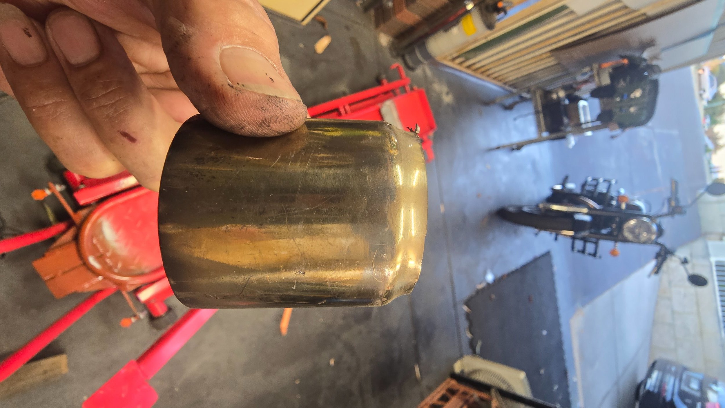

Well it did!
This time I found a use for the "offcut".

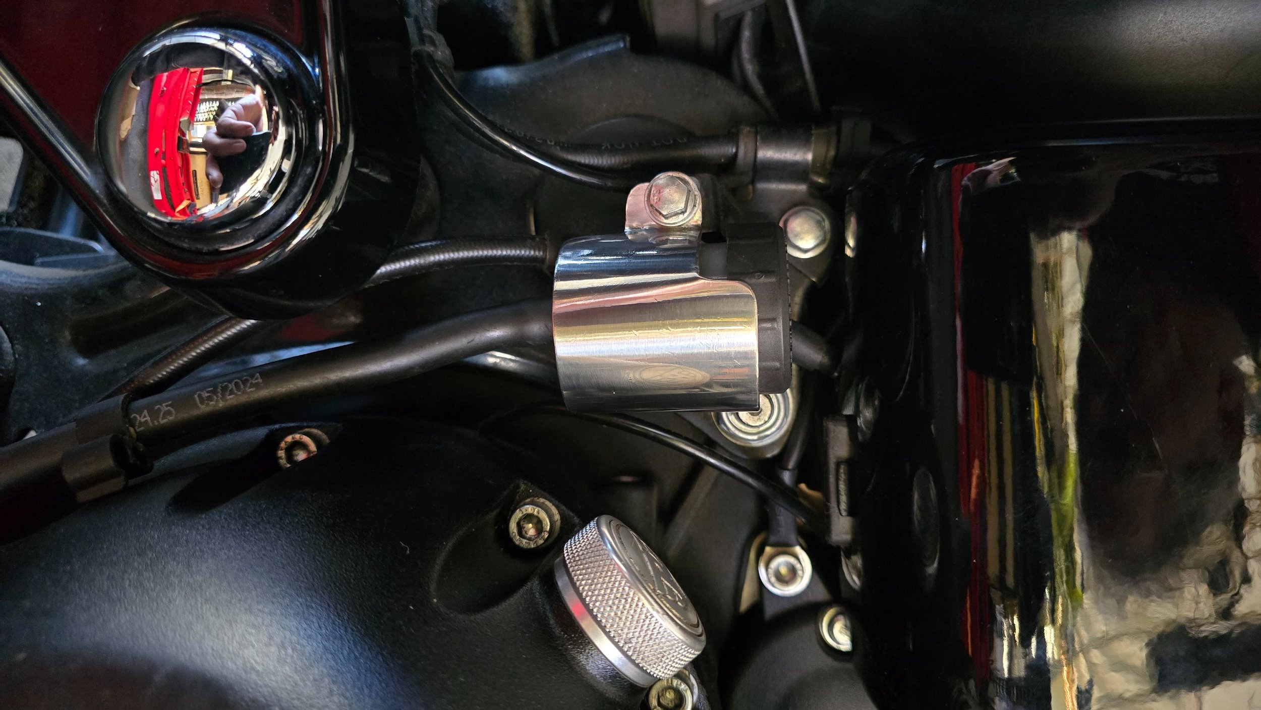

I made a bespoke Stainless Steel Brake Master Cylinder Reservoir Cover .
Looks even better the right way up :cool:

Delkevic Header( for Meteor!)
45mm "Hot Dog Muffler" (from a car exhaust shop)

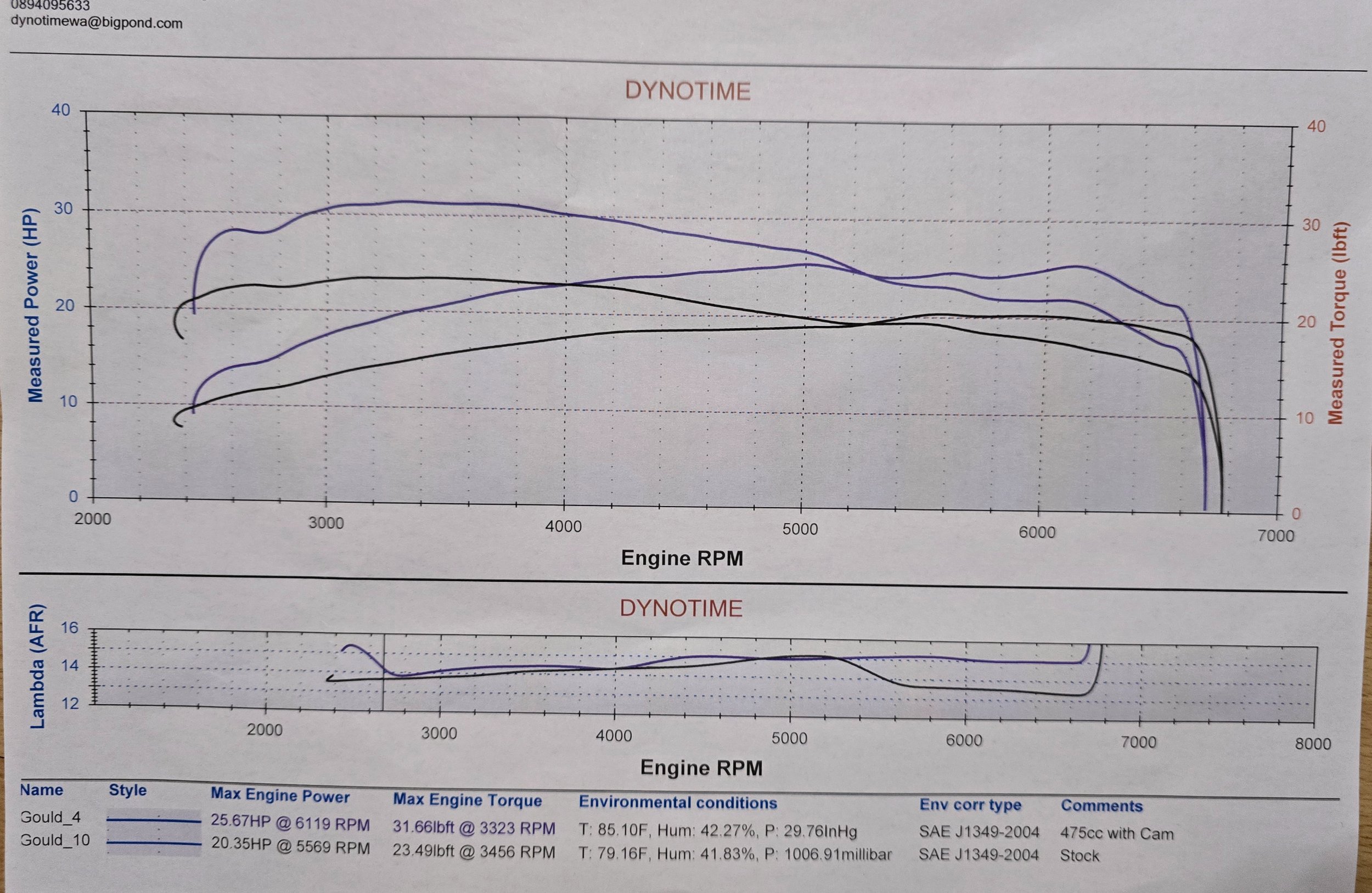

Stock 350 made 20.35RWHP and 23.49ft pounds torque
I will be happy with 13% and not too disappointed if it is less as I was going to change it anyway :ROFLMAO: :ROFLMAO:.
How many times can I reuse the Head bolts is a part of this quest.:unsure:
16% HP increase with more power after 5000rpm than stock.

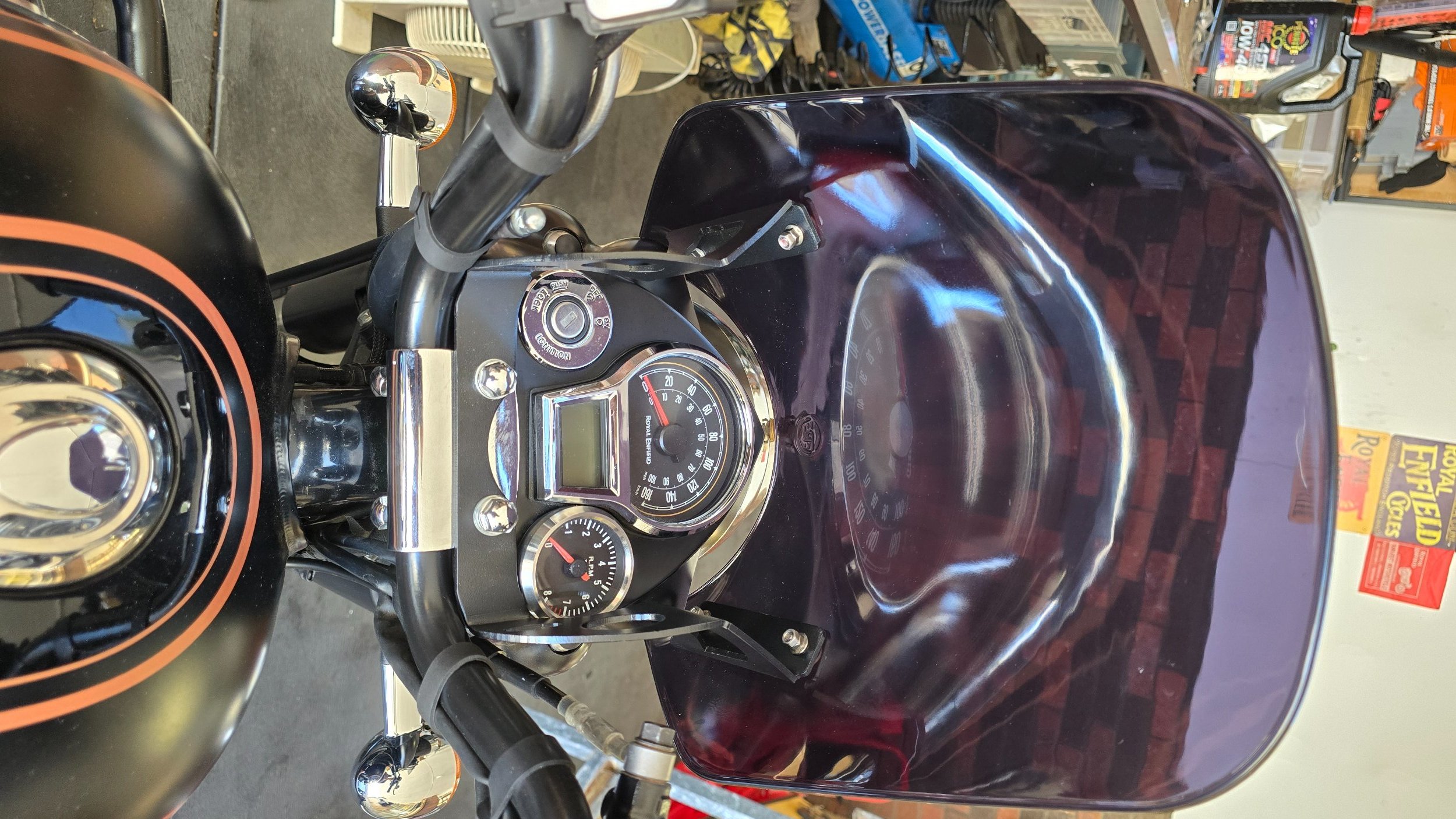

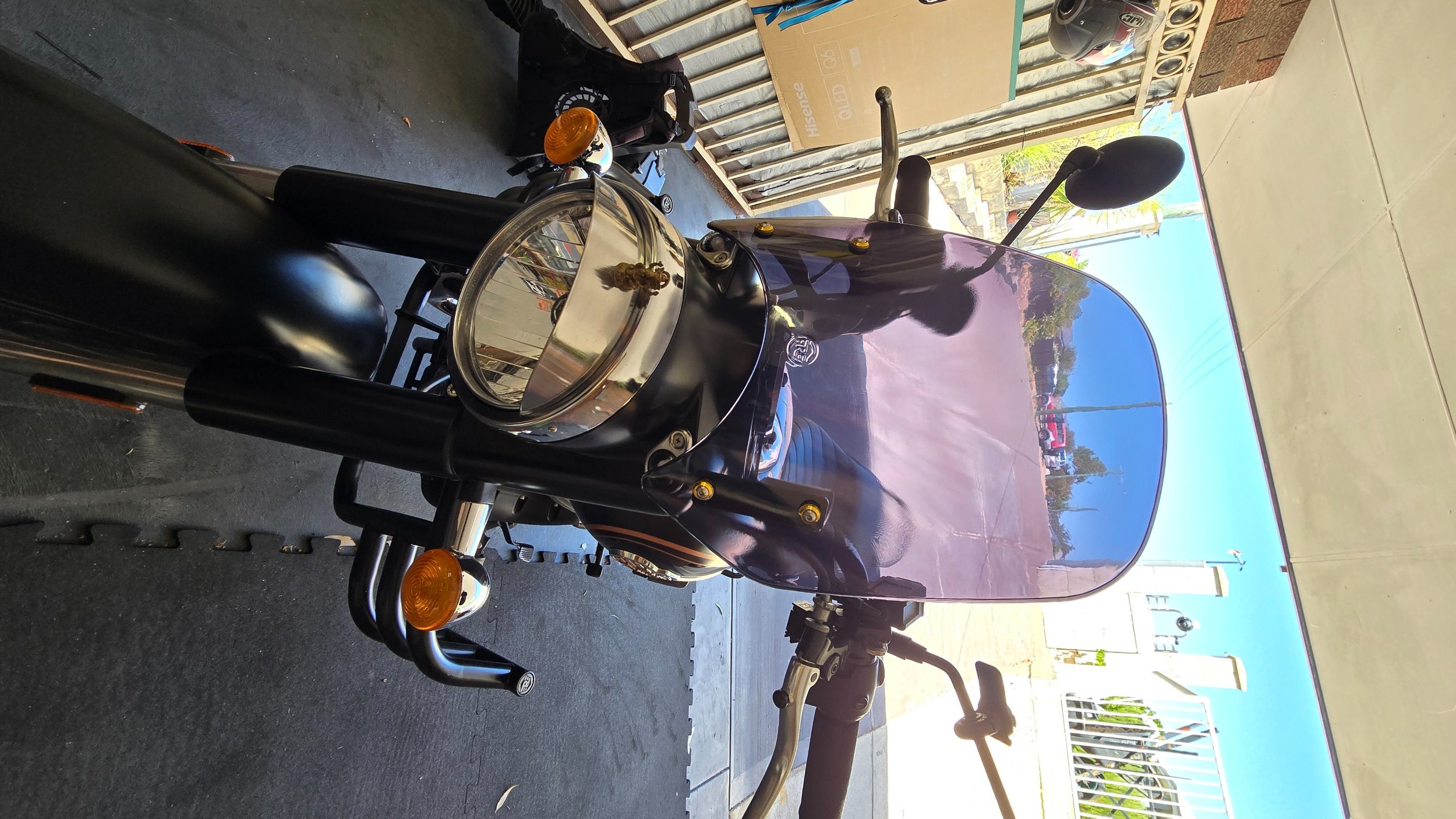

With all this extra power I need wind protection ;)

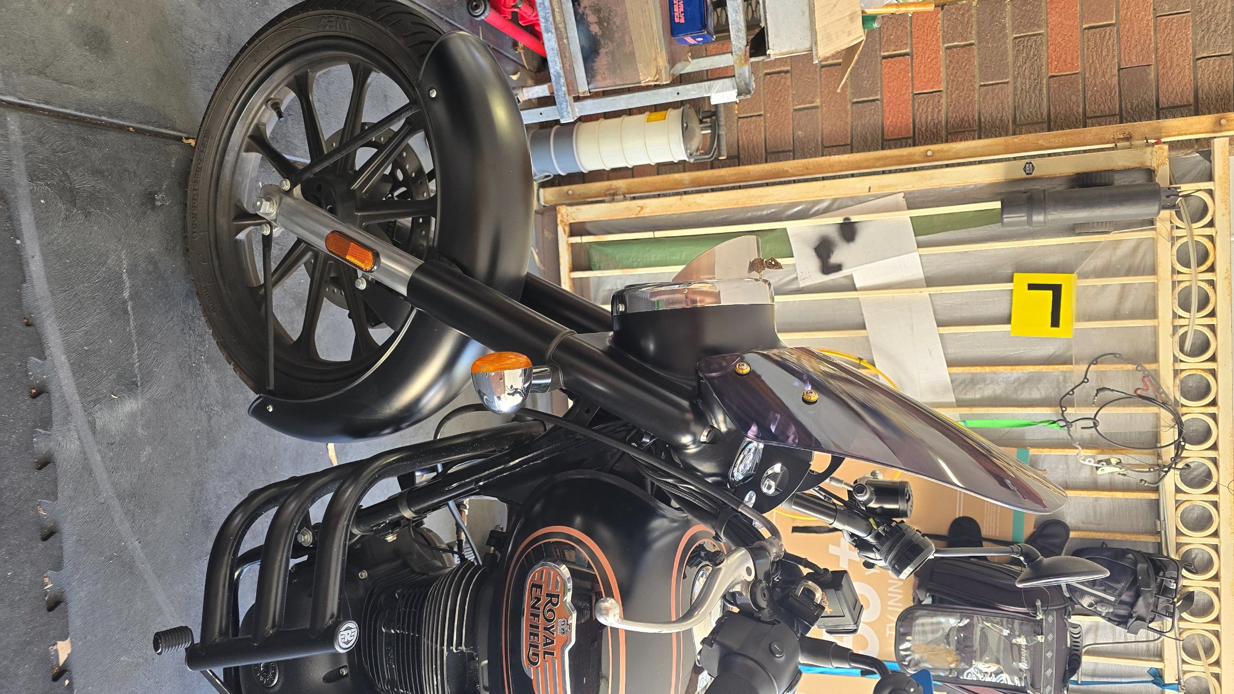

So got this from AE spares in India.
Results so far, the wind at 100+kph is no longer putting a strain on my arms but the noise generated requires earplugs,
I do not feel the buffeting on my Helmet but I certainly hear it.
So I have ordered a small clip on screen to attach to the top hoping I can deflect the wind.
If that is not successful I will try shortening the screen.

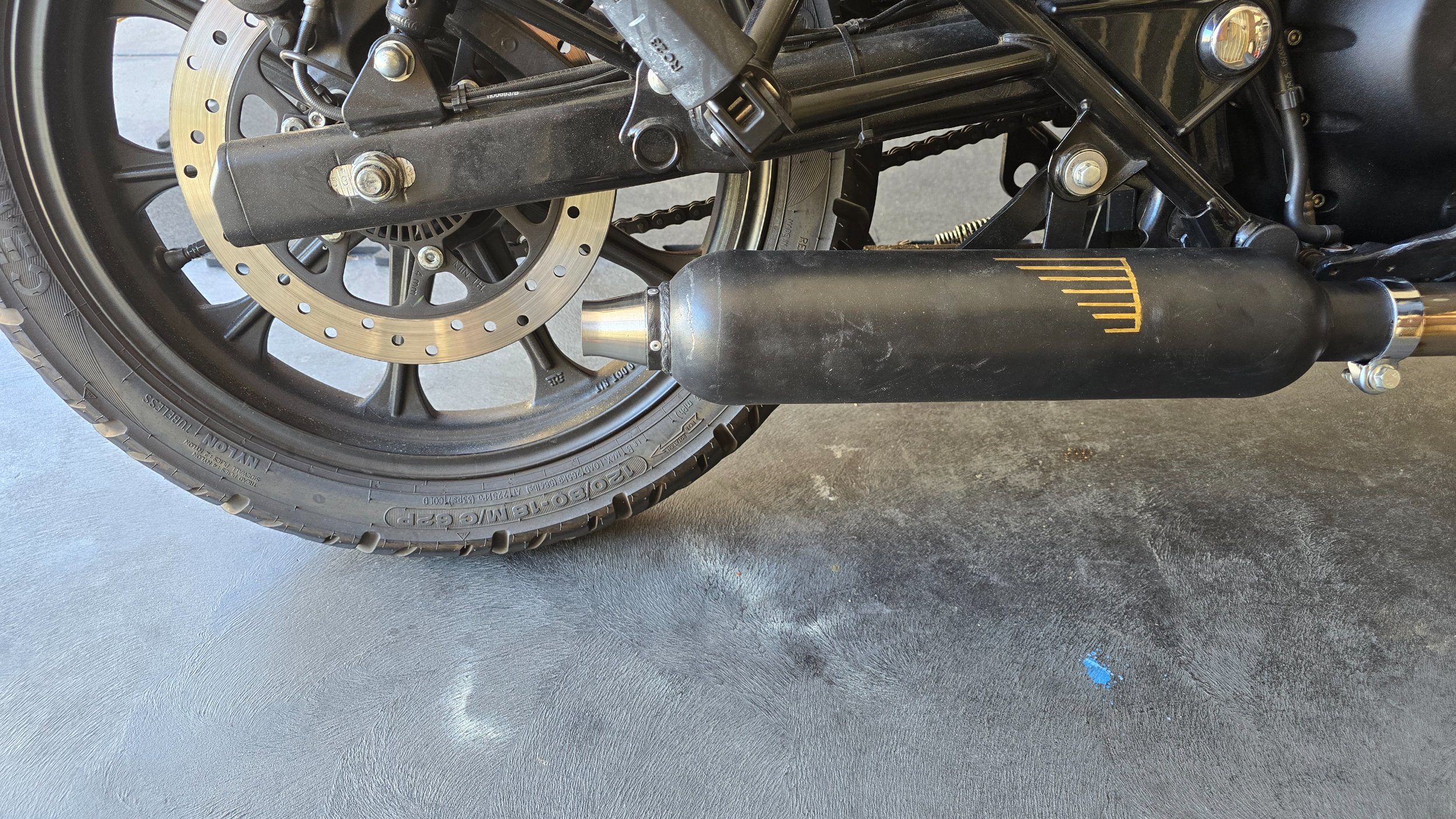

Cant keep still, My Mum used to call it "fidgeting".

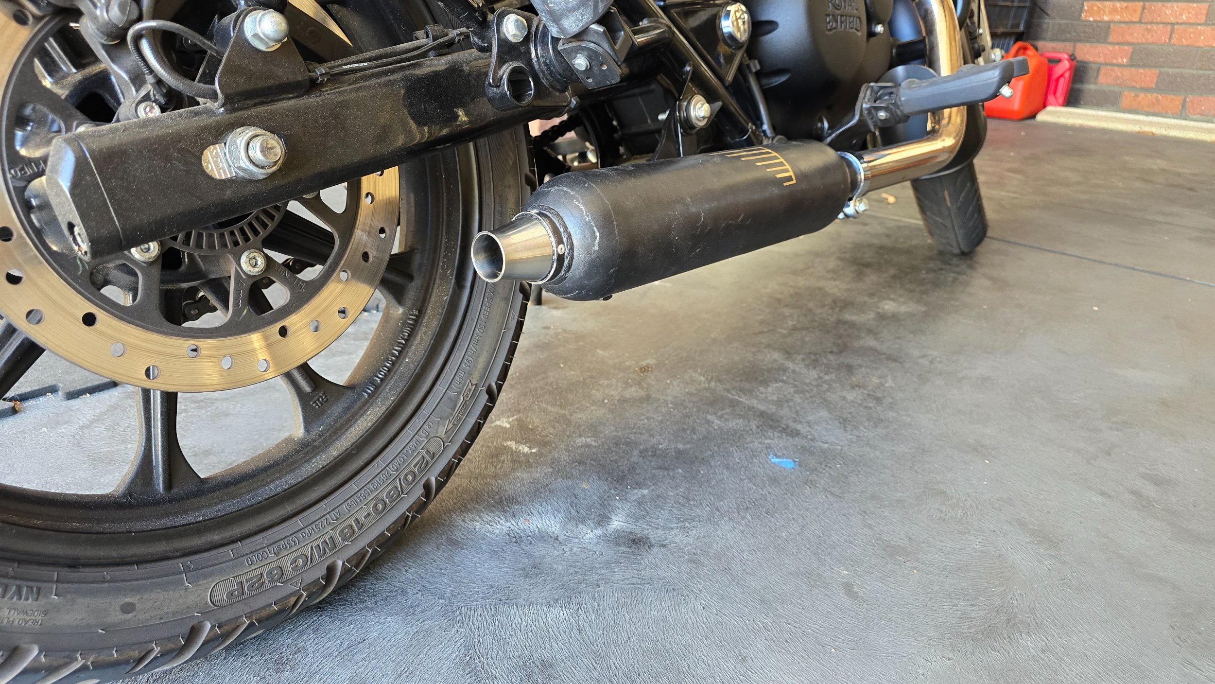

Slight mod to the Muffler, if nothing else it is Uneque 😁
Stainless steel.
