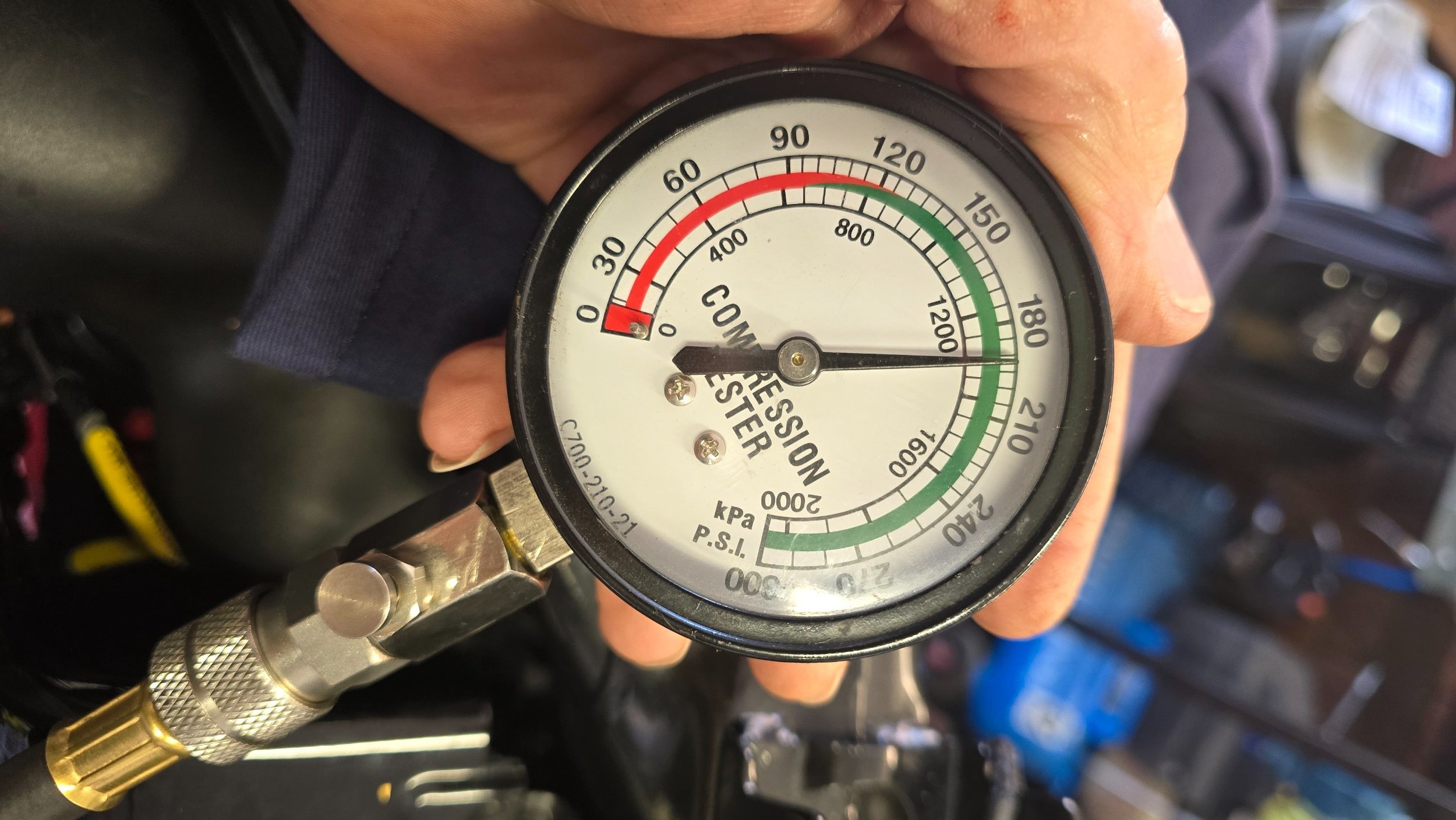

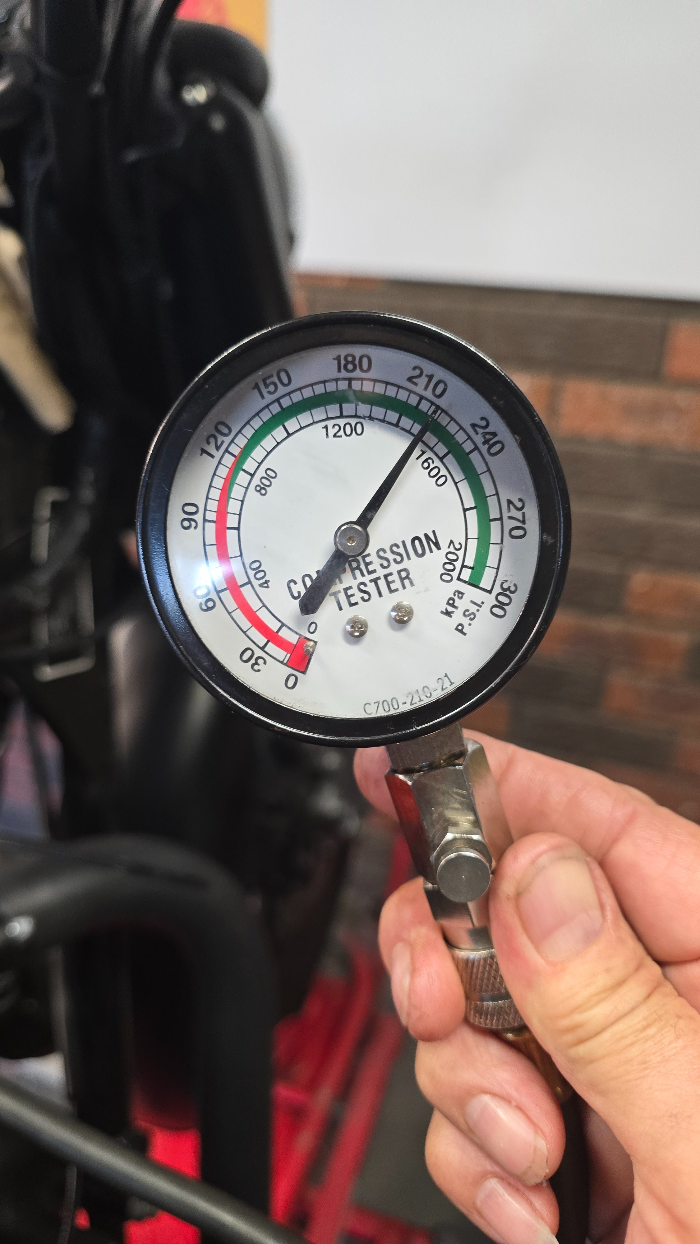

And here's the surprise ,compression has increased bucket loads.
Compared to the same build with an OEM Cam, which was 185.
So rings have bedded in?
Valves are open longer so more air gets sucked in?
I did it wrong last time?
Or the gauge is buggered?
I vote for this option.

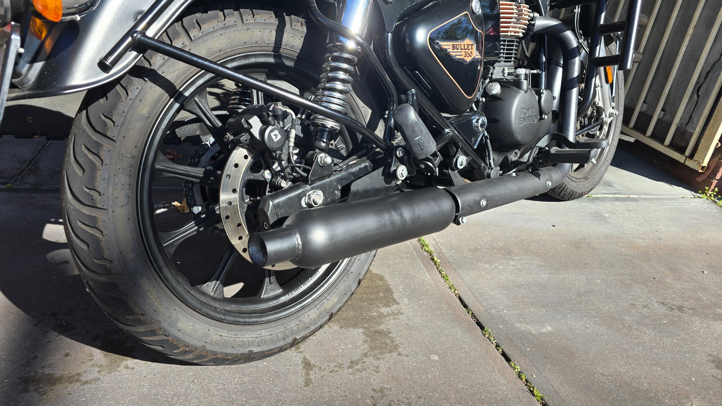

So reinstalling 411 kit, only 1 base gasket, stock head, Stage 2 cam, stock header, decat pipe and Indoori HK muffler .
As it stands, so the Bullet has the 411 kit Stage 2 Cam, Indoori muffler( with home made baffle), OEM airfilter with high flow cover.

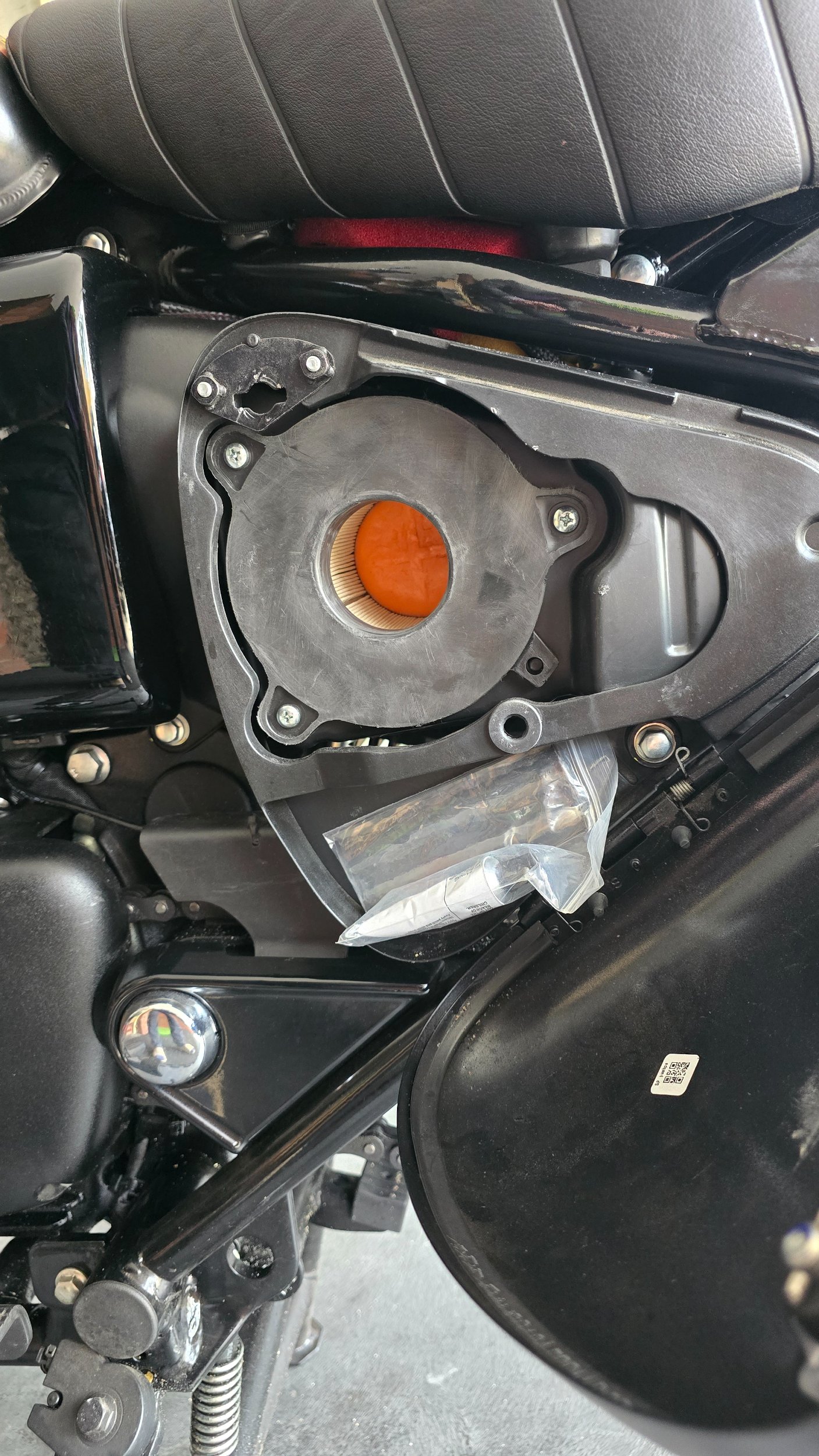

High Flow airfilter cover, hacksaw a Belt sander and my Dremel changed the OEM( forever).
I doubt this engine will ever use more air than can get through this.

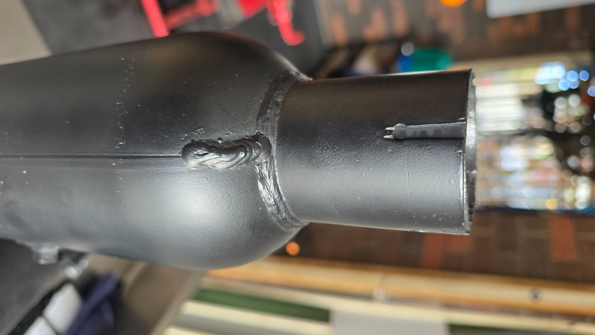

This what is commonly called a Hotdog muffler, at 45mm( 1 and 3/4 inch ) the inlet takes the stock graphite gasket and oem clamp is used along with the oem bracket ( that involved welding 2 8mm nuts.
Sound is good and the price is right, A$56 including freight.

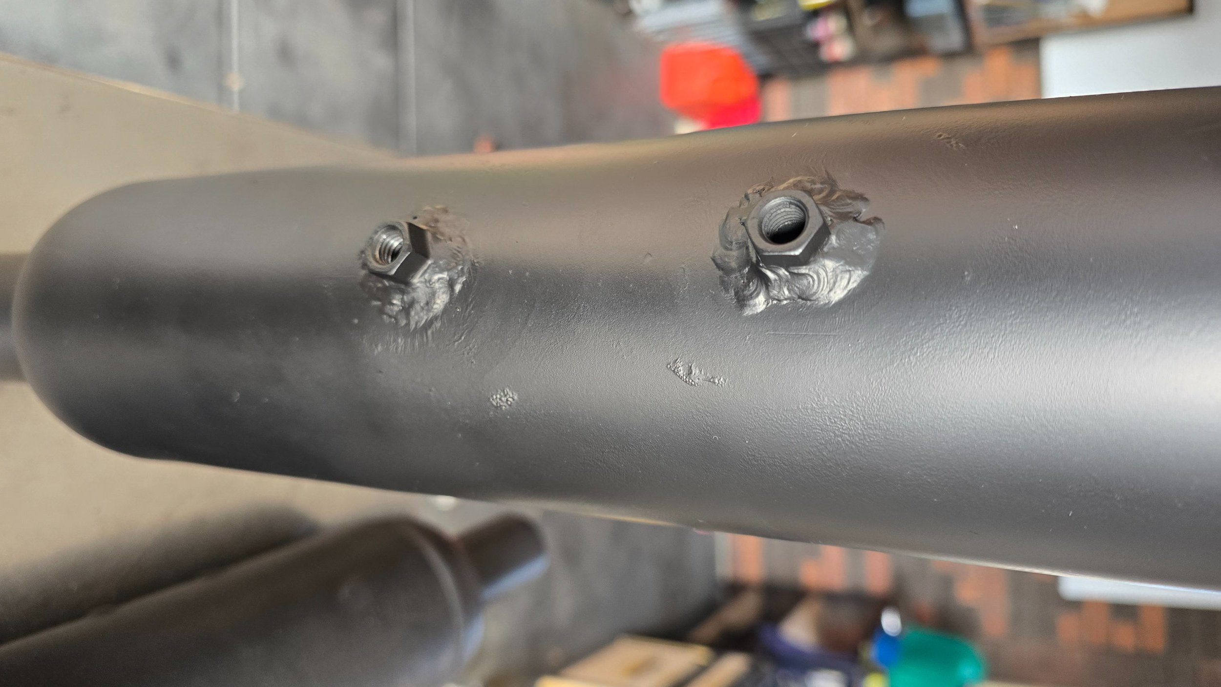

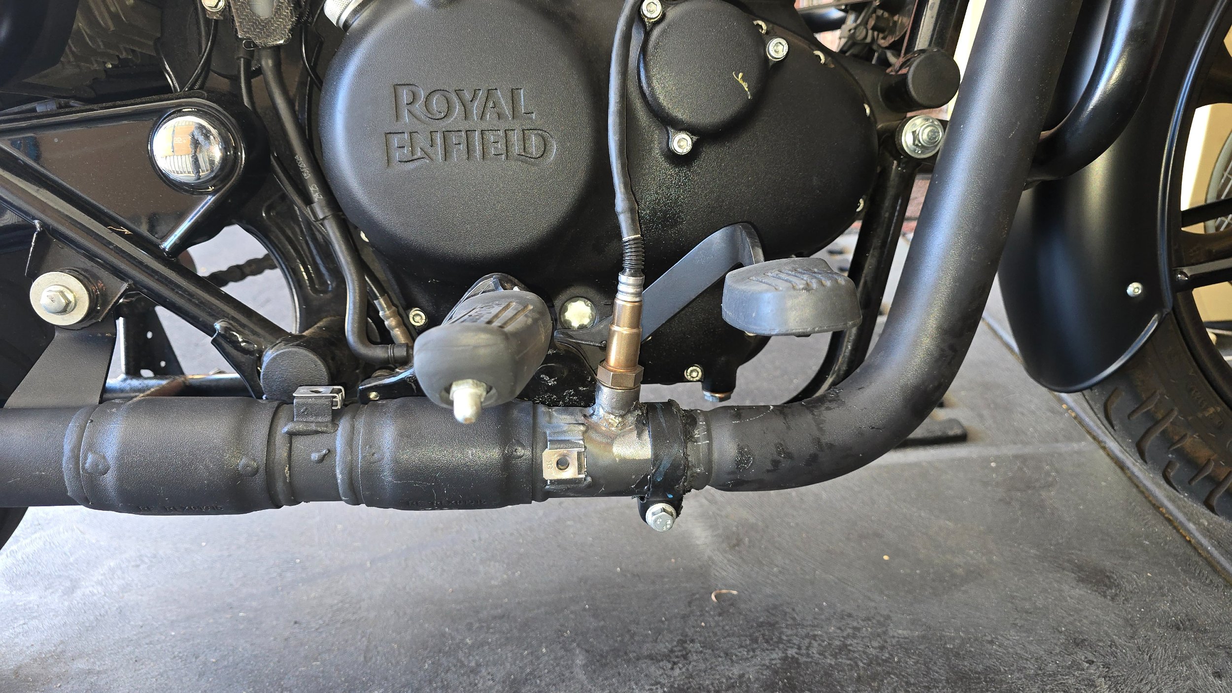

Cant stop fiddling, so I refitted the Delkovic system designed? for the meteor after welding in an O2 bung for my AFR meter.
Previously it started to run out of grunt before 5000rpm now it goes to 5500rpm and starts to run out of grunt!
Bit noisy even with the baffle but seems to me that it is breathing a bit better.

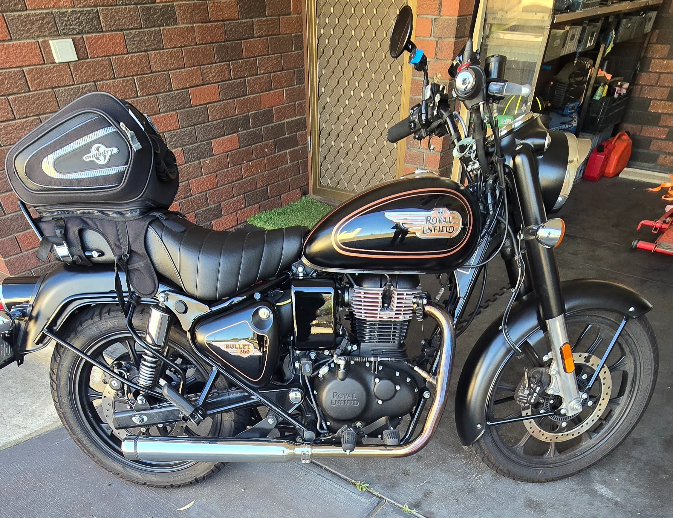

This is what I have fitted to my Bullet.

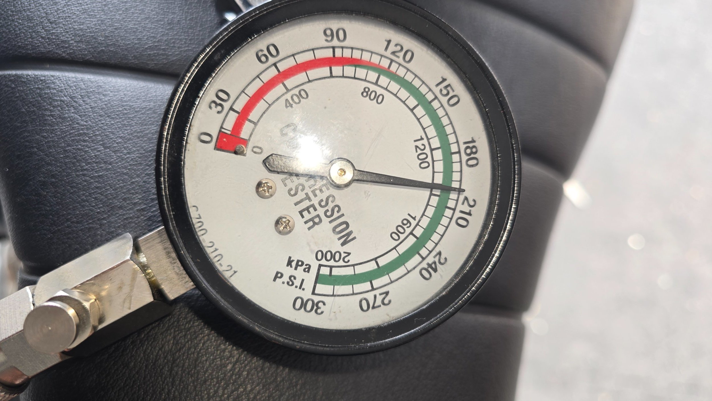

Rings keep on bedding in it would seem, this is the latest compression reading as taken this morning dead cold.
Compare to previous reading 1800kms earlier.
So from a new build there is a increase in compression pressure of 10psi.
Meaning I have run it well:unsure:

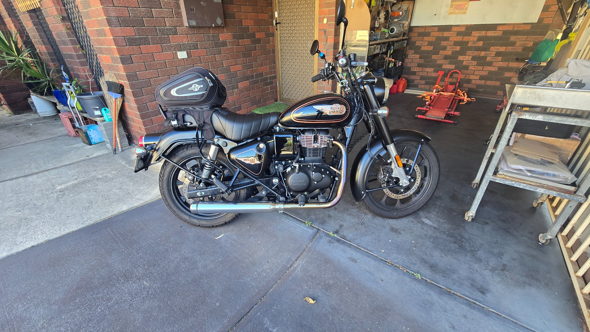

Build as it is now,
84mm piston, same size as the 500kit, even Baxter's call it 500! 😁 But for the sake of accuracy to be precise it is 84mm x 85.8 displacing
475cc,

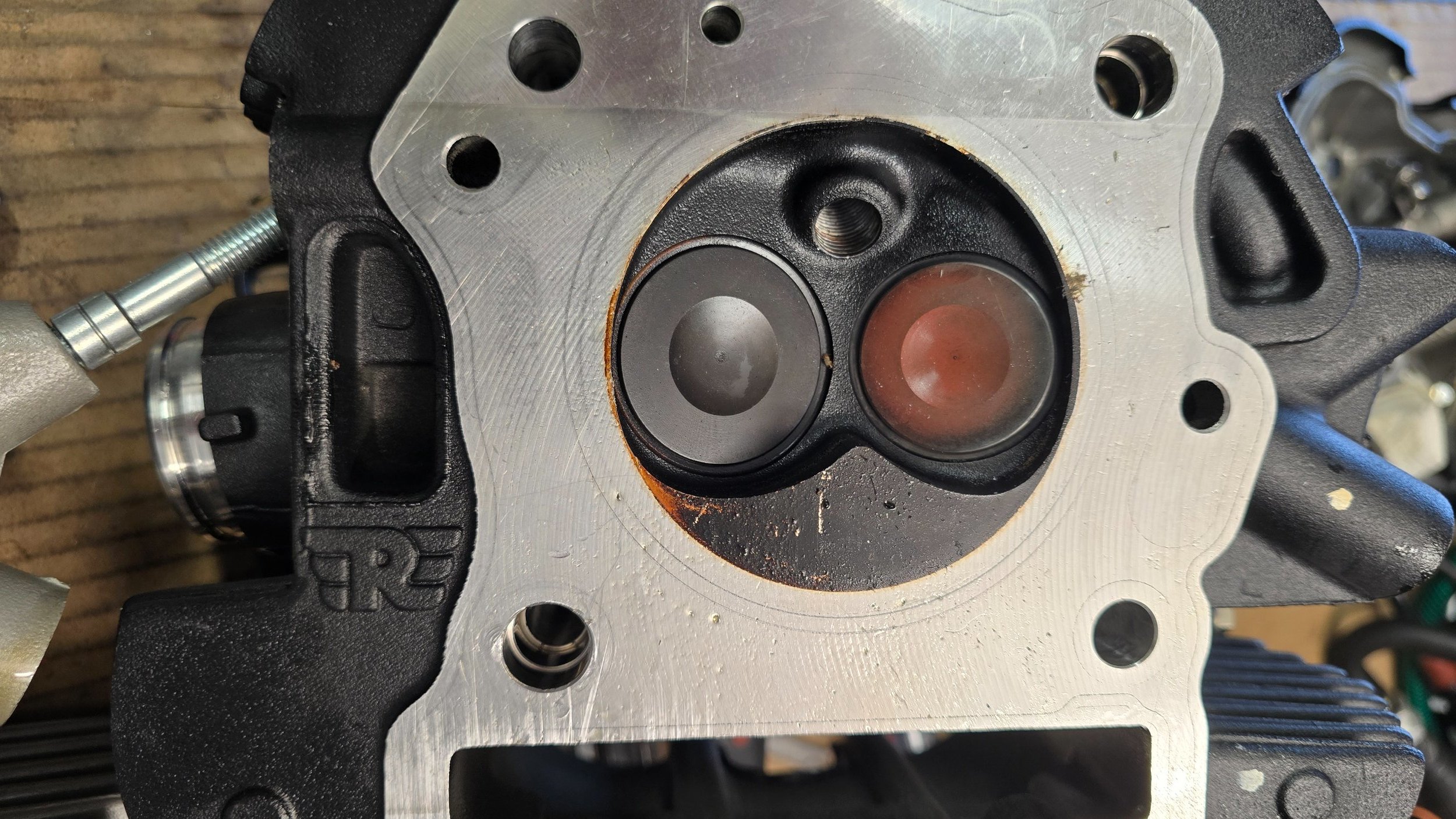

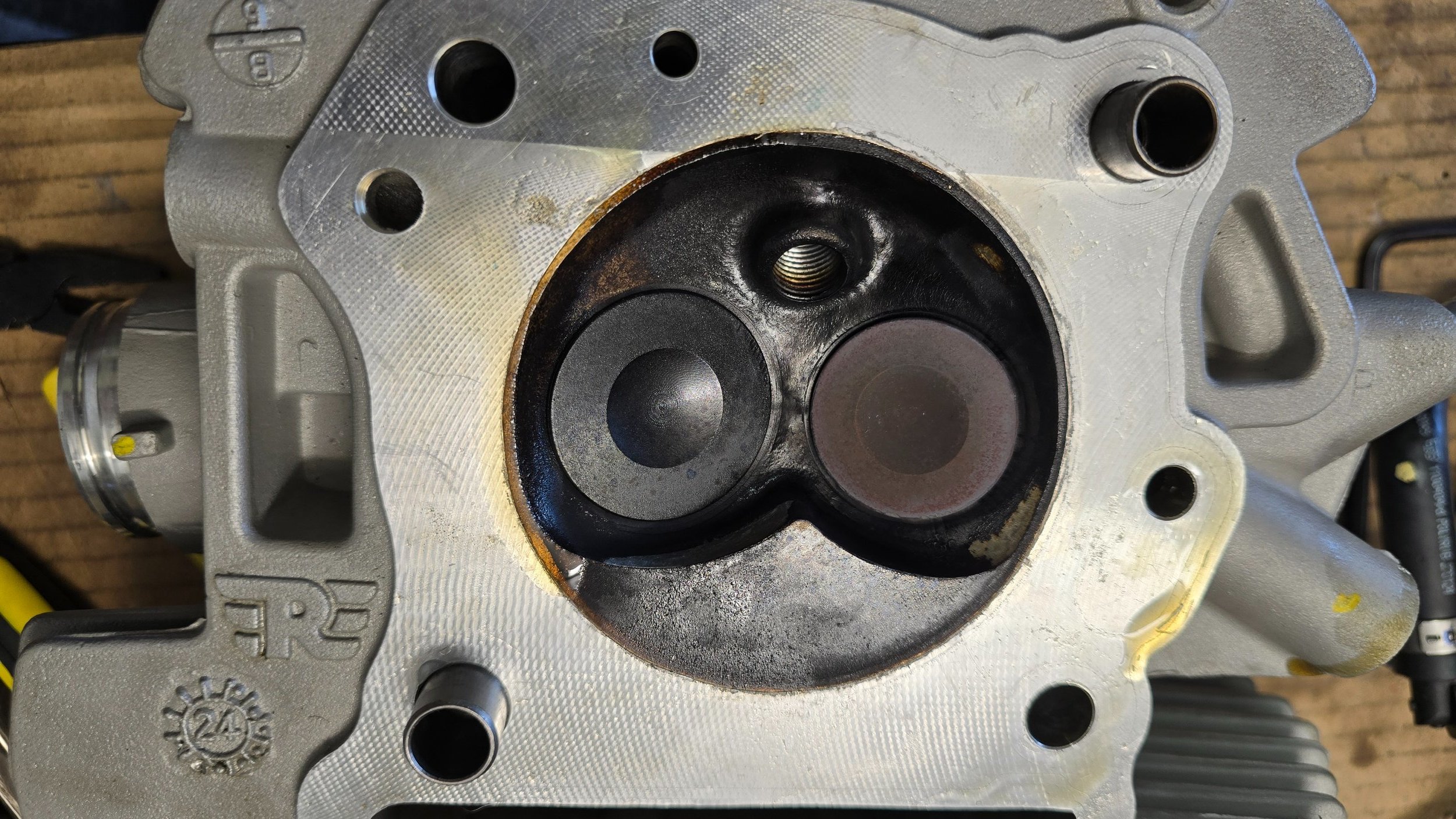

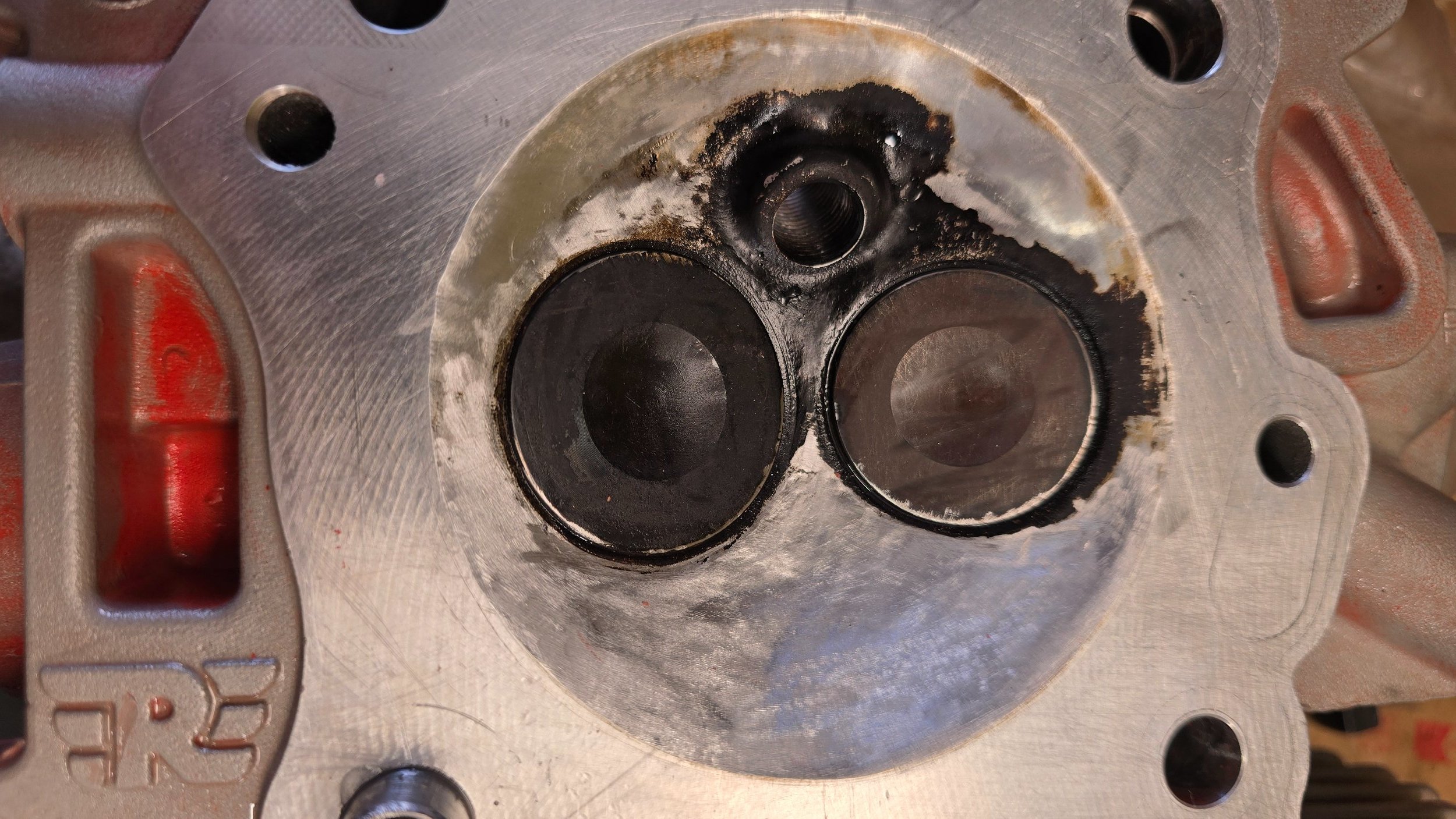

Reshaped combustion chamber/head,
This is OEM cira 500kms( i just had to wait for the first service:ROFLMAO:)
20250416_172450.jpg little bit of porting( little compared to the combustion chamber mods:ROFLMAO:)
OEM Cam, PT4 plus Fx pro+, Delkevic header ( much bigger ID!) 2 inch, 52mm slip on Muffler.

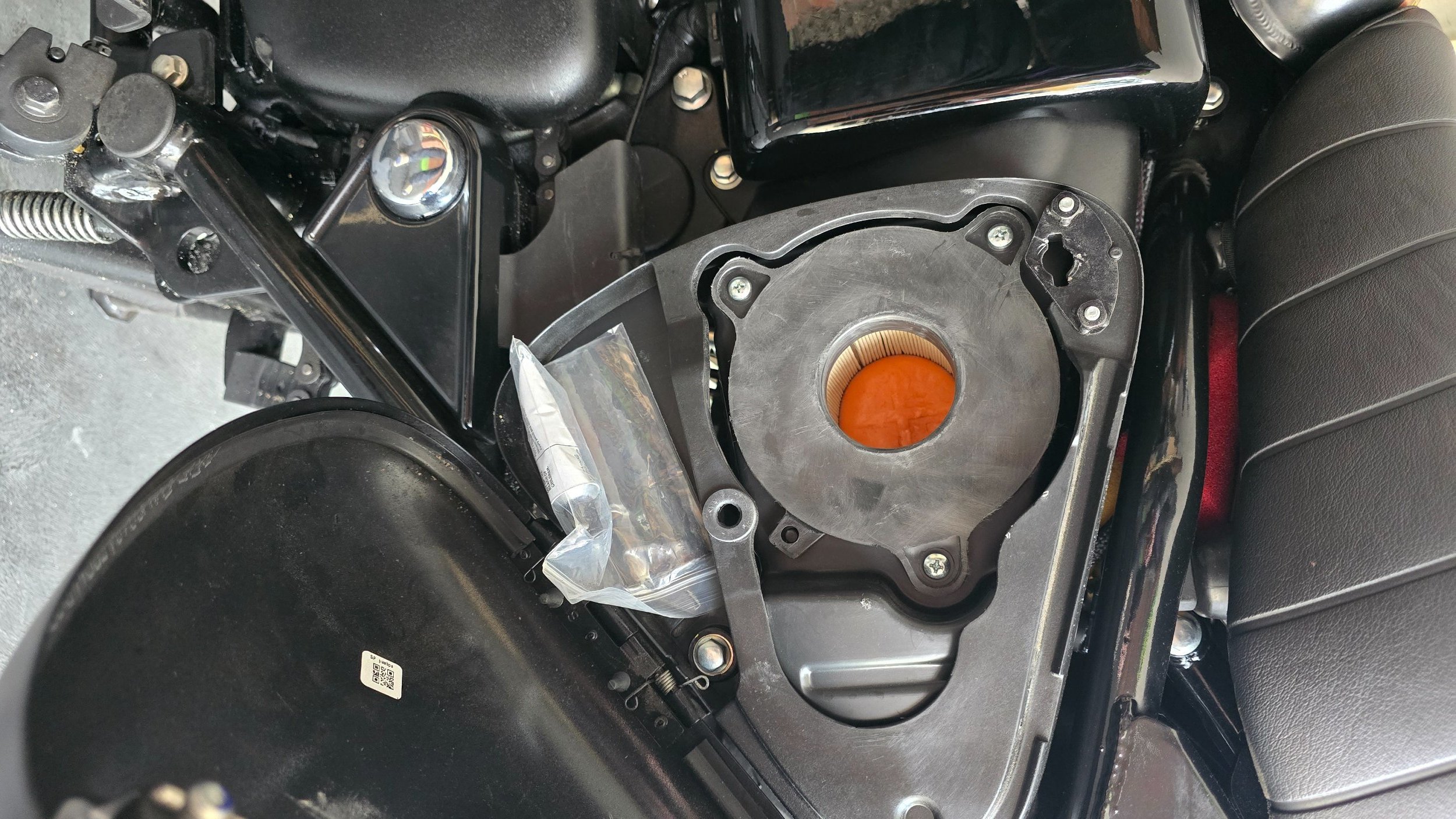

Air filter cover is OEM that I have Butchered with stock( and original air filter)
Since partially covered with a paint tin lid cut on angle held with hot glue( sorry no pic) PT4 and Fx pro+, .
2 teeth down at the back and 1 tooth up at the front.
Stock tyres, good chain of less than 1500kms.
I am expecting my wallet to be lighter by the end of the day but not much else.
It will be an improvement over stock at least, ( low bar!) and regardless it is a great bike that I feel much more comfortable on than the Himalayans were.

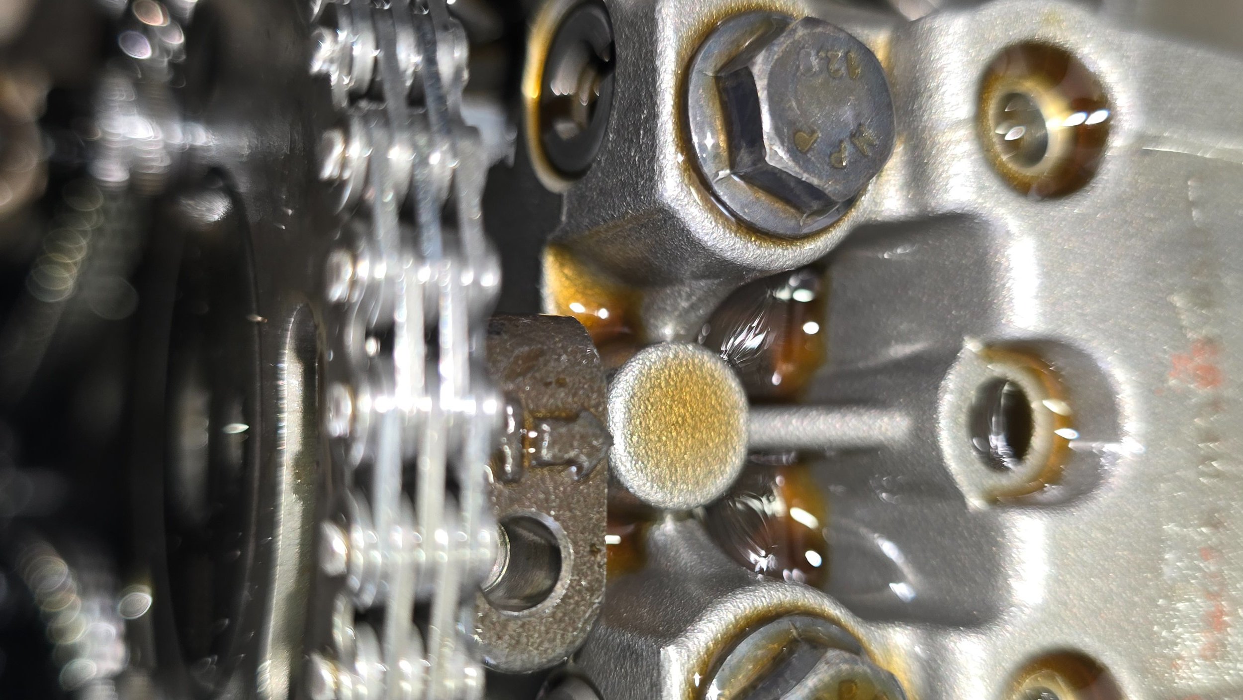

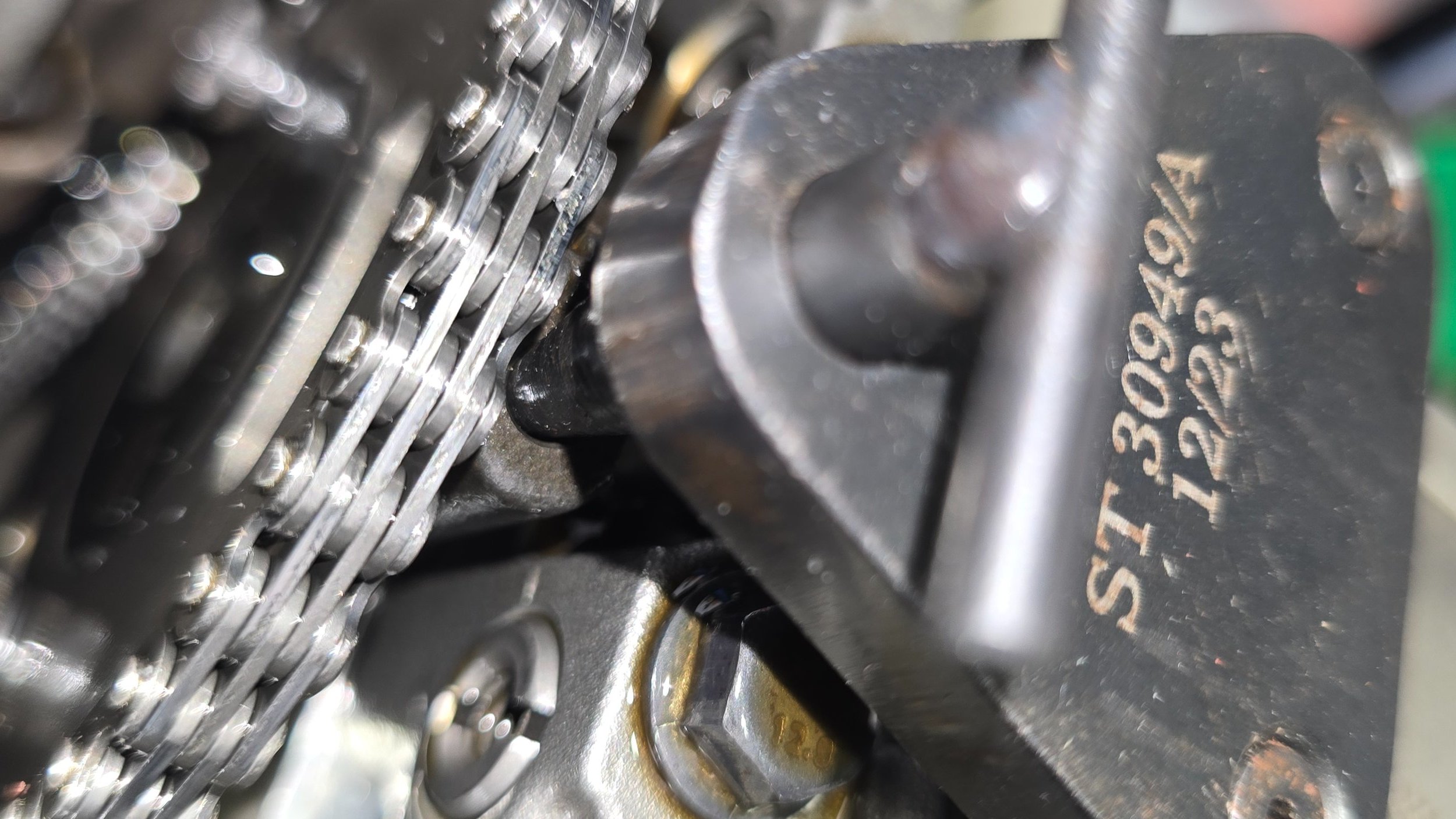

Prior to the Dyno run, I thought I should check the Cam timing with the Factory tools as the last 3 times I just looked at the piston rising with a USB Cam and set by eye.
So by doing by eye I got it that close that I don't think I'll bother using the special tools again!

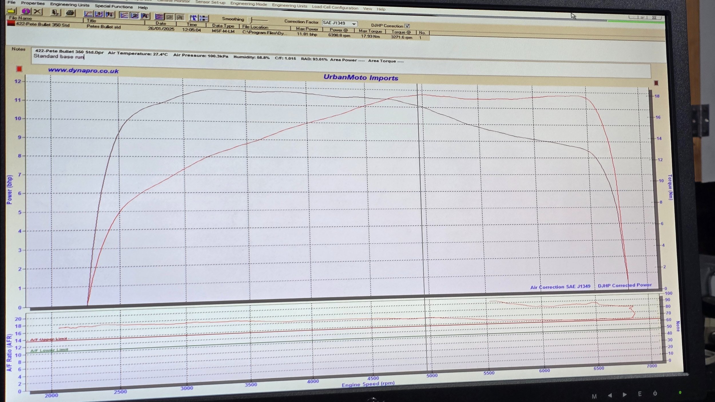

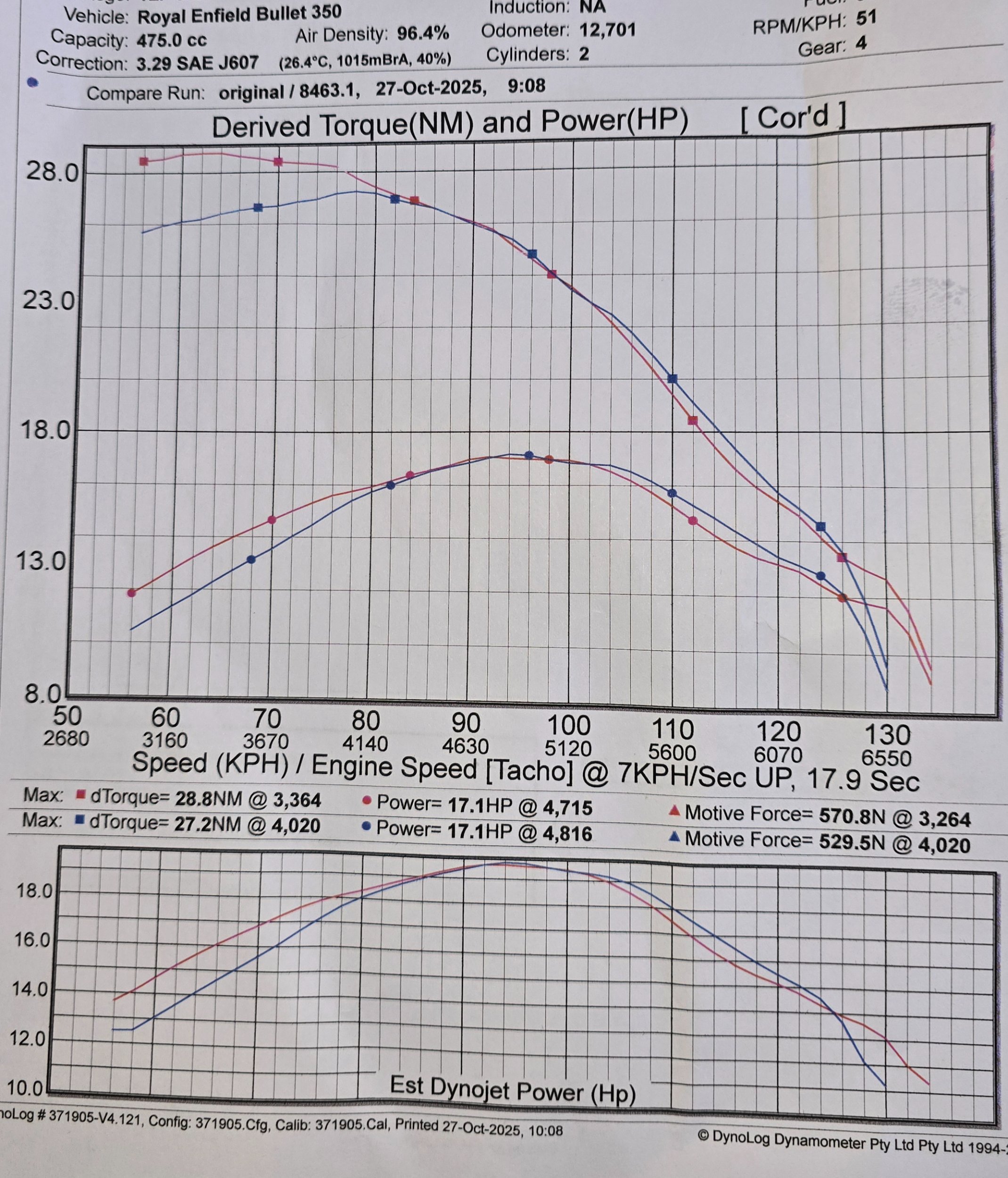

Make what you can of this, Blue line is my attempt at tuning, Red line is the Experts, cost A$700 for this difference ;)
17 hp for a 500?? also: you built a 2 cylinder version?
OK compared to the earlier 11.8 showed in your 350 reference its a lot.
It may all make sense when I get to my old Dyno shop for a run. It showed 19 HP there as a 410.
Need the ECU Reflashed but nobody seems to be doing that at a price I can afford :)

In order to get a Base line Dyno I have reverted back to stock for a run this Tuesday.
Being a bit lazy I did not change back the gearing which is 1 up at the front and 2 down at the back.
Expecting it to be rather sluggish in stock form with higher gearing, I am surprised how well it pulls, says a lot for stock Torque.

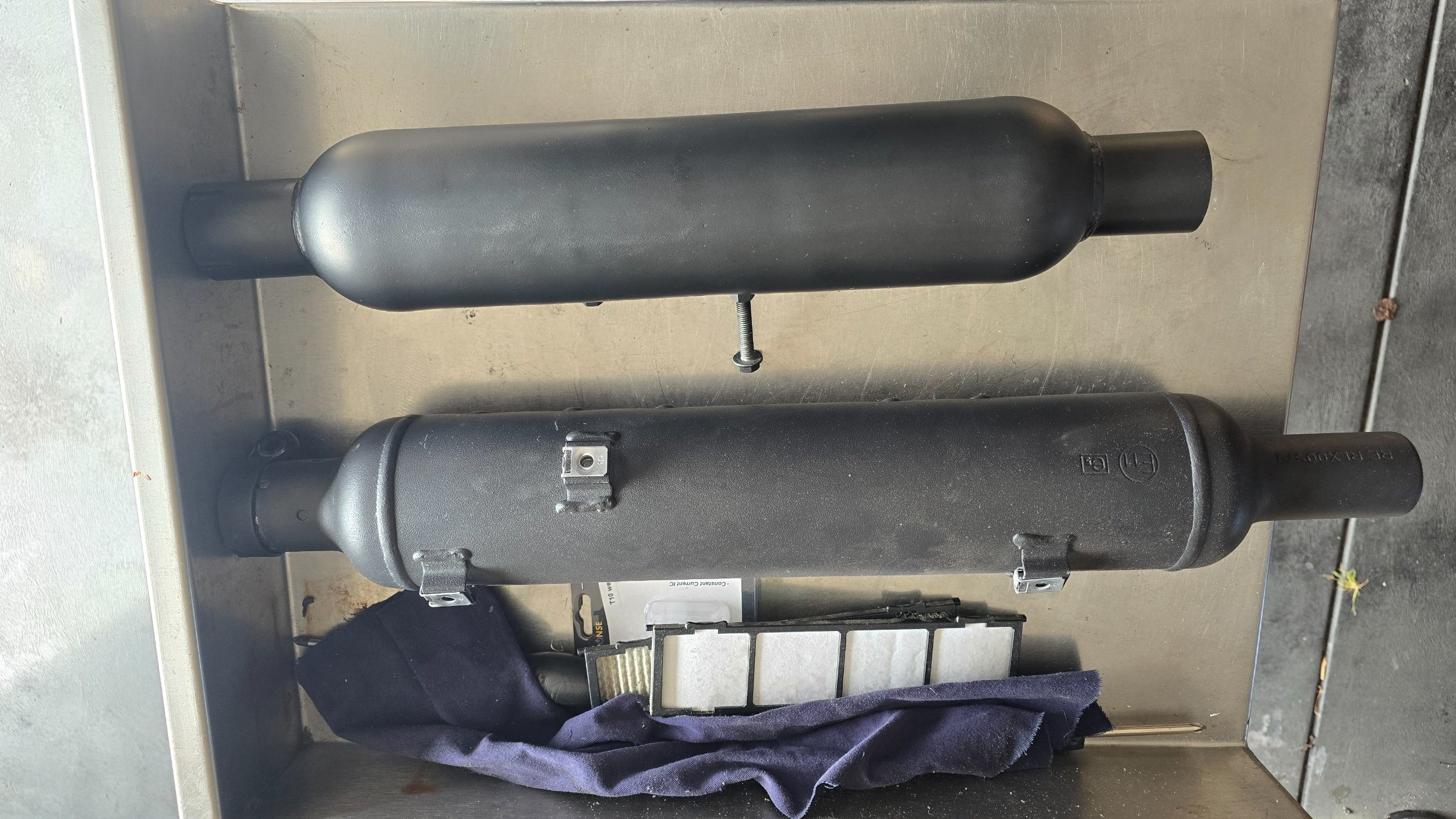

Because the stock muffler is made the way it is, it doesn't take a sniffer tube at the Dyno shop meaning I will not be getting fueling data and so will not be aware of the change in AFR when I fit a Camshaft for the following run.

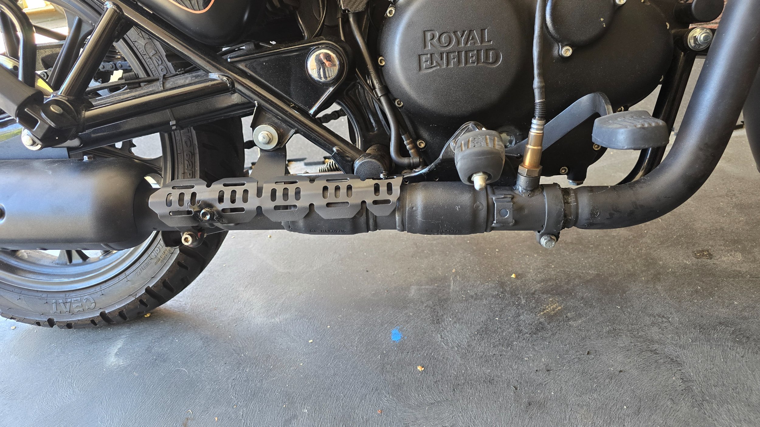

To make this fit I had to get the O2 sensor very close to the front of the Cat pipe even had to notch the Header pipe.
Meter now show a lot of high 14s and low 15s, good for fuel consumption bit not so good for power.
