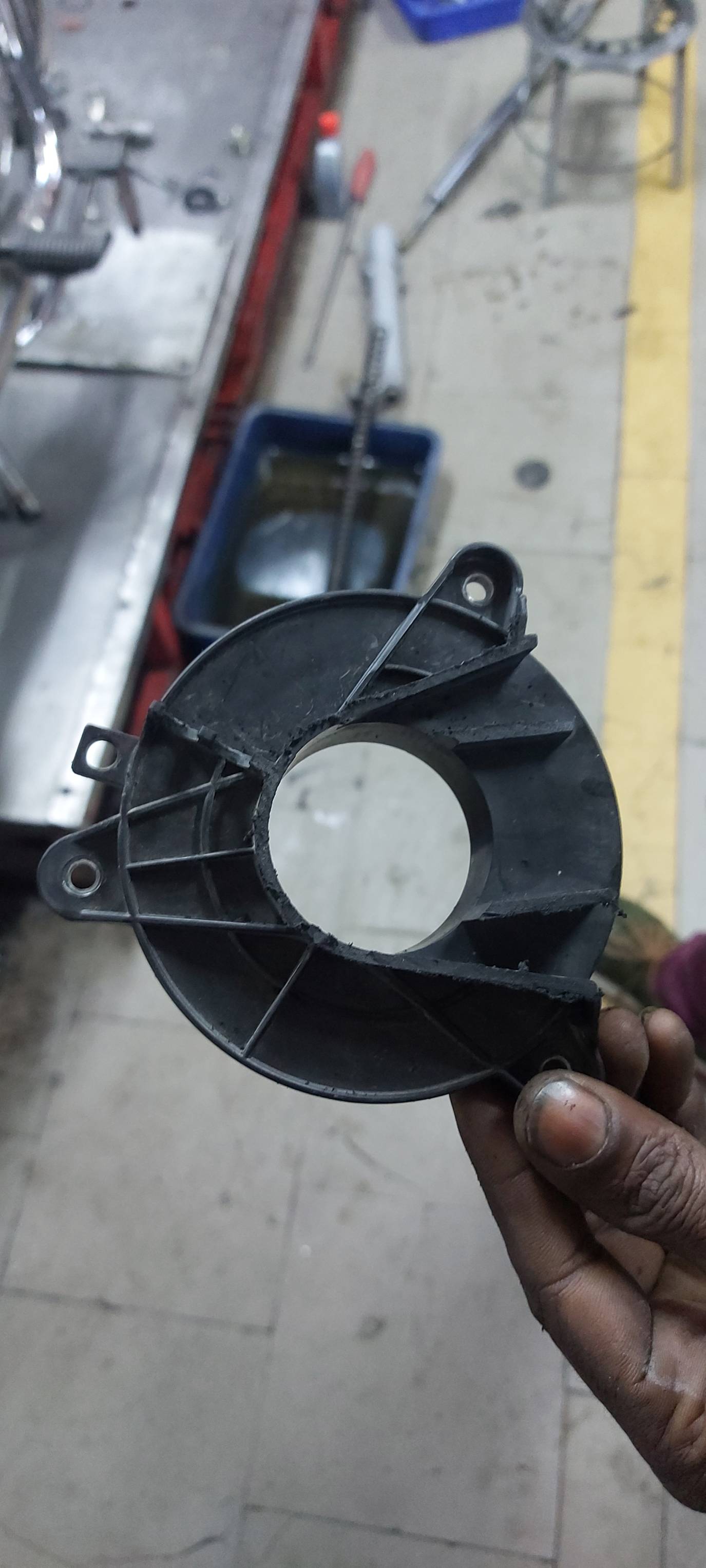

The cam was put in, while at it I also cut the air filter cover for more flow enhancement.

cut air filter cover:

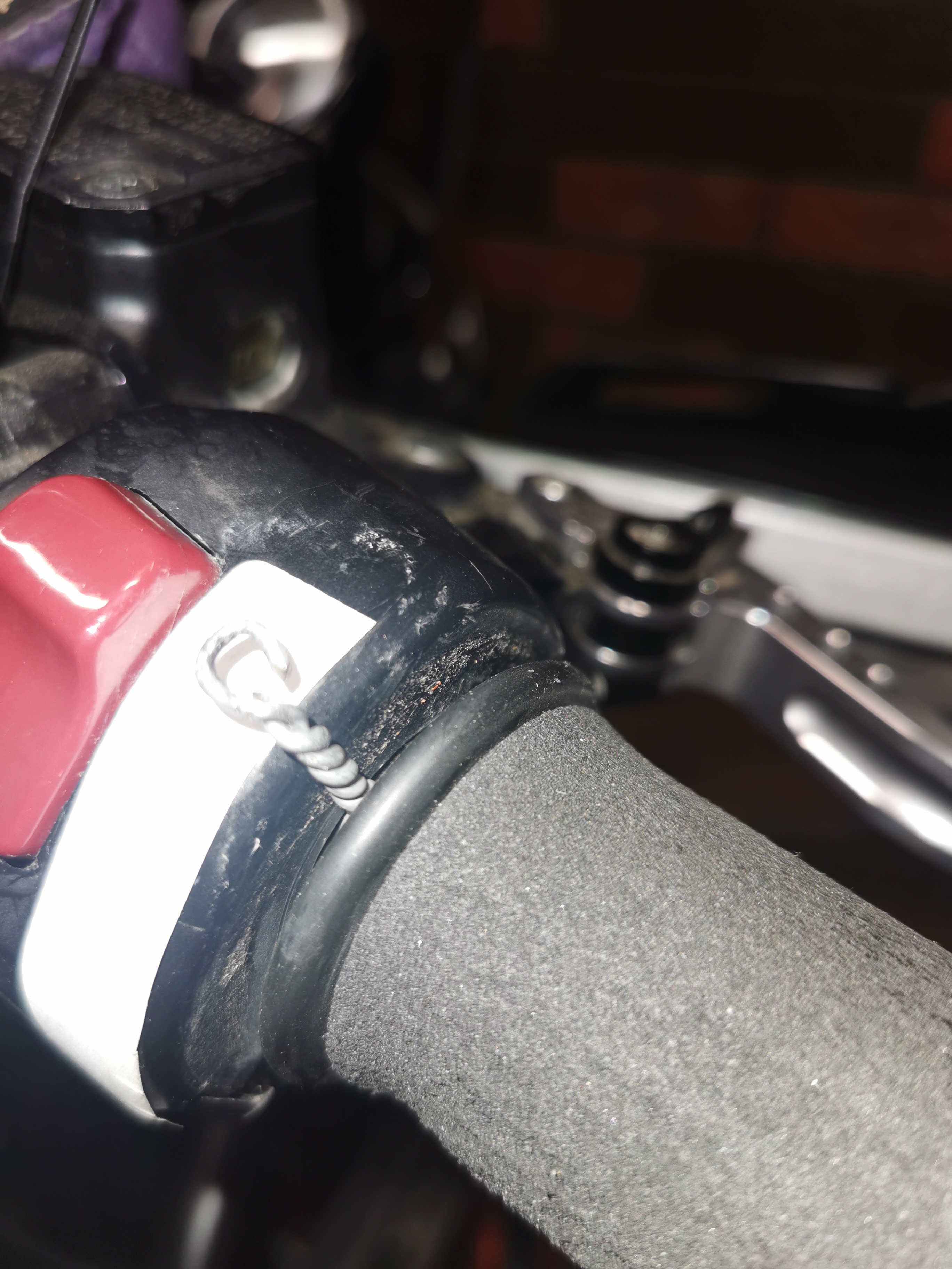

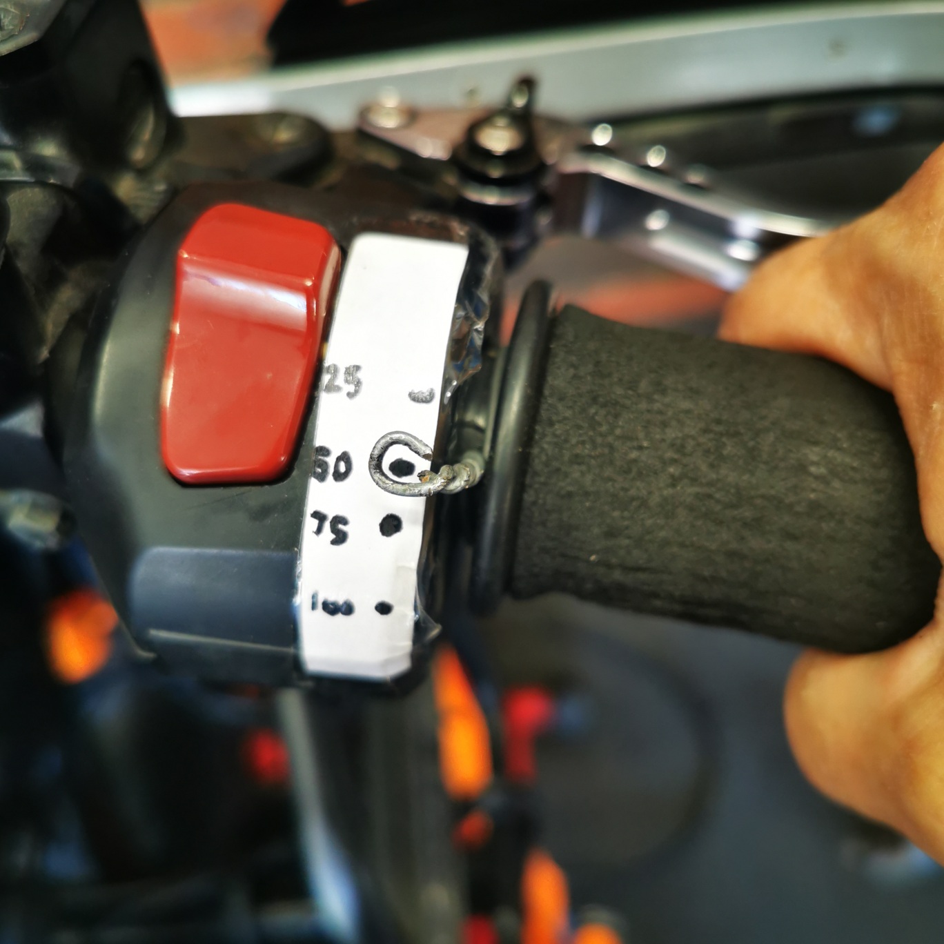

That's a start, as you know the Throttle Position is important so marking that will enable you to get an Idea where to look on the Map.
with wire make a Pointer that is moved by the Throttle
Now you have the Map the Compass and you are in it, this is no different to being lost in the Jungle :ROFLMAO:

Then using the Laptop and Software mark out some Percentage points in some white tape or a cut up label like that, using the Rev Gauge you now have 2 way triangulation or something and you can find where you are on the Map, reading maps aint rocket science :ROFLMAO: :ROFLMAO: :ROFLMAO: :ROFLMAO:

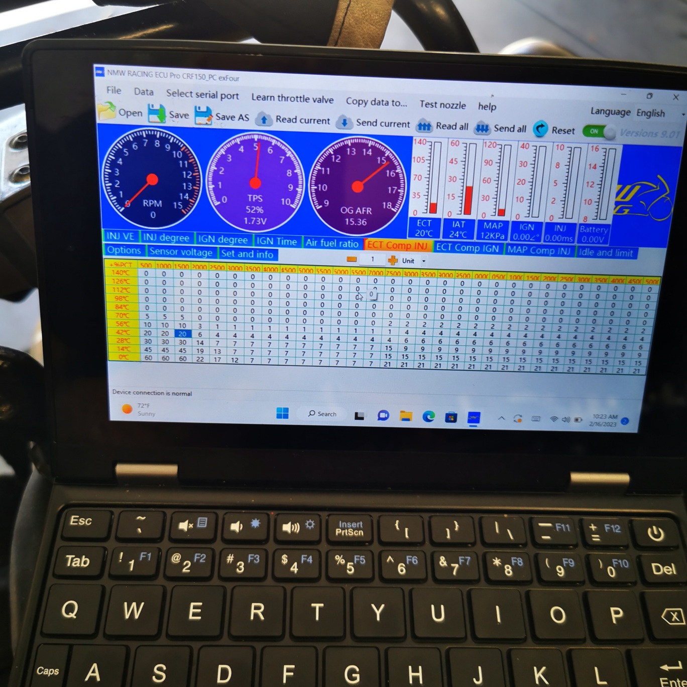

Sam, unfortunately a dyno session without the proper live tuning won't provide (to me) useful data to correct the map, because I don't know what the base map is.
What I could say is that you could try adding +7% to all cells in the row from 0 to 100%TPS and column between 500RPM and 5000RPM.
Add +4% on all the other cells in the map (so 0 to 100%TPS on column above 5000RPM).
This addition has to be made on top of the existing number so if the number in the cell is, say 17, add 7 (24 final value) or add 4 (21 final value) depending on where is the cell in the range (see above).
Also, for good measure, add +1 on the ignition to all cells in the row up to 25%TPS.
What I would do is first to copy all values from the map you're using to the other map (so the base map stays untouched) for both fuel and ignition and then apply the changes suggested above.

I was going to implement Sasa's changes when I realized that the ignition data had been preserved but not the fuel data. which means yesterdays ride was done with the map done by RD PLUS Sasa's ignition data - and not the fuel data as well.
Reason was that I had no (and still have no) manual for the software and can hardly read the 10' screen in broad daylight - the software said "writing data to device" - which meant temporarily - there is a tiny button in the lower right corner saying "burn" which I overlooked.
I was able to retrieve the fuel data from a map I had saved but lo and behold, no way to copy that stuff to the ignition data map. I had to do the entire shebang again, one field at a time.

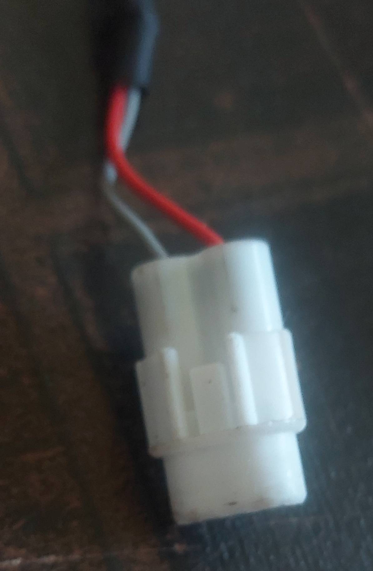

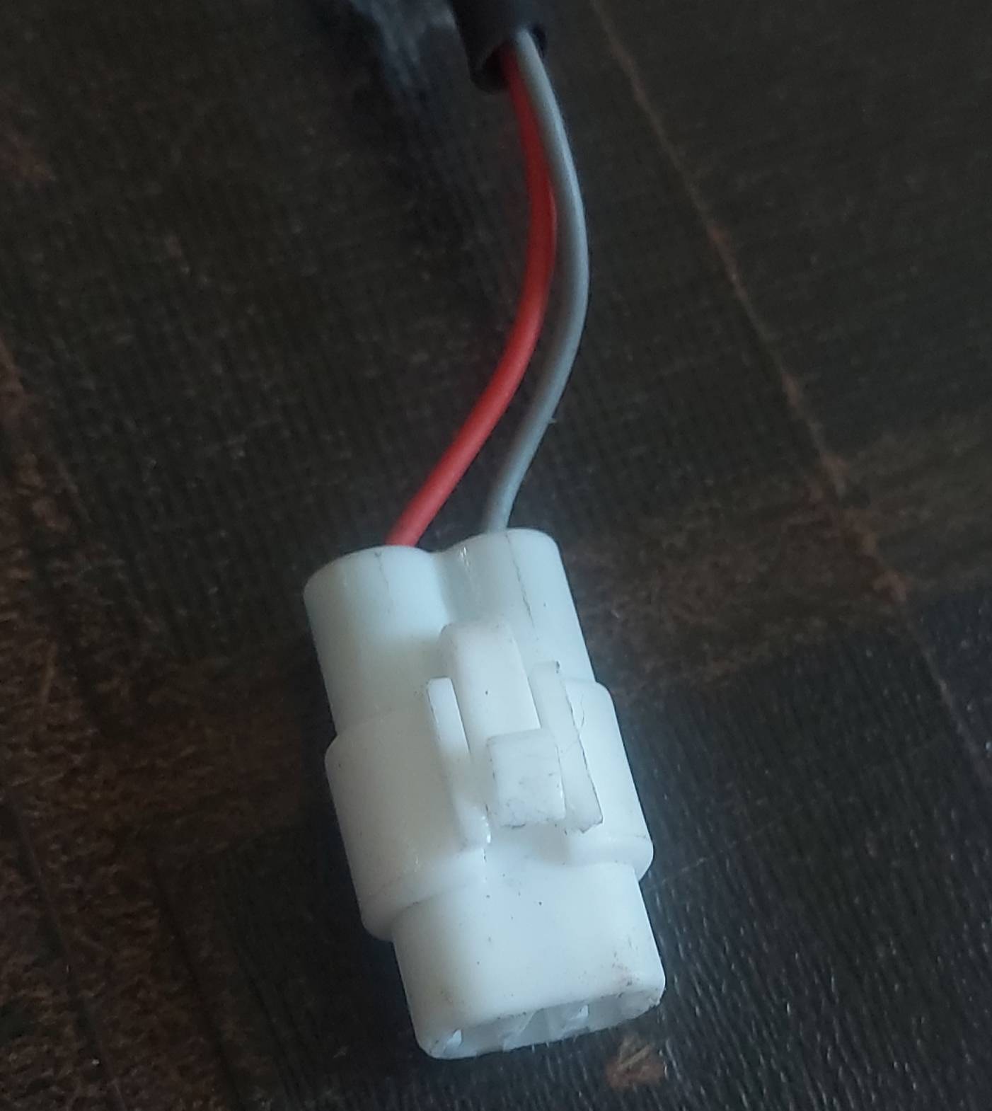

I have taken the PT out of the bike which is problematic because there is one small connector that is very low quality and will not sustain repeated uses - although the main connector is easy to use and very solid. However if done only on occasion this procedure will work and allow you to modify the map in the comfort of your office on a big screen.
This is the connector that will eventually break - and a view of the 10' screen in daylight
