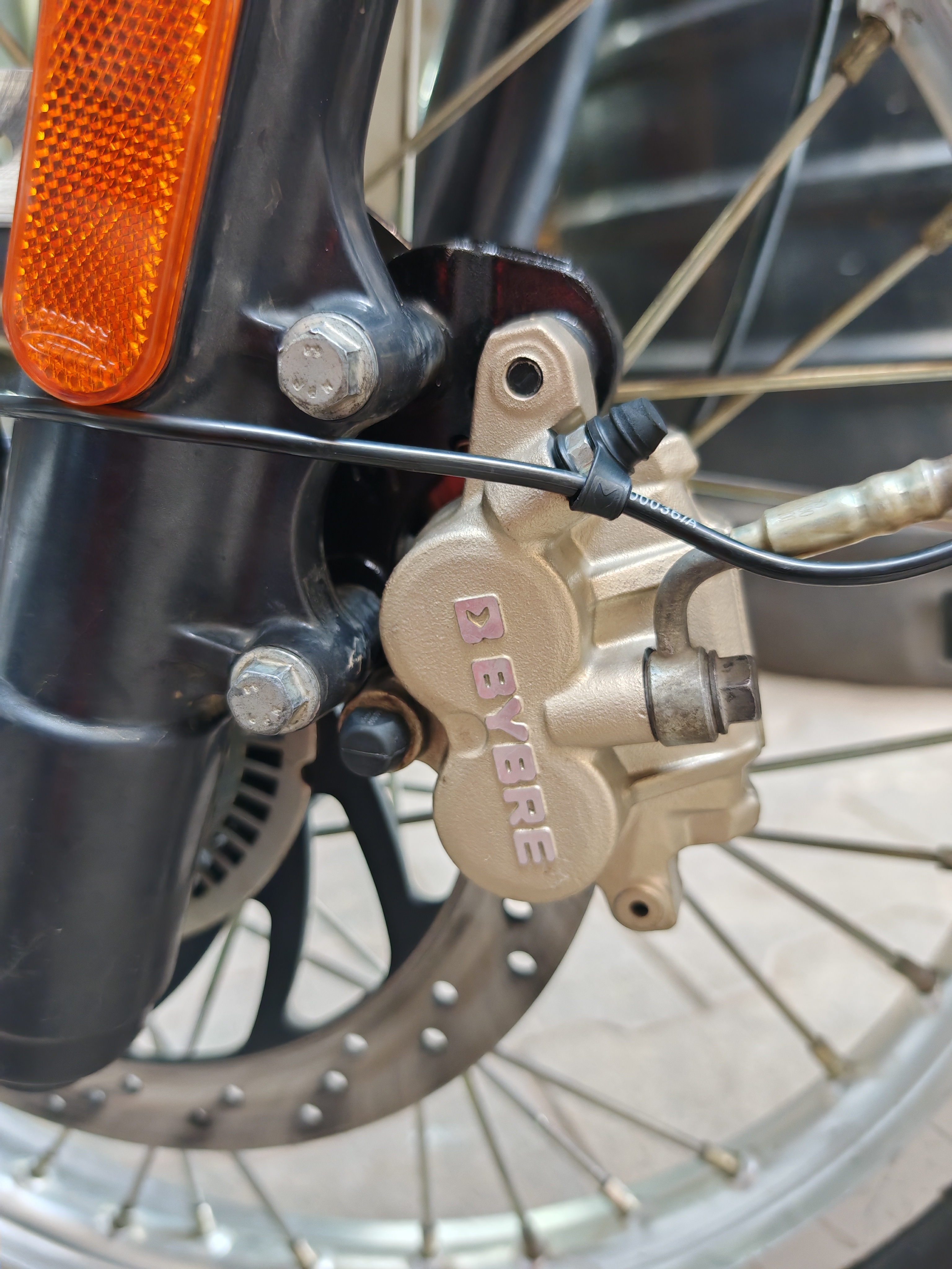

So, I got the Scram 440 caliper. Will get it fit post Ramadan as my garage is closed till then.
But it seems a direct fit. The caliper is a 30-32 mm as compared to our stock 26mm.
As Sam already mentioned in another post, the braking on the scram 440 was better and I am hoping it will make things better on the 411 as well, combined with my radial brake levers.

Just a small update, measured the mounting bracket, it's not a match with himalayan. Slightly bigger gap between the two mounting holes and also bigger sized bolts.
Will be building an adaptor post Ramadan with my Mechanic.

So, I did manage to Install the 440 unit on himalayan.
I got the 440 caliper bracket mounting holes filled up with welding.
Then redrilled them to match the hole and threading of the stock caliper bracket.
Did it's job well, now I can swap back to stock if I ever need and didn't have to spend much on a custom mounting bracket.
Braking is definitely much much better. Will see if I can grab a video this weekend.
