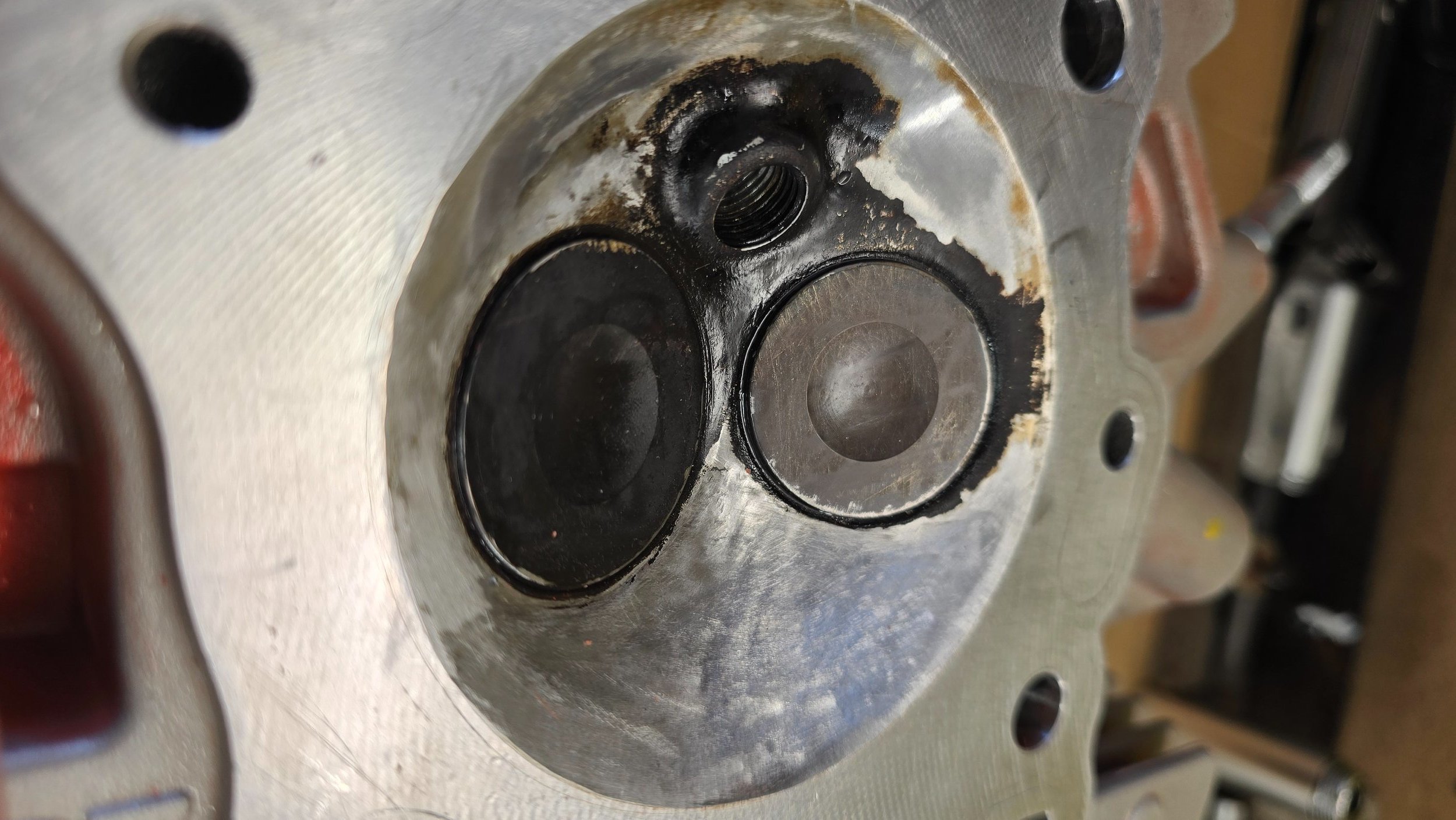

When you compare the combustion chamber design of the J to the 411 Himalayan you see huge differences.
I did anyhow;)
Start with the 410, the piston was not designed for the J combustion chamber, the Himalayan piston has a more symmetrical crown where as the J piston is obviously designed for the J head having a raised area that is aligned with the combustion chamber.
This pic is stock J head after being removed from my 410 build gasket is in place.
there is a 6mm Squish ring formed which may or may not be of benifit, certainly it was not designed to be like this.

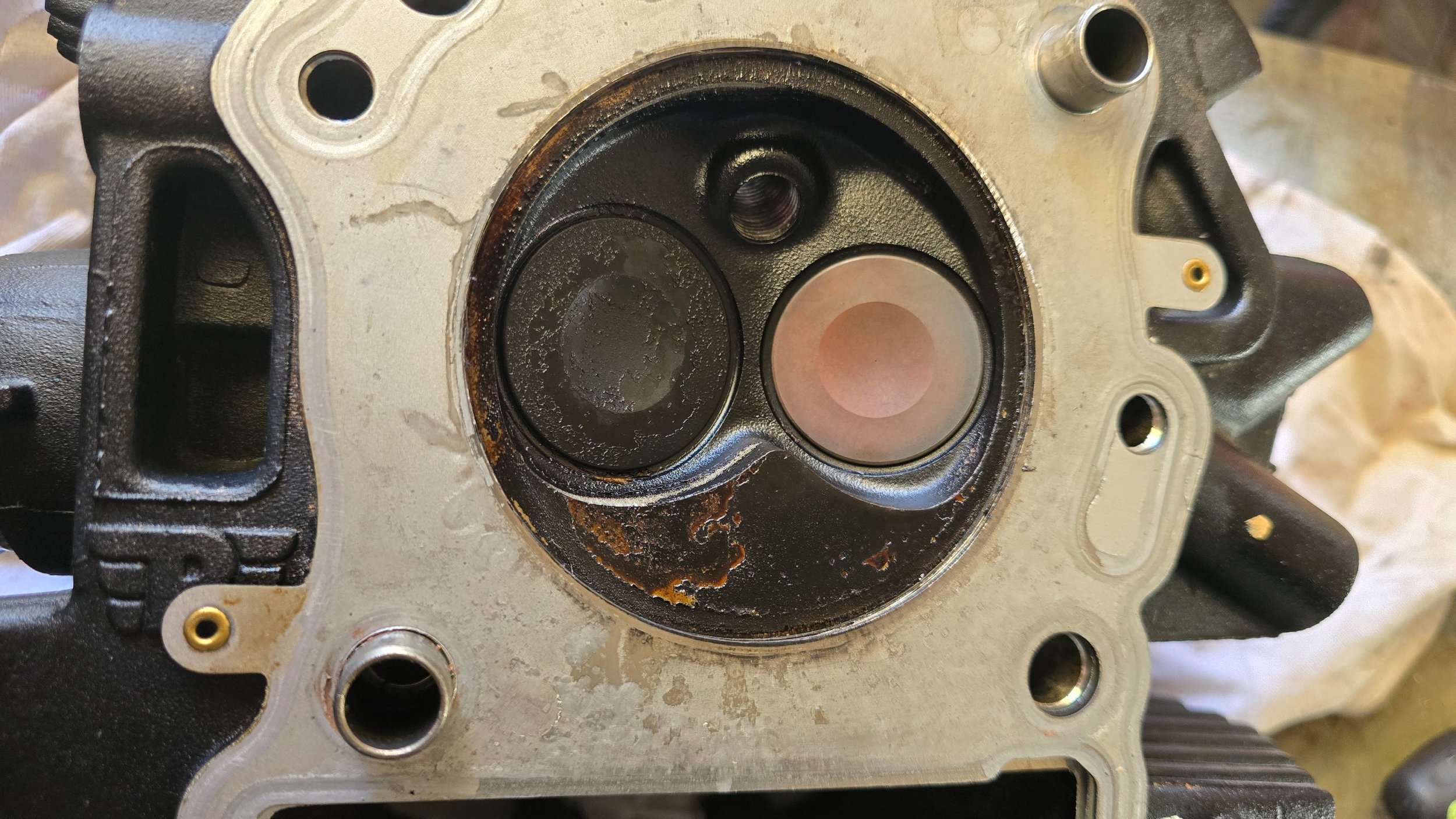

My latest build is same cc as yours albeit my piston is different, this what my combustion chamber looks like now ( well not now as it is bolted to the cylinder :LOL: )
Plenty of room there for 4 valves?

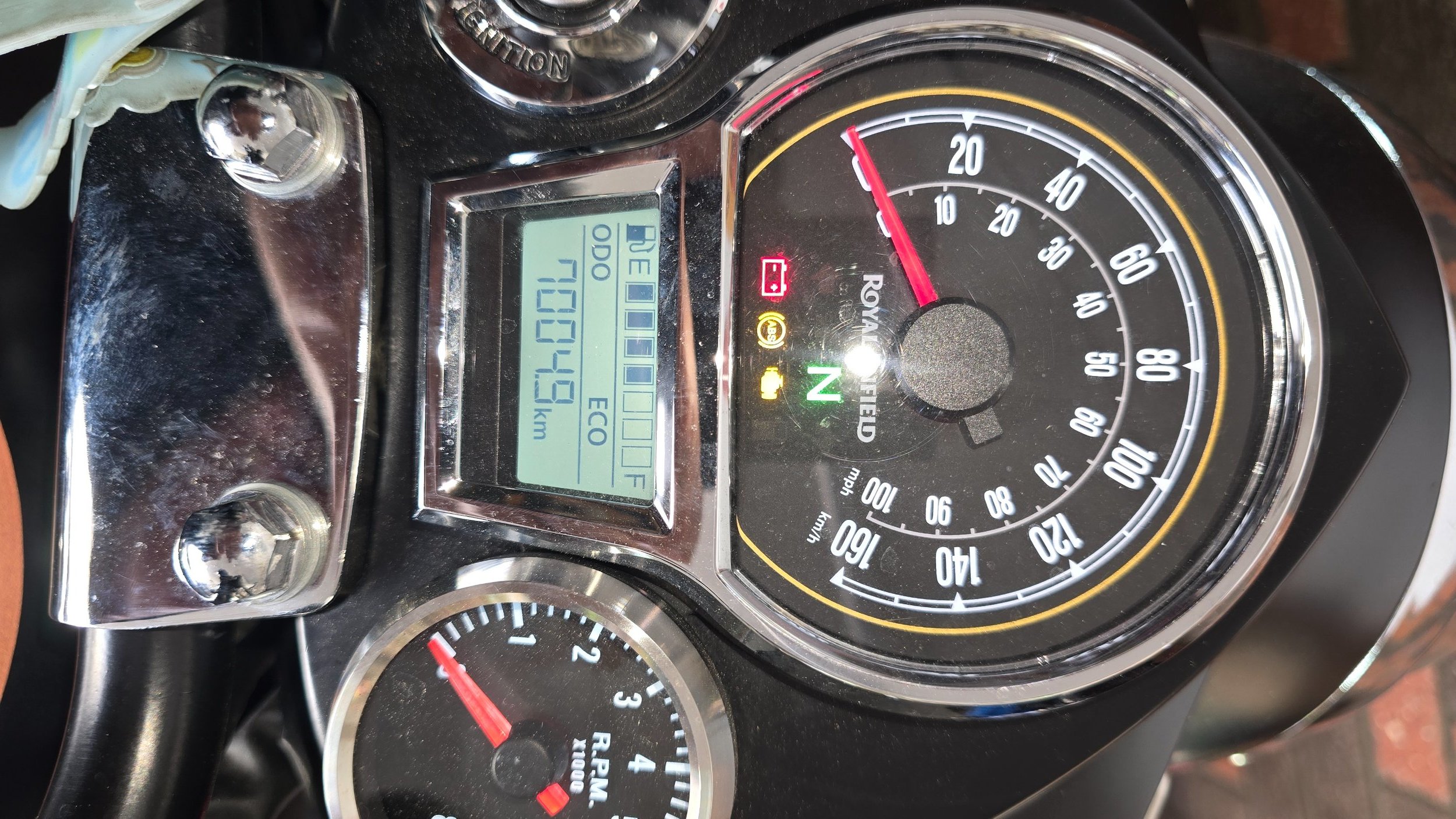

1. The engine light stays on - is that expected or should it mean there's something wrong? What may be wrong?
2. When riding on low rpm the engine feels bumpy - is that fixable with ECU tuning?
Engine light stays on?
Yellow light shaped like an engine?
This one under the Neutral light

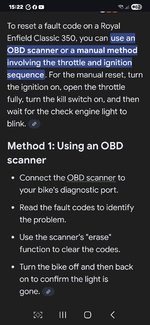

This indicates a fault, it may have been when you reassembled the wiring perhaps the ignition was on and something unplugged set the code.
It stays on until cleared and comes back on if the fault persists.

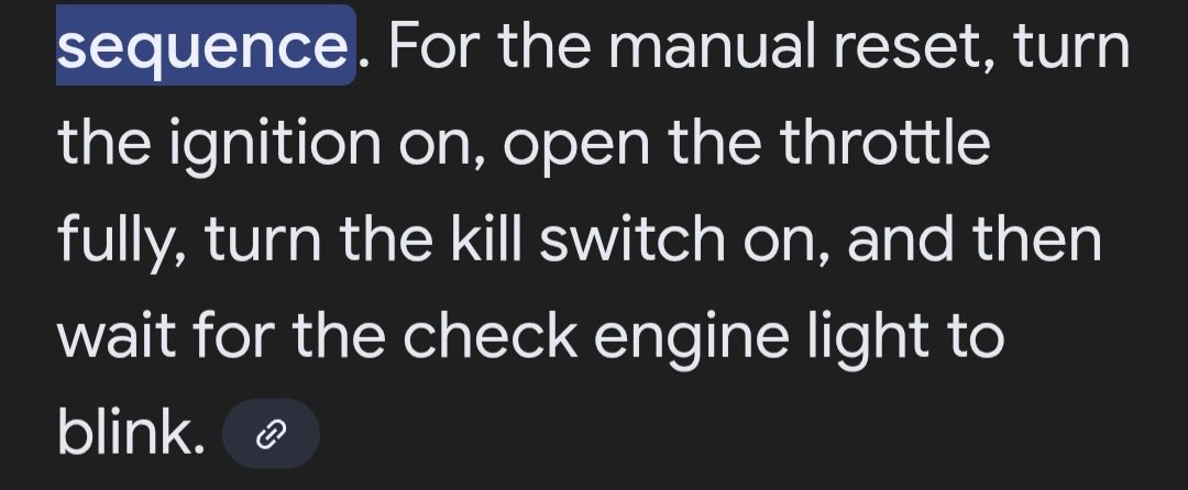

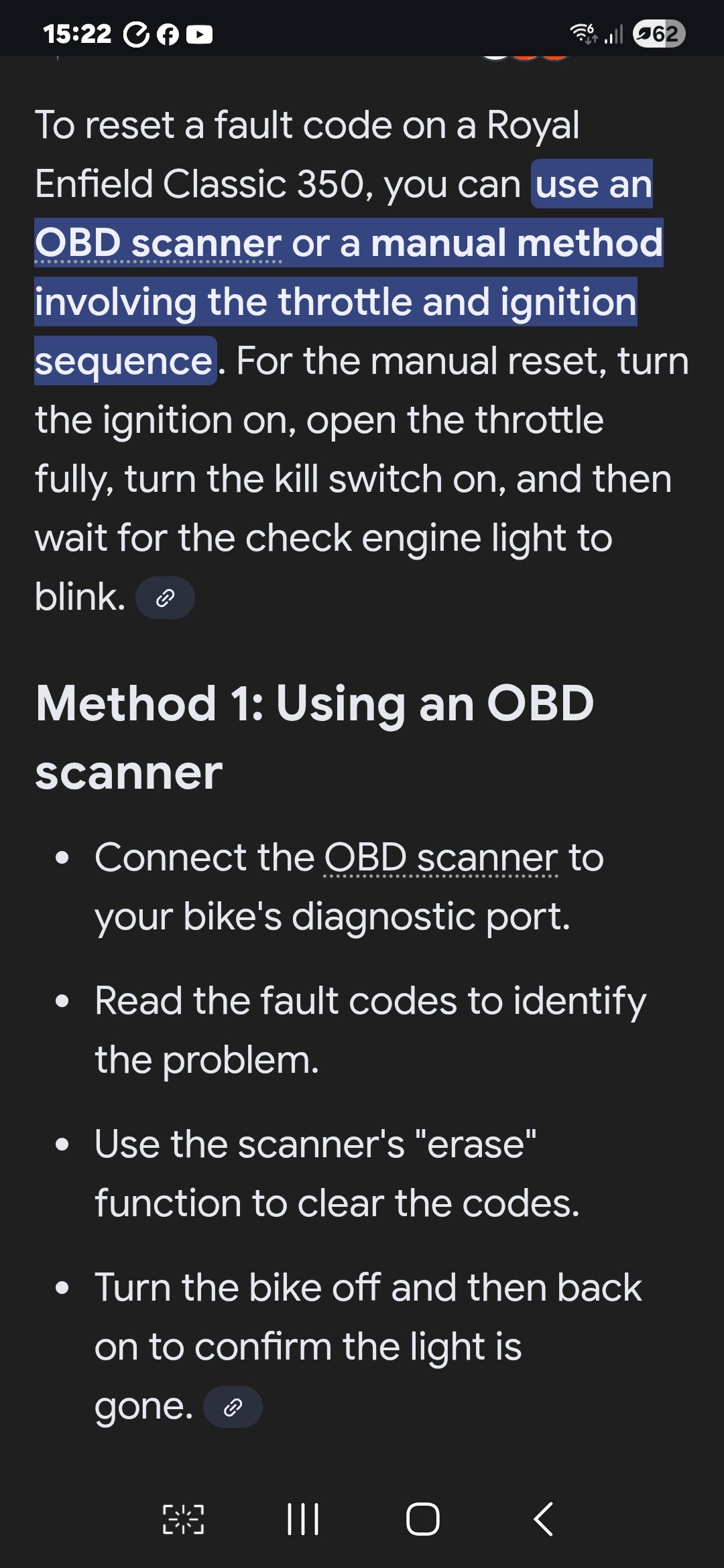

Try this,

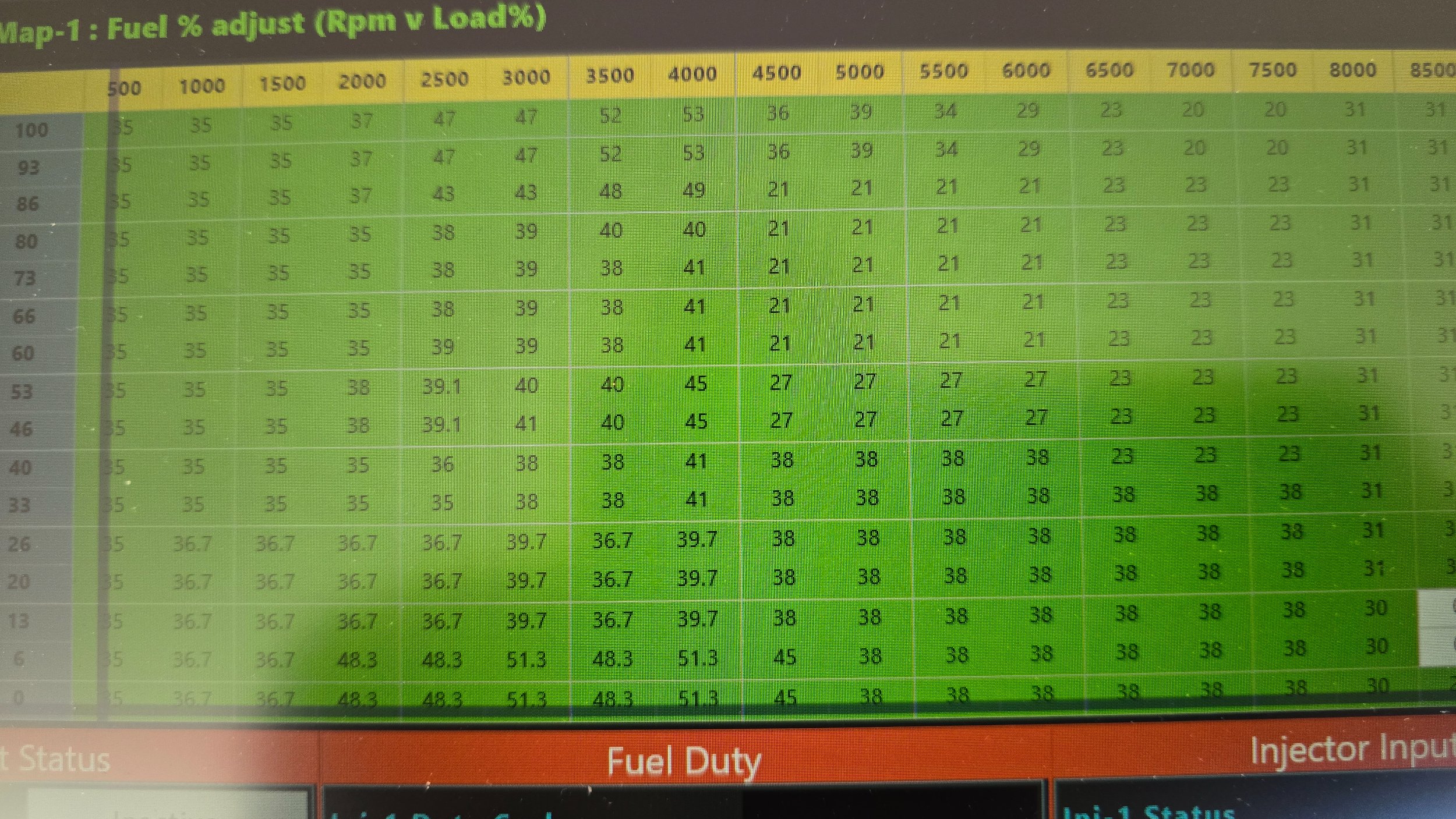

This is my latest map, zero for ignition timing.

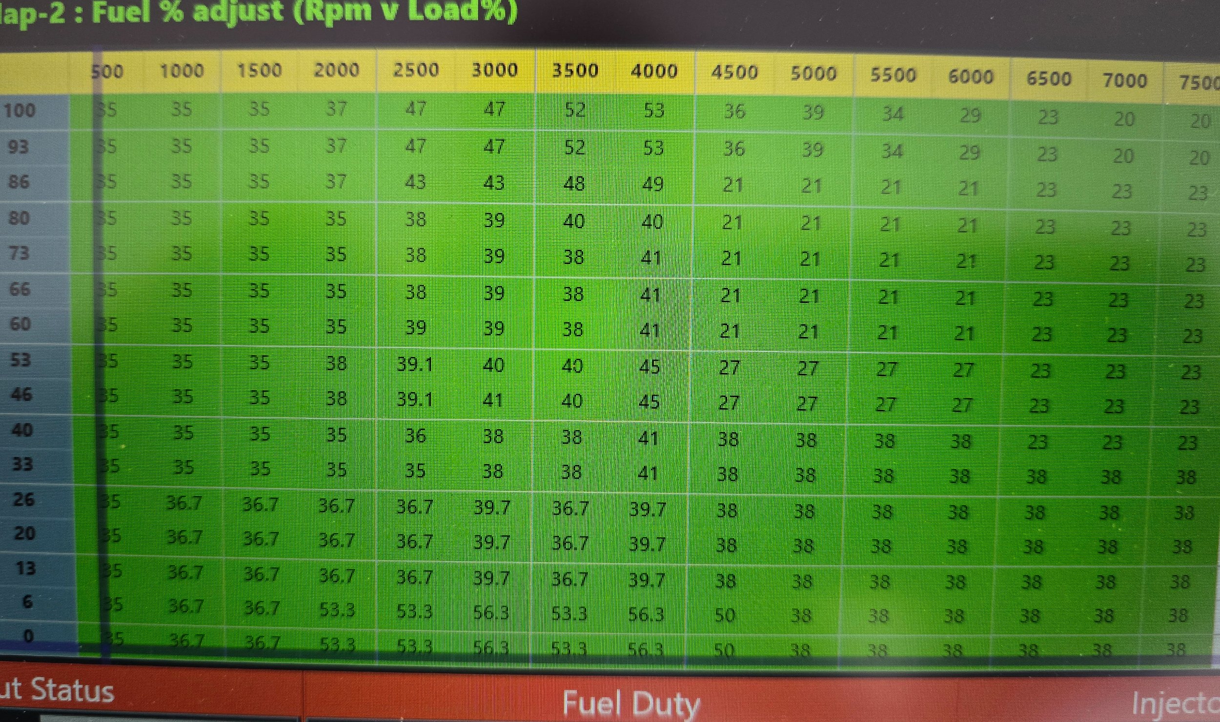

And this for Fuel,,

Try this manual reset, see if that light disappears .

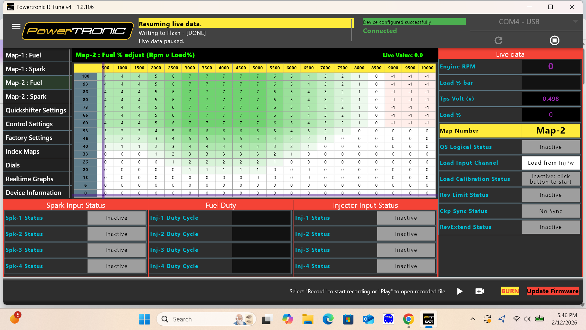

hey guys, just installed the 500 kit on a customers Goan. how do i verify if ive correctly installed the j-engine-500-dyno-cdat file? screenshot is the current map. any advice is appreciated.
That isn't the Map I generated.
Should look like this,
