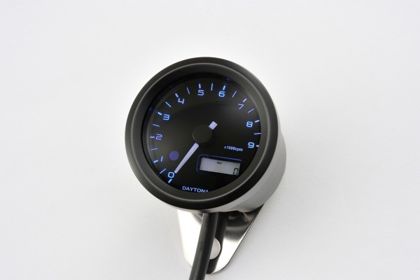

***I added a Daytona Velona - that did not work, had to send it back to the dealership. But the TORQUE app is quite sufficient

Our attempts to get this cheap 10 bucks tacho (rpm) meter to run on the Meteor have failed. There are numerous videos on YT how to install it however, they are ALL only covering carby bikes.
I have now ordered a proper USA made Tacho and hope to have more fun with that - based on the fact that a guy in Germany was able to get it to run on his Scram. But 130 Euro plus some customs once it hits India I fear, Quite a different category. But it also taps into the oil temp sensor in the head, so I do not have to get my cheap china oil temp to work where I do not know where to put the sensor.
UPDATE: crappy instrument, malfunctioned out of the box.
