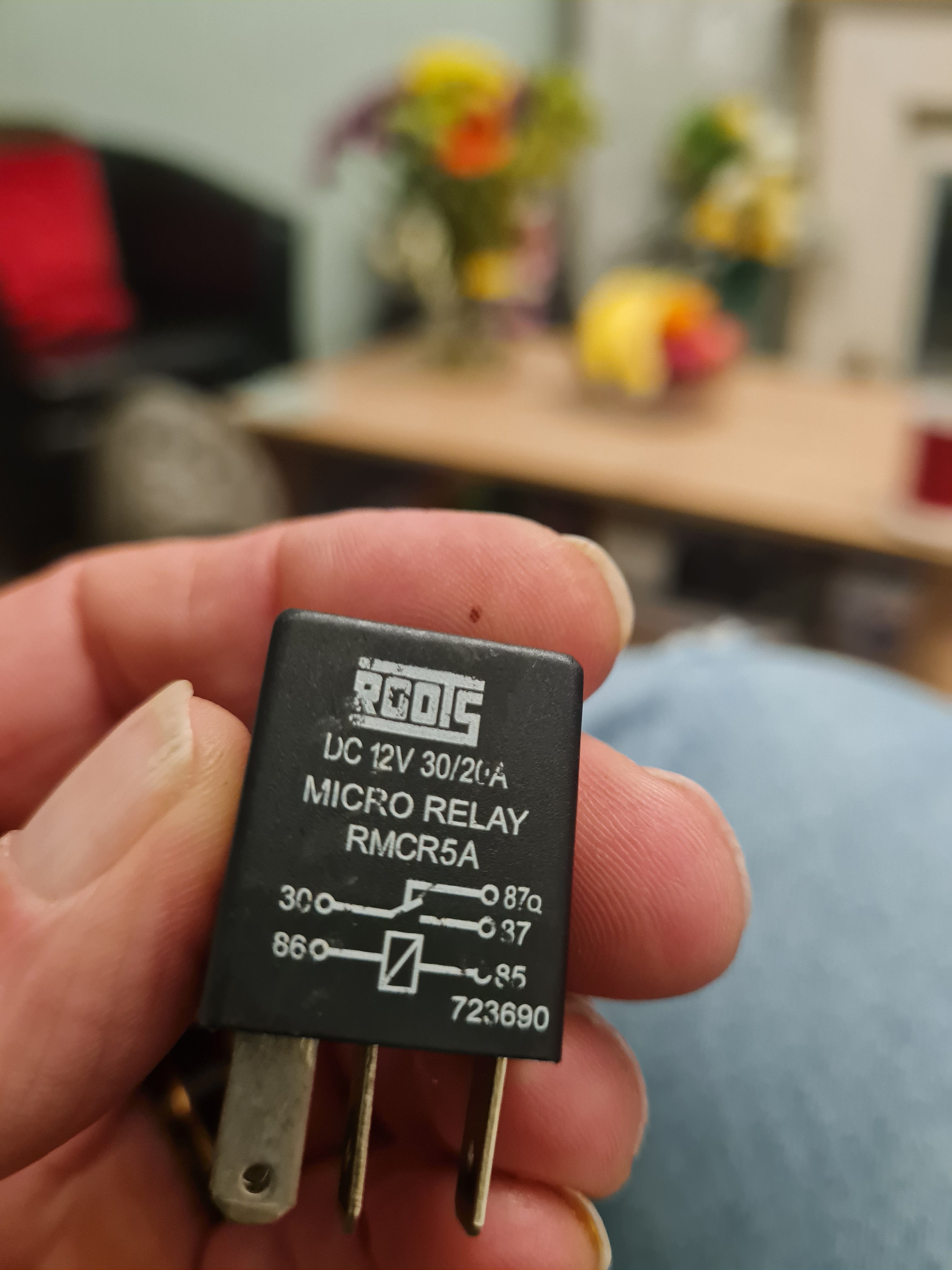

I have no idea but if you provide a picture of the relay I will inquire with RD support here in India.

This is the relay supplied with the harness. Thanks
This is what Race dynamics replied:
[16/09, 09:16] Racedynamics Help varun: Hi
This is a Spare relay given inside the kit.
[16/09, 09:16] Racedynamics Help varun: This is just for spare.
When I purchased my Powertronics ECU, it came with 2 relays, when I installed one I managed to dislodge one of the connections which caused the fault of it running only in Neutral.
I contacted PT and they were super helpful.
Mine was a Himalayan.
