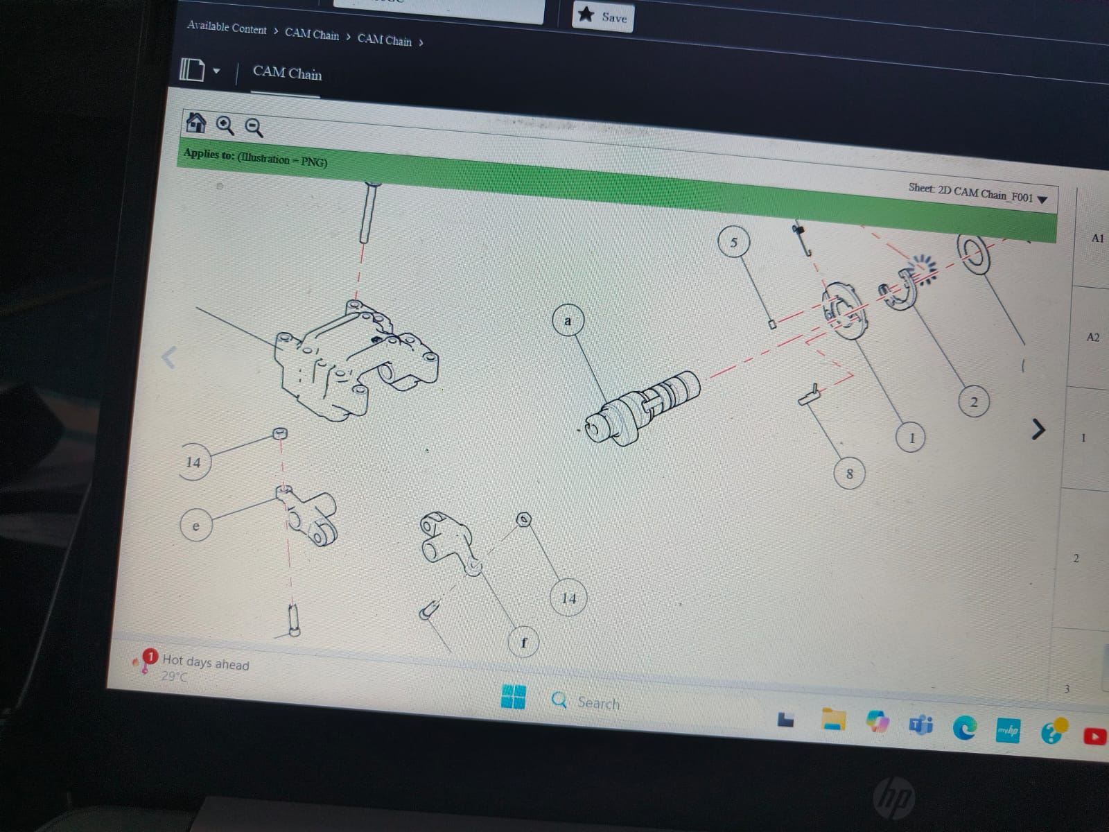

this is the sneak peek of the 440 cam parts I could gather from the notebook screen of my dealer. I hope you experts can read from it if the cam mechanism is similar to the 411. The part numbers are different.
Need to see further to the right and top of the screen, follow the broken red line to find the end of the assembly .
Part number "f" is the exhaust rocker, I can tell that.
And the Decompressor is retained.

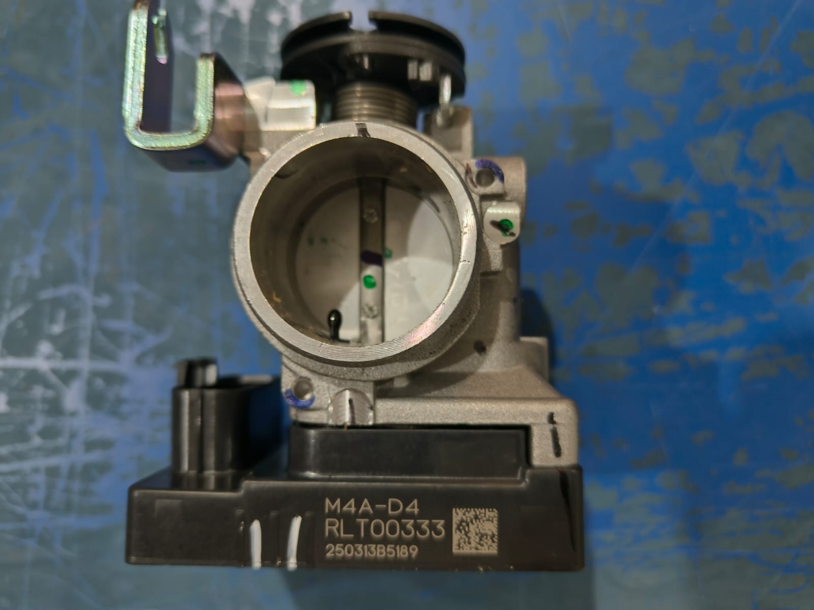

After an eternity I finally got notice that ONE of the two 440 TBs has now reached Delhi. That means our friend from Greece will be the first guinea pig for that configuration.
I was hoping to be able to fit the second to my own Hima 500 but no such luck. They say one to two more weeks but I do not hold my breath...

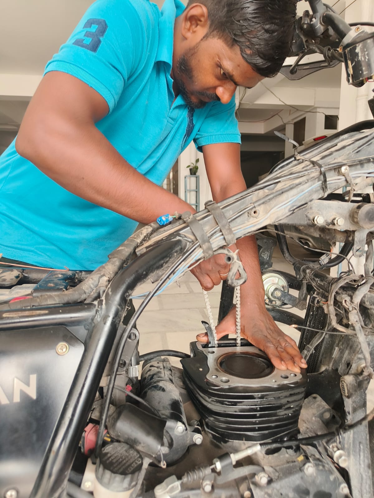

440 TB arrived, will be fitted along with a 500cc set to my BS6 Hima tomorrow, weather permitting (its rainy season and this years monsoon is no joke!)
What is the diameter?
411cc is 32mm
Mechanic is working to replace the 411 with 500cc cylinder, the 440 TB fits like hand in glove - I was a bit apprehensive bc I measured a different inside diameter from the 411 TB but the outside is the same.
That 500cc set had been used previously for about 10k km so no break in, I can do the full speed tests. This setup has the OEM cam and the OEM exhaust with cat. I m curious how it performs compared to the old setup with ht-b cam and decat exhaust.

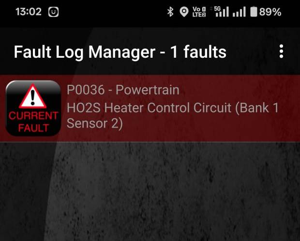

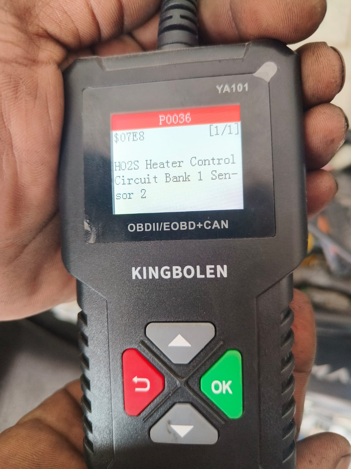

Bad news: yellow engine light on permanently. tried 2 OBD2 adapters, one bluetooth, one direct connect, both give same readout, an error I have never seen before. This error can not be deleted from memory or it will immediately re-appear, tested 2 reader and 2 sets o cables so not a hardware issue.
disconnected fuelx - same result
this is the explanation for this error:
A heater control circuit in bank 1 sensor 2 refers to the electrical circuit that controls the heating element within the downstream oxygen sensor (sensor 2) on the side of the engine containing cylinder #1 (bank 1). This heater helps the oxygen sensor reach its operating temperature quickly, allowing it to provide accurate readings to the Engine Control Module (ECM). Problems with this circuit can lead to various issues, including a lit check engine light, reduced fuel efficiency, and potentially even rough engine performance
the question is: does the Hima not have this heater OR is mine really defect?
googled a bit and apparently other with BS6 Himas have the same error coming up so maybe by some freak coincidence my o2 sensor fucked up just when I was installing the new ECU: This is from the unofficial RE forum:
I've been running with the engine fault light on (MLI) for about twenty miles now. It came on a day or so after I installed a booster plug so I naturally suspected the plug was the problem. I haven't received the Sumitomo plug to terminate the OBDII connection cable properly but I managed to get the sensor connected anyway and got the following trouble code: P0030 H02S Heater Control Circuit Bank 1 Sensor 1, which is apparently related to the oxygen sensor. I cleared the code but will have to clock a few miles to see if it comes back. I'm going to research the subject but if anybody has any ideas about the nature of the trouble I'm certainly open to suggestions.
