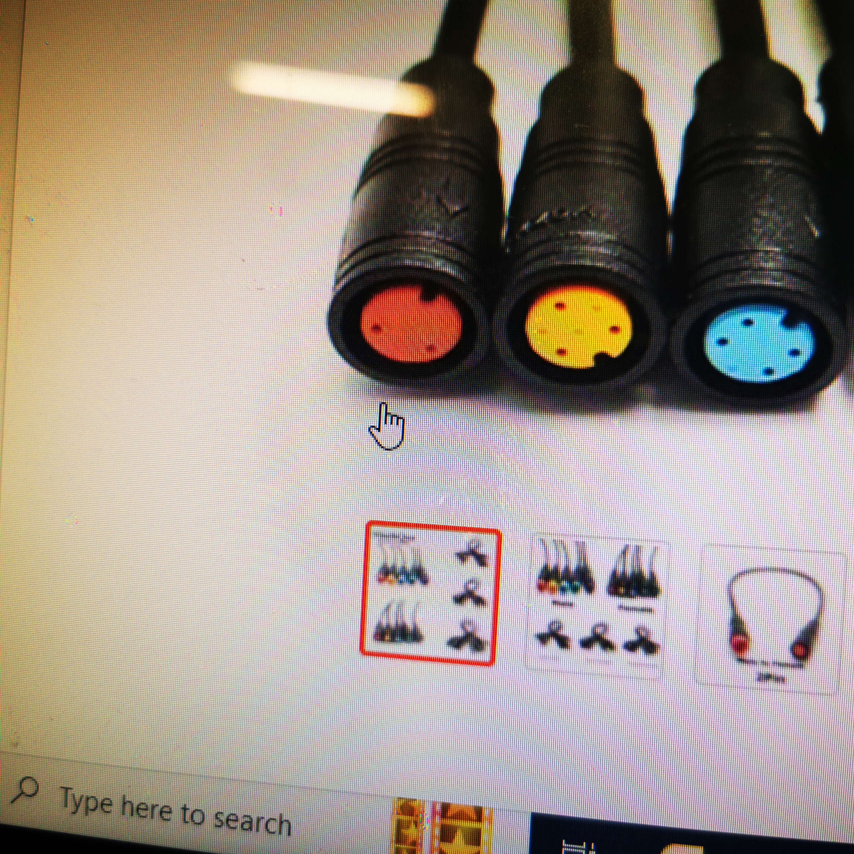

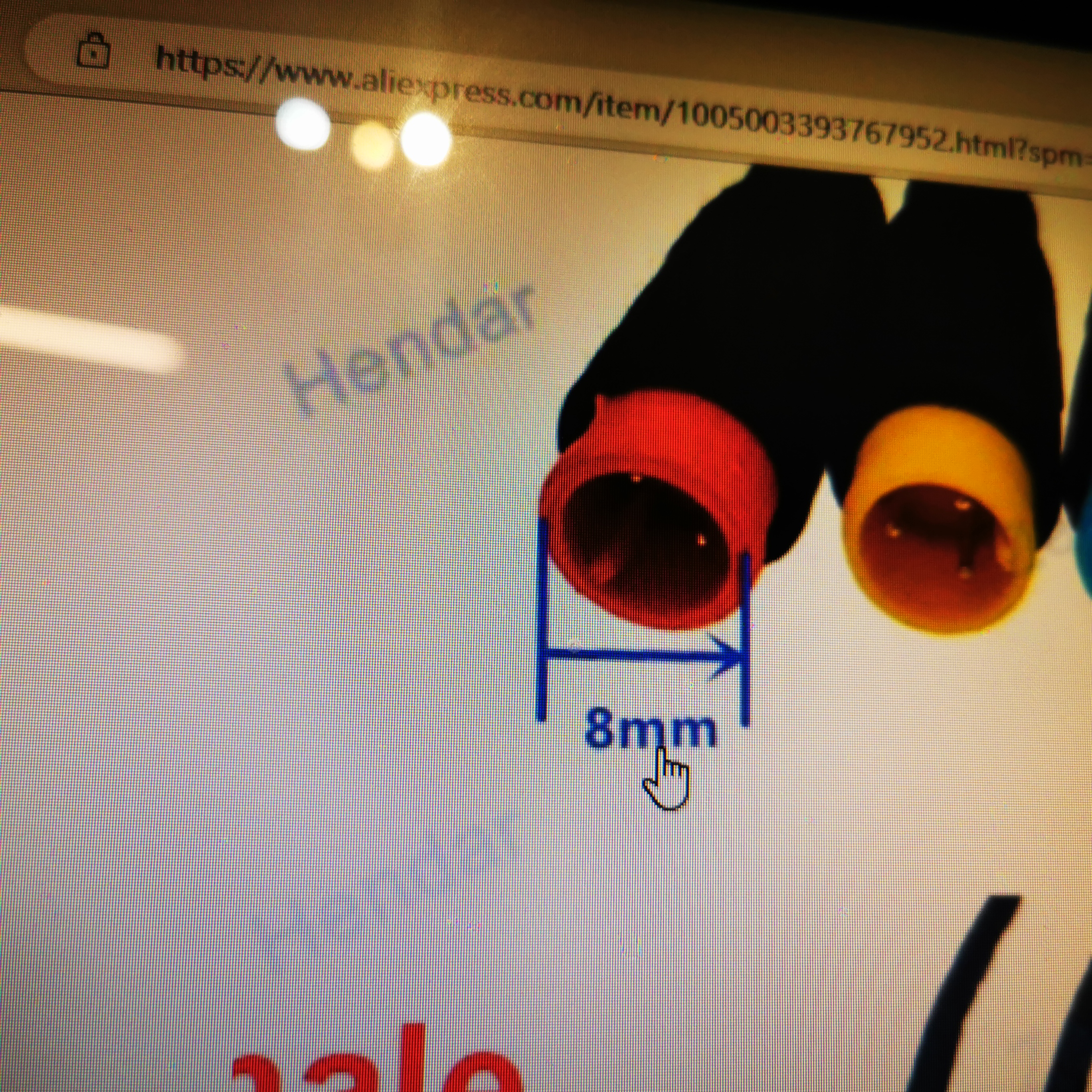

Closest I have seen, some sort of audio connector, not very helpful but all I could find on Aliexpress IMG_20230313_212509.jpgIMG_20230313_212308.jpg
the problem raises from the fact that most aftermaket turn signals are attached via a M8 hollow threaded stud. The stud is hollow to allow the passage of the two wires for the blinker.
Now the connector has to be less than 8mm in diameter (actually less than a M8 threaded hole, so 6,8mmm), otherwise it would be impossible to mount and dismount the turn signal without detaching the connector.
Closest I have seen, some sort of audio connector, not very helpful but all I could find on Aliexpress View attachment 752View attachment 753
So these connectors might be electrically good, but mechanically they won't fit. The stock connector is just the right size to pass through an M8 nut and it would be perfect, if only one would know the P/N...
