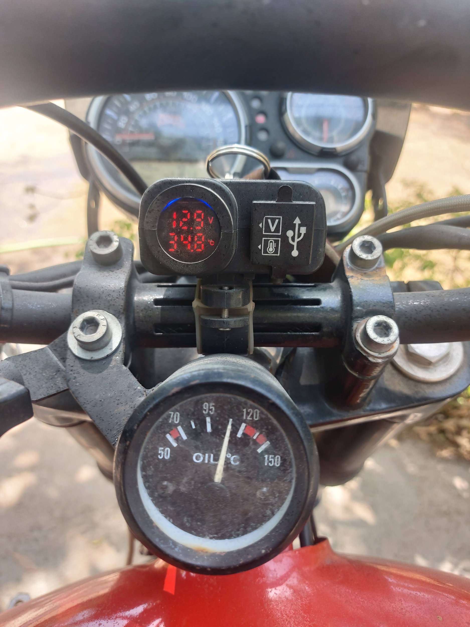

Hello guys. I bought TEC cam some time ago (1-1.5yrs) and I installed it just recently. Before I did my research on any available results and almost everyone had only praise for this modification.
I checked now and for my surprise I got a lot of informations that my engine is now probably running too hot and lean. Mainly because new cam increases air flow but that doesn't impact fueling as LS410 has narrow band O2 sensor and primitive ECU with lean map.
I have stock air filter, catalytic converter and exhaust and I don't want to change that now or in the future.
Is my AFR really that messed up after installing the cam? If yes, what are my options now?
I want to run the engine in normal temperature ranges and I also want it to be reliable and long lasting.
