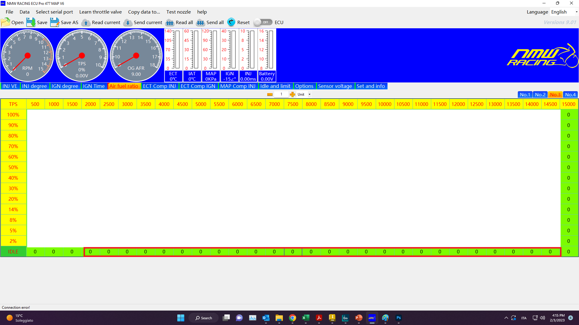

If possible I'd like to do one more test.
This implies using two maps.
One of the map shall be left as it is (say map2) the other shall be modified as per figure (say map3)
In the Air fuel ratio tab, on the map you're going to test, insert all zeroes in the idle row.
Test this map and the unmodified one in the same condition as before (rolling downhill, pull the clutch, etc...) and see if that makes a difference.
I had already noticed that o2 sensor closed loop doesn't like too much the idle row, maybe this is the reason of the cut-offs...
OK @Sasa I have put all idle values to zero on map 2 in order to compare with my daily one (3), will test plenty next Monday-Tuesday. I did notice a higher than 12 OG AFR, you mention it has to be in low 12s, mine is higher, see this pic (this was before changing values and with engine not running:
@thony numbers are normal, keep in mind that this is the AFR target WHEN you're cruising (so steady throttle). Numbers are there to make you save some fuel, but when you twist the throttle the bike comes back alive!
Anyhow yes, put zeroes on all the cell in the idle row (lowermost) and test it out! :)
