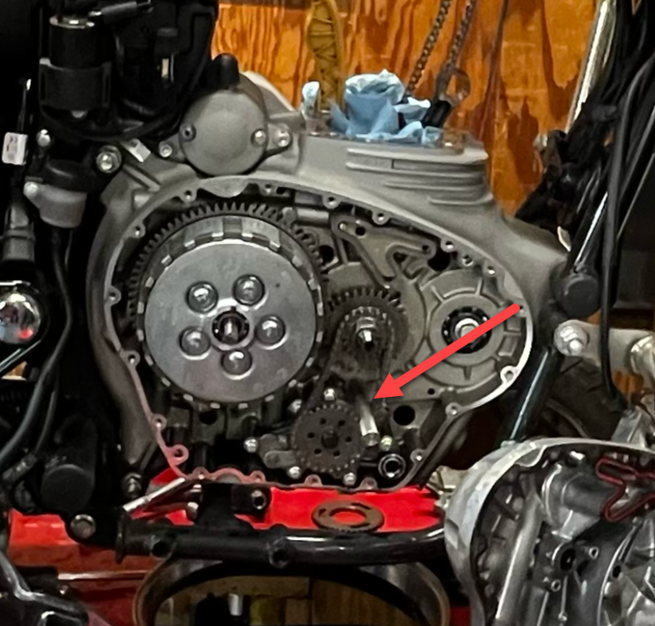

Bungy the cam chain? And miss out on hours of trying to fish it back on the crank sprocket? Where's the fun in that!Your about to get a pleasant surprise
Have you got the tools and a rh side cover gasket?
And Bungy cord to hold up the cam chain![]()
Just drop a cam carrier bolt at the very end, that's how I get my fun.Bungy the cam chain? And miss out on hours of trying to fish it back on the crank sprocket? Where's the fun in that!
