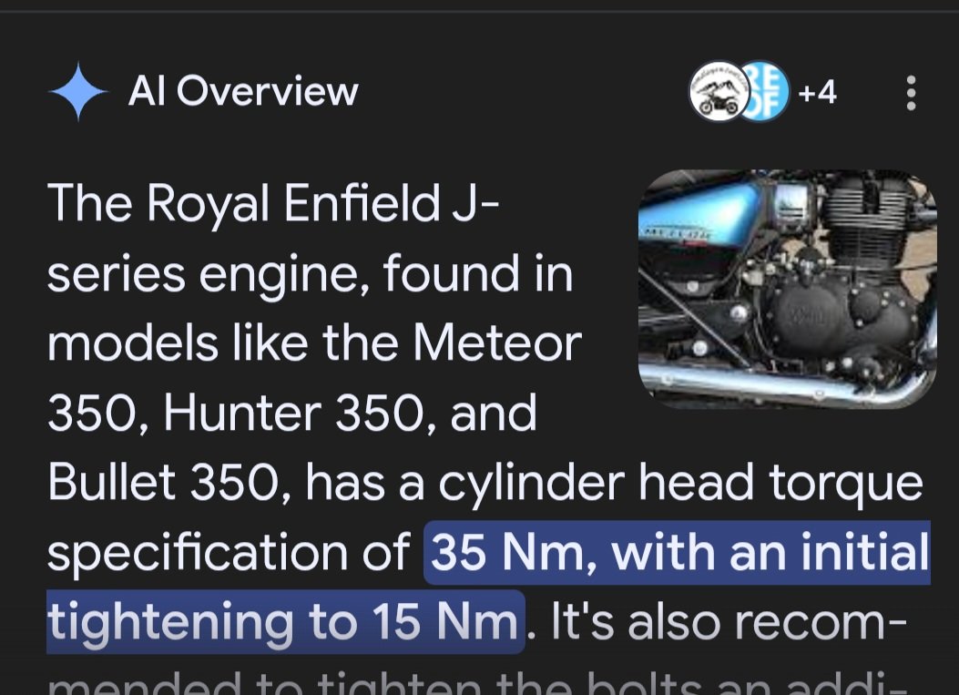

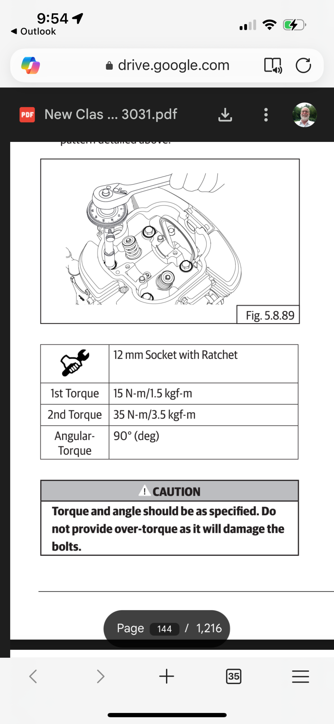

18 nm seems low, I thought it was about 40?
I have had to reuse the head bolts 3 times so far, I have a digital torque wrench and do it in stages of 5 or so and wander off for a break before returning and going up.
I got these specs from the Royal Enfield Owners Group. There was a master list posted in the Meteor, Classic, Hunter, and Bullet section. They do seem low. But since you mentioned it, I look further.
Should have gone to the service manual! Lol…
