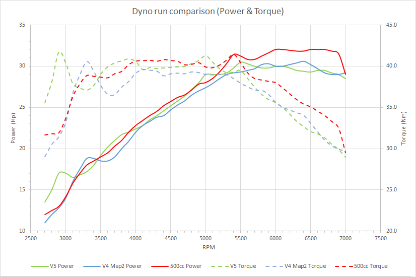

To put things in perspective I made this plot in Excel where you can see 3 sets of data:
Red Line: 500cc big bore + a bunch of other mods (please @Dool remind me what was on) and I believe PT at the time
Blue Line: 471cc big bore + HT-b cam + free flowing exhaust and filter + 34TB(?) + RB and map V4
Green Line: 477cc big bore + HT-b cam + free flowing exhaust and filter, everything else stock + RB and map V5.0 (table2 - performance).
We can safely say we are (at the moment) in 500cc territory, at least up untill 5200RPM, which should be surprising since greater displacement should provide more torque&power down low!
And this is the map you're already enjoying on your V5 file! :)
Now: is this perfect? Not yet! I've spotted a couple of glitches I could fix, in particular the torque dip between 4000 and 5000 and between 5000 and 5500! Also I'd like the torque to drop more gradually between 5500 and 7000. I think I've gone abit overboard with timing in the uppermost RPM region.
Well all these data will be crunched and trickle down the V6 version (official, not beta) which should offer a flatter and smoother torque curve!
The Blue line benefited from the 34mm as did the Red, only the green line shows the stock Throttle Body.
The 500 had Tec Cam valve and port work and the same exhaust system as all three, including Air Box delete and yes PT.
The TEC cam would explain the very high top end of the red curve and the PT the smoother power delivery, but we're not too far off...
