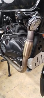

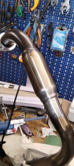

First pic , the vertical section of pipe where they put their name, has been extended? The welding makes me feel better about my own :cool:

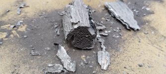

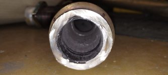

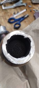

I finally removed the catalytic converter from the original pipe
I only made one cut, the catalytic converter was removed in pieces , here after wire welding and finally on the bike.
the color of the metal was reproduced using a gas torch.
I used a MAG welder with AISI 304 wire
