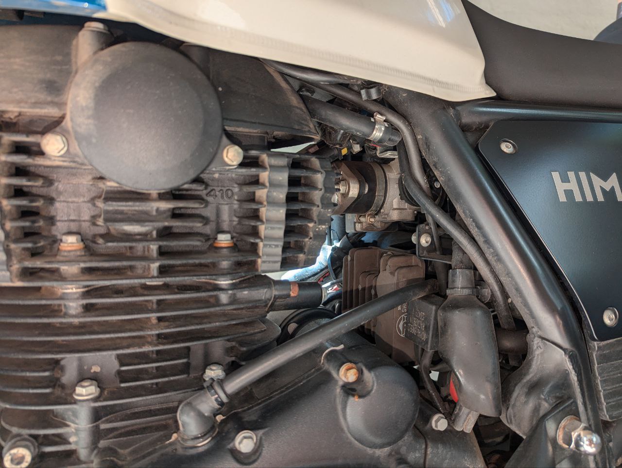

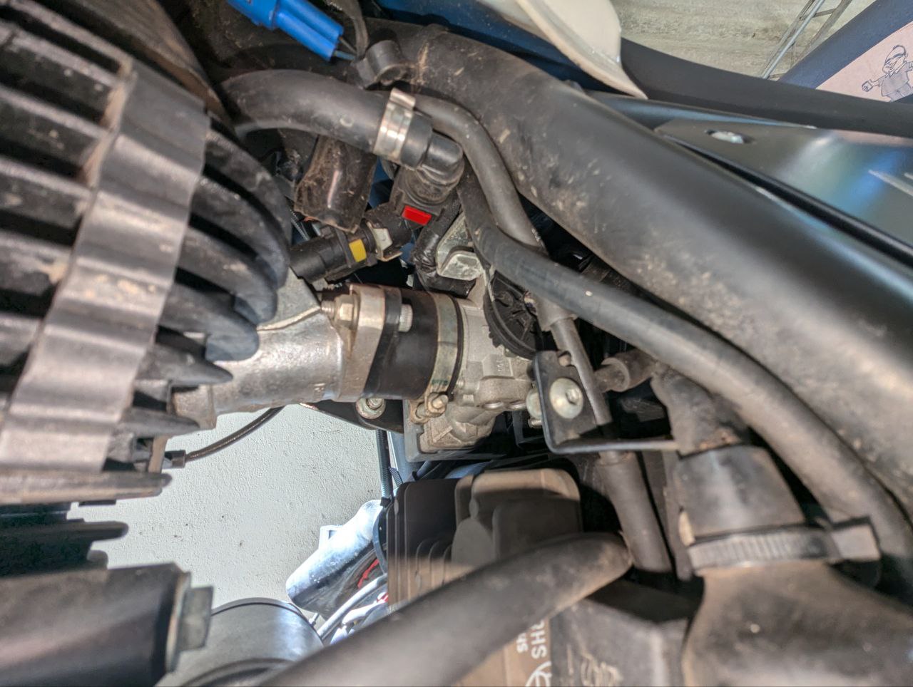

Can you take a photo of the throttle body from the left side?
Some south American delivered bikes are sold as euro 5 but use the euro 4 throttle body.
Hoping to identify the TPS .

I live in Brazil, sea level city, already tried to find the FuelX Pro around but no luck. Only older models for the BS4.
Brazilian fuel is known to be of bad quality, I only fill in ``trustable`` gas stations and the more refined fuel, unfortunately even with the high octane gas the bike also stalls. My bike have 9800km in its odometer. All the services were made by time interval in the Dealership to not void the warranty. I bought the bike in 13/April/2023, the first stall was on 20/July/2023 with merely 2000km ridden, it was during a low speed turn on 2 gear with the clutch fully engaged, the stalled with wheels rolling about 15km/h. The bike has fallen a few times during trails but no damage to the engine (engine guards) and most of the falls was due to stalling or slipping in sand/gravel.

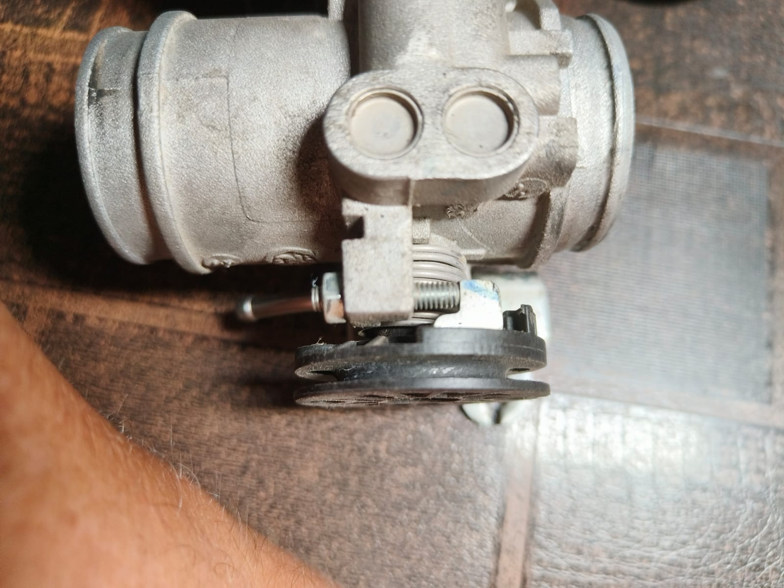

I have not been so unlucky as to come across the combined ECT/TB in the flesh.
But assuming it has an adjustable physical stop on the throttle wheel on that ecu/tb you may be able to lift the idle speed a little ,if it is anything like the older throttle bodies just a part of a turn is enough.
:cool: I only had to make the smallest adjustment there to get a problem sorted, be careful.

Do you then suggests that I slightly rise up the adjustment of the throttle wheel to slightly increase the idle speed with needing to mess with the ECU? Maybe a quarter of turn into that cork? 1/2 turn?

It will only take a very small adjustment, mine has a torx head and using the key as a clock hand I turned 10 mins max:)
It was the difference between starting sometimes and starting always but only a small adjustment did it.

I have no experience with your type of throttle body, but I would still be inclined to adjust up the idle stop position on the throttle cable wheel so that the butterfly valve is slightly more open.
