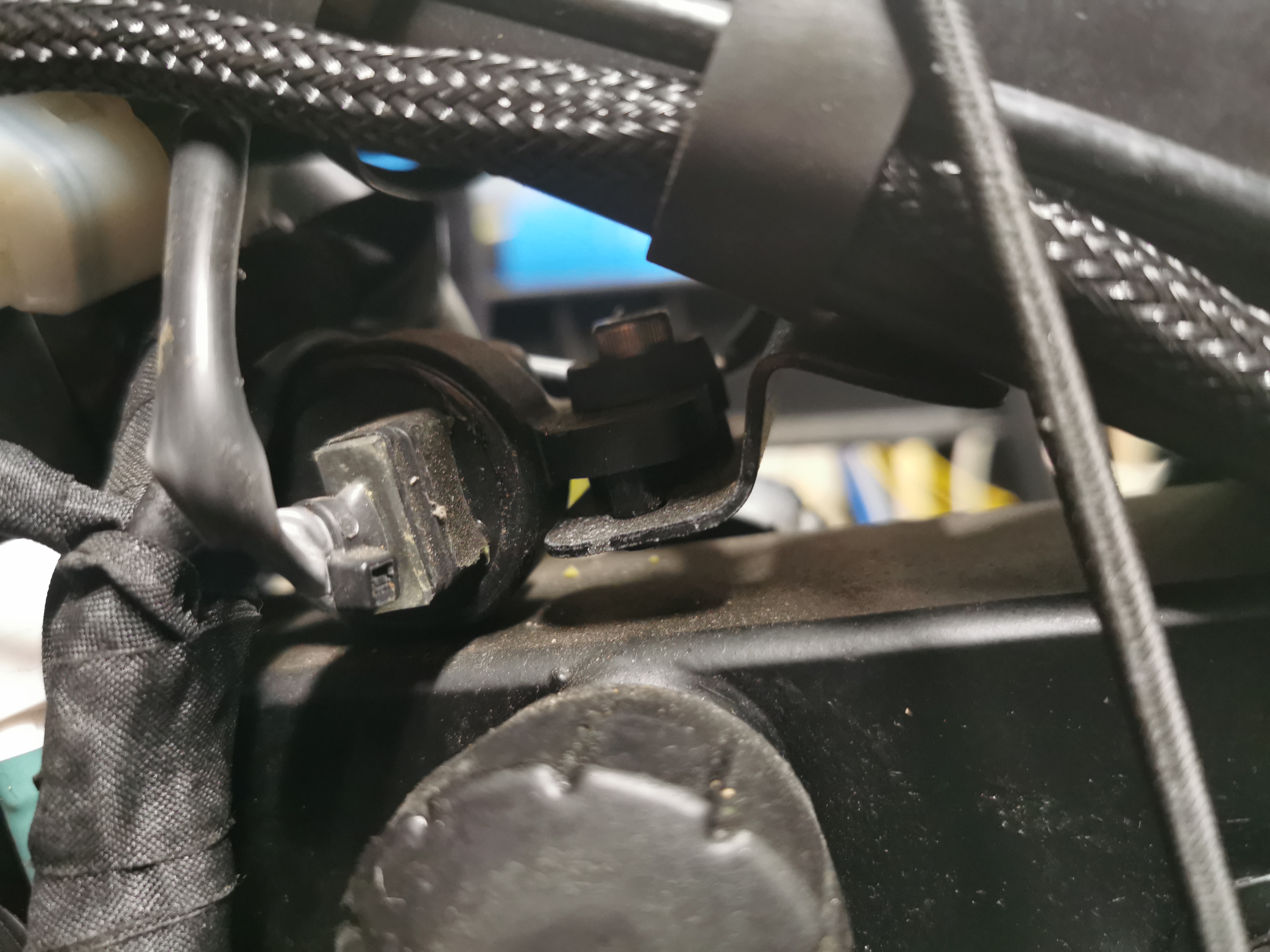

This is, the unit!
3 wires Orange, Black and white and Grey and white
It brings up a Engine light could not try running it because,,, Thead Was Off.
