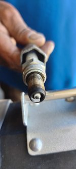

still running hot. using V1 of @Sasa map plus fuelx pro at position 10
