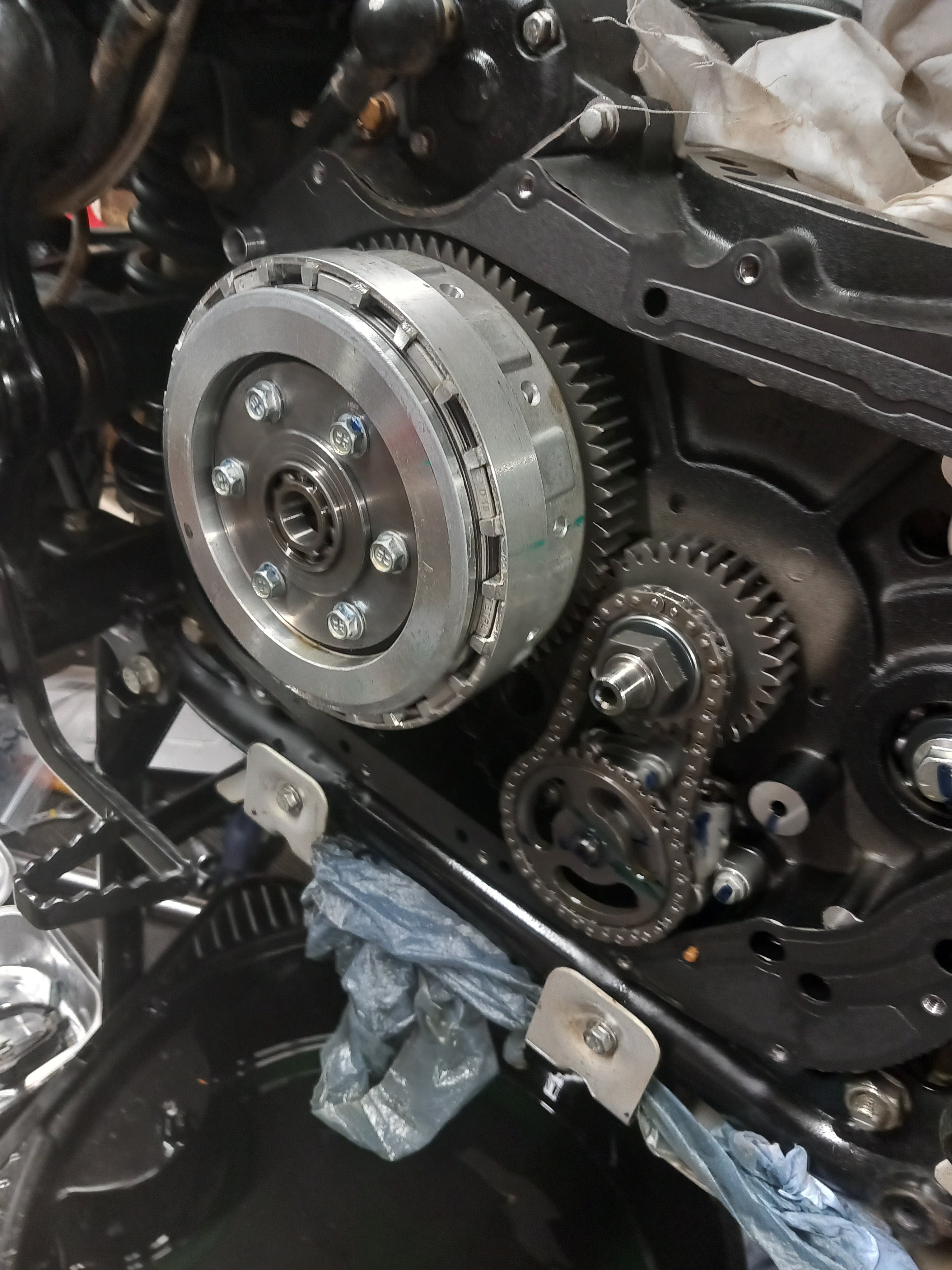

Today we changed the clutch on the "red bike". The last time we did this was around the time we also did the green bike and that can be seen in this video, that was in October 2020 and a good 15.000km earlier.
Today the clutch had the slightest of slipping - almost none. But I opted to change it as there was a time window open for it and I had been able to get my hands on new clutch plates.
This bike was run as a 477cc ever since the last clutch change (and before as a 500cc). I really do not think one needs better plates or harder springs. OEM seems just fine.
The noteworthy thing is this: in the BS6 models the metal housing has holes for the oil to penetrate. These are missing in the BS3 and BS4 models. Apparently (or so the technicians are told) this prolongs the life of the clutch plates. We just used an electric drill on our housing. Before and after pics:

About the Hitch plates:
Clutch Plate surface area, big difference plus 2 extra plates , must be a huge increase.
However: ignoring economic factors this may be a good idea, given a stock set of clutch plates costs 17 GBP (with tax) and the H. clutch is 88 GBP (with tax) and further given that stock did last nearabout 15,000km in a 477 the only reason not to use stock could be that the changing is expensive if done in a workshop. That would be a very good reason to use the H. set when doing it in the west if one does not plan to do the work oneself. Of course assuming the H. set really lasts at least double as long. Time will tell.
Changing the clutch in the Hima is fairly simple, in complexity somewhere between changing brake pads and a camshaft I would say. Most people could easily do it without any special tools as shown in our video.
