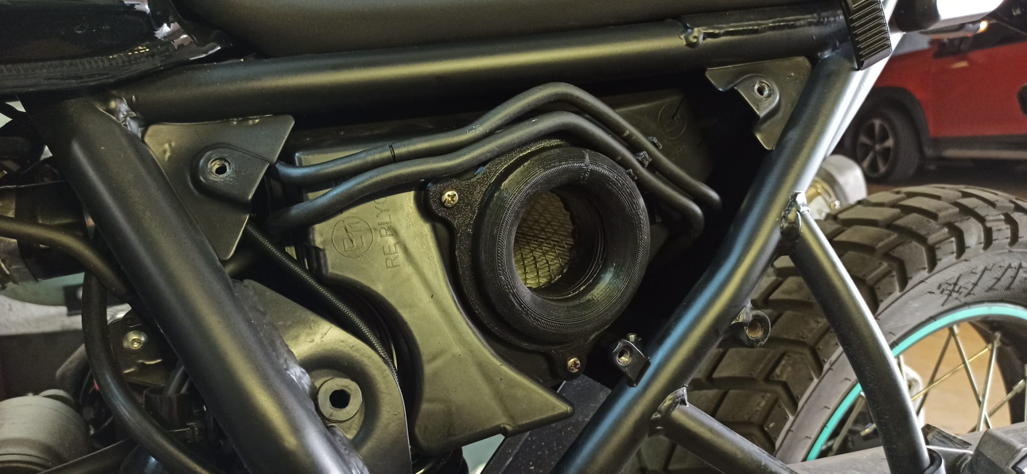

I designed and printed this new filter cover.
It is made in two pieces, to be glued, to simplify printing.
The "venturi" also has two hose stops.
If you are interested you can find the STLs HERE
Do you have any advice on this?
