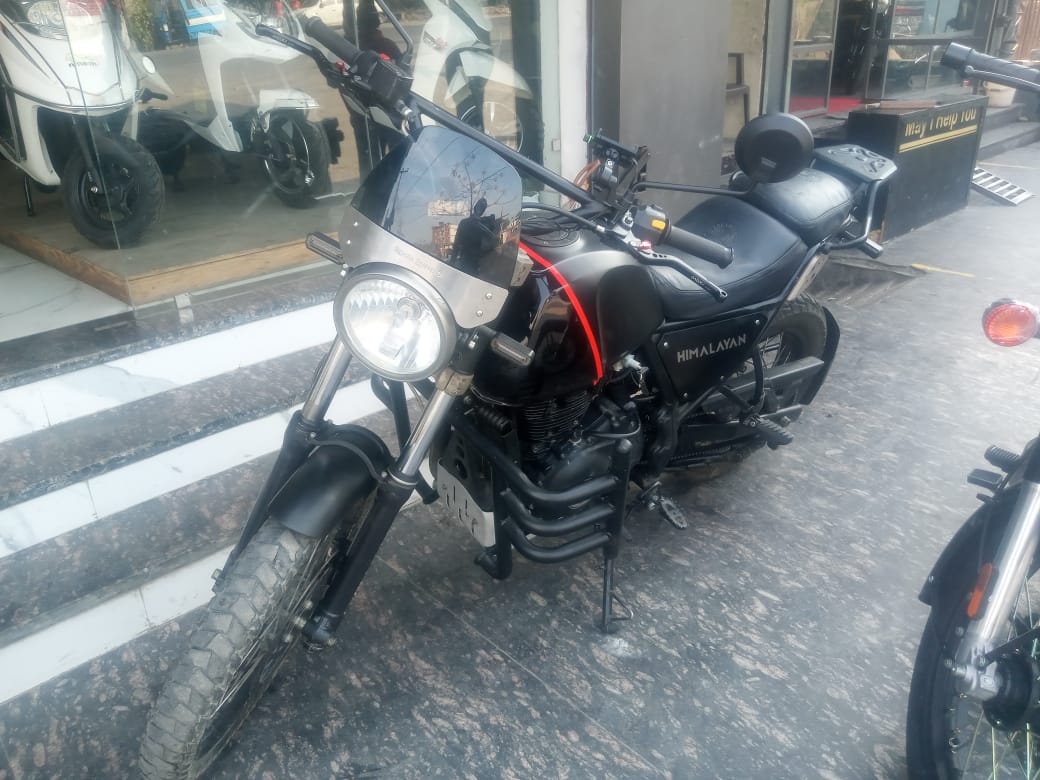

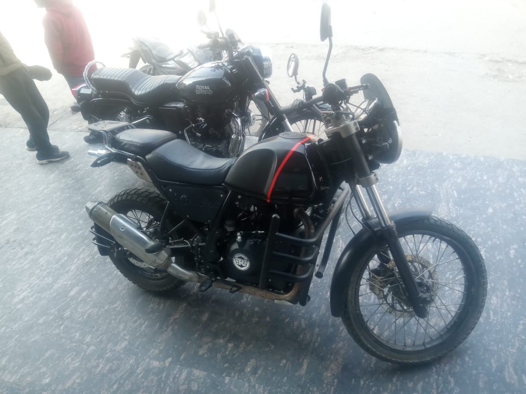

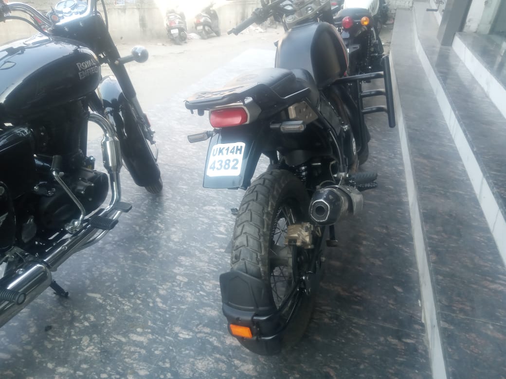

Almost done.
Foglights, Bosch horns, voltmeter + other smallish items still missing - do I need a different seat??

Wicked, that Red Line is menacing, like a Red Back Spider, would take a while to work out the Tank is Bigger. is it bigger?
I wish mine came out looking like the end of a production line,
Seat looks great, your Butt may see it a different way :ROFLMAO: blind as it is, personally I dont like passengers ( ok some exceptions ) so that does not explain why both of my bike have pillion seats.:unsure:
the tank is stock size, just new paint. I have given up on the big tank issue after my big tank developed a bubble in the paint in spite of all the extra care during production, its just not worth the effort. I do regret we never got a sizable number of people interested in the manufactured big tank.
The seat as-is was on the bike. its a nice seat with extra cushion and leather cover but I probably still put one of my long distance seats on - just looks better and probably feels better too.
