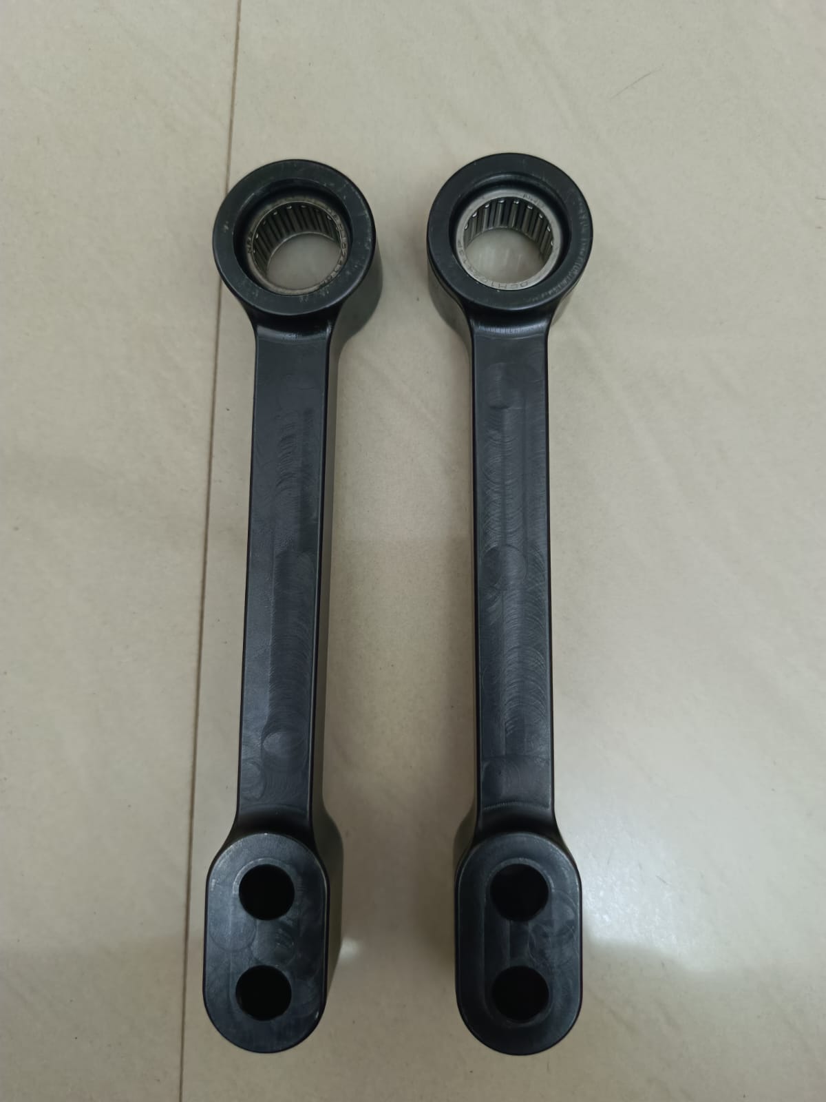

I have bought one from his first Beta batch. Once I receive it, will share the actual product image as received. If bearing for the other end is missing, they won't make sense.

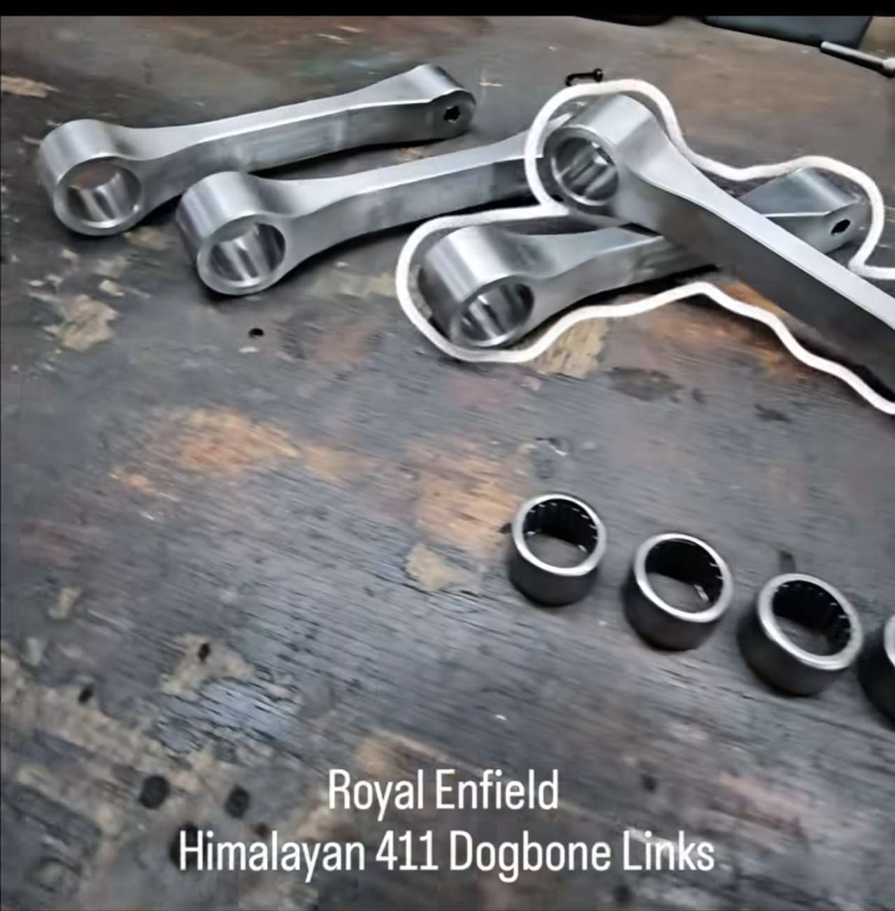

There is another Indian vendor who makes these in Chromoly steel. But cost is around 17k

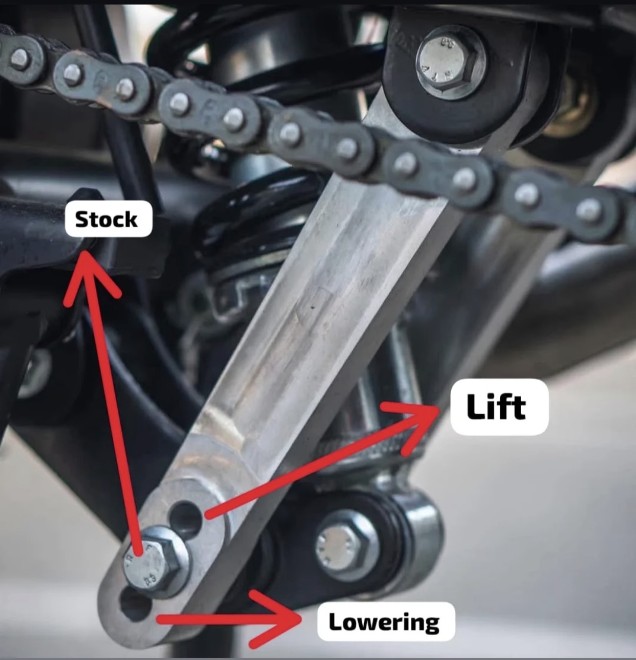

Yes, he is also testing a 3 holed one for increasing, decreasing or keeping stock ride height.

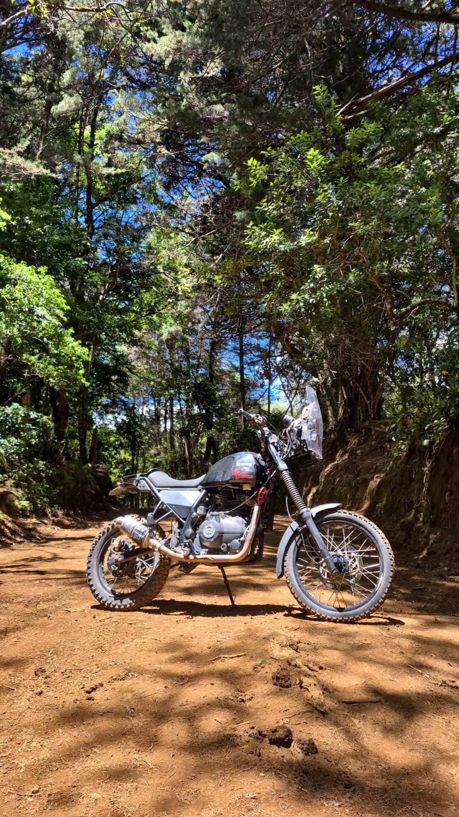

Great products, I raised my 477 4cm in the rear via shorter droplinks (without counting the extra clearence from the 18-inch rim) and 12cm in the front with parts similar to the ones above: Benefits: safer water crossings, successful enduroish sections, look. Cons: tippy toes most of the time.
Looks brilliant with the rally tower. I haven't done this because I am using the preload adjusters up front and I really don't wanna lose that.
So if I have to install the fork riser, I will at the very least need to create a spacer that is equivalent to the amount of preload I have currently setup and then install the fork risers. Haven't been able to makeup my mind for that yet..
Thanks, I have this idea of hollow spacers / risers in the front, so you can insert a longer spring made to your specs of preference and of course keep or add pre loaders.
