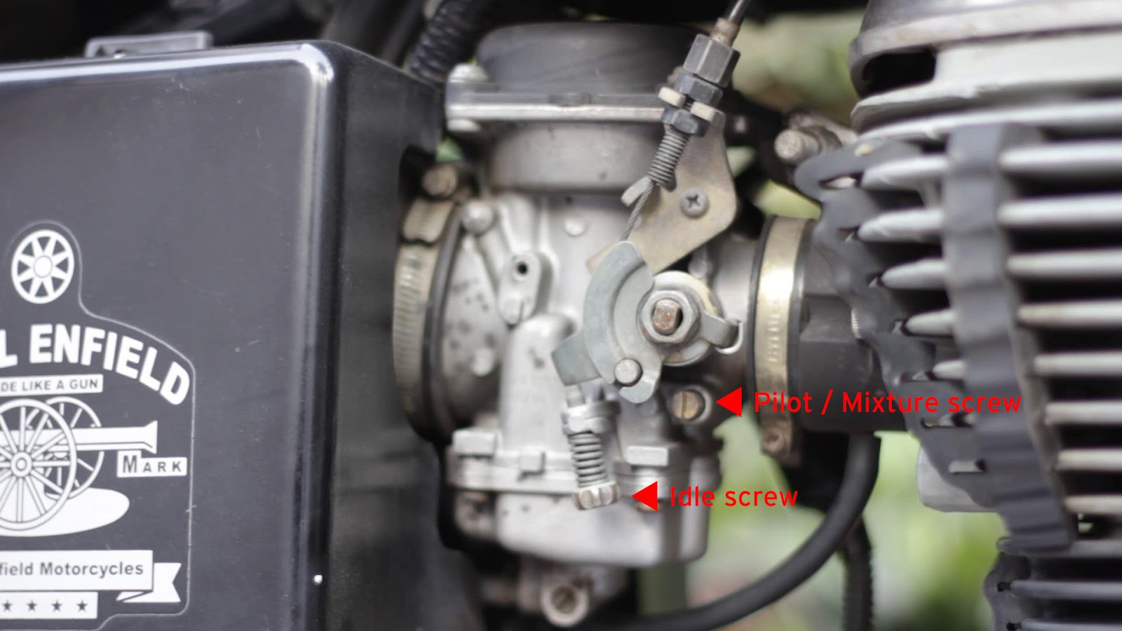

2. Before starting the tune also note down the current state of your pilot screw. Screw the pilot screw clockwise (with loose hands) till it does not screw anymore. Note the number of turns and then bring it back to its current position. Be very careful not to apply pressure at any point, or you may end up damaging the pilot screw seating. For noting the current position of the idle screw just note the number of screw threads showing above the bolt.

The picture is from a 500 Bullet but the carb is identical.
