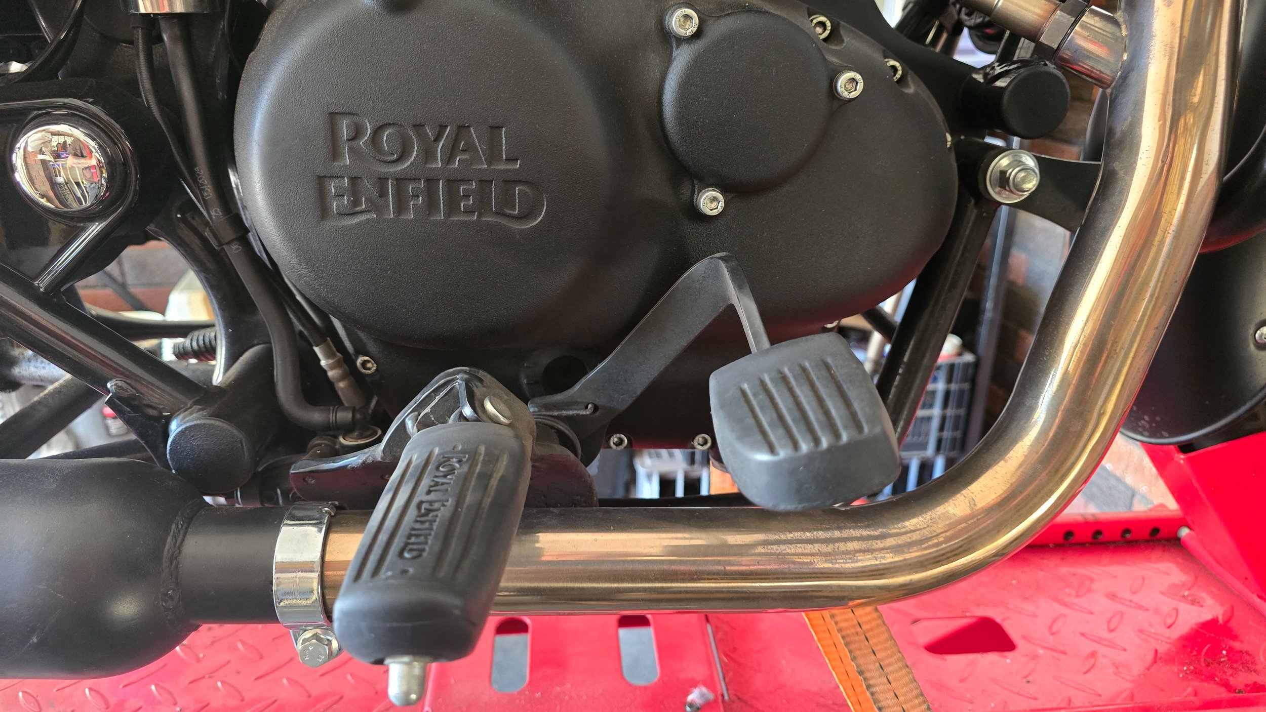

Whilst out riding on the Hwy this morning my rear brake felt odd.
No warning light just a different pedal feel.
Got home and put it on the bench to save the back.

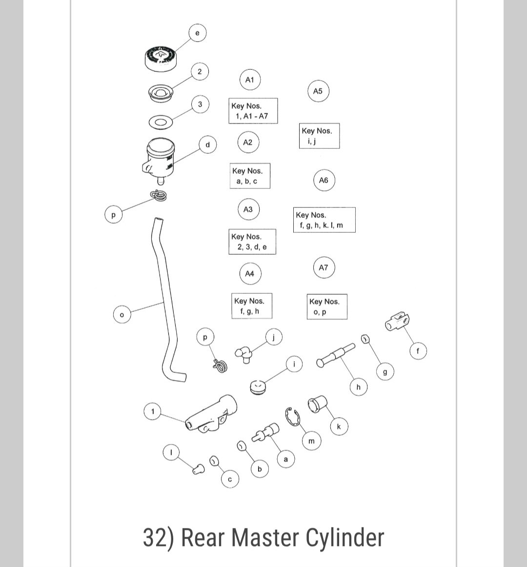

The pin that holds the clevis of the brake master cylinder had fallen out.
I was able to cut down a longer 6mm pin and fitted that with a split pin, all good!

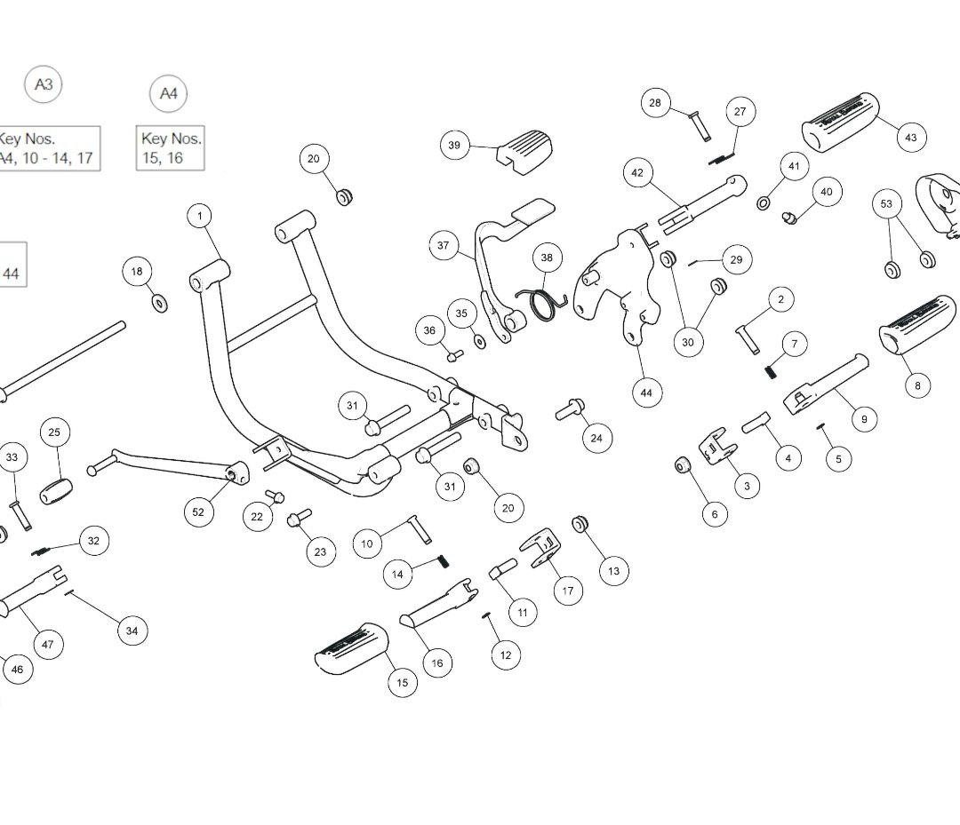

Then I went looking for the part on Hitchcock's site only to find it is not seemingly listed??
See it is too high
The "clevis" is part f on the second diagram but no pin to be seen!
