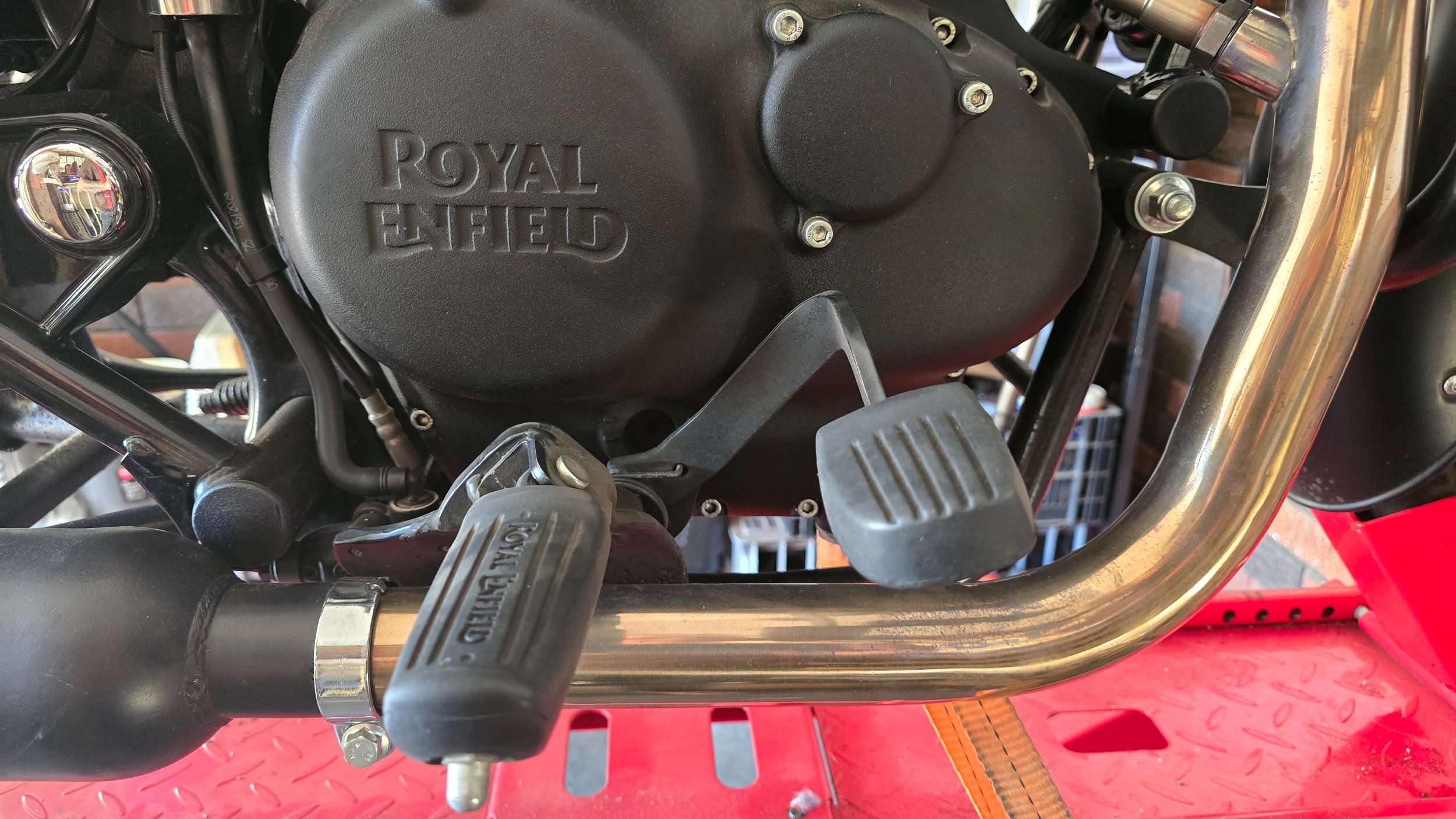

The pin that holds the clevis of the brake master cylinder had fallen out.
I was able to cut down a longer 6mm pin and fitted that with a split pin, all good!

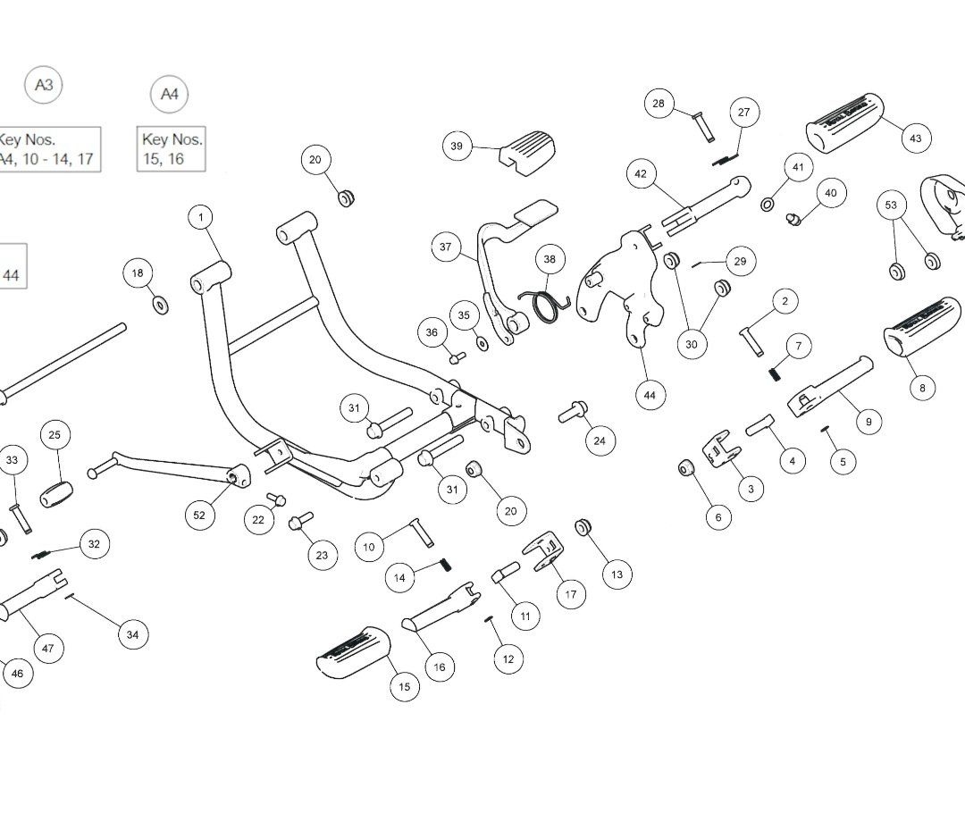

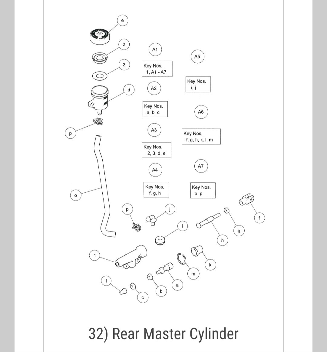

Then I went looking for the part on Hitchcock's site only to find it is not seemingly listed??
See it is too high
The "clevis" is part f on the first diagram but no pin to be seen!
It would join to part number 37 on the 2nd diagram.
See it is too high
