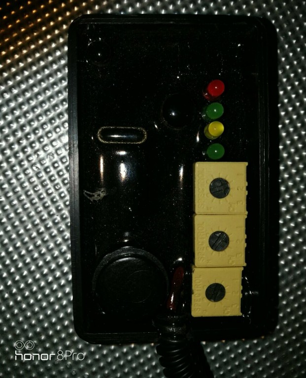

Option 3 - Moto Carronas' Tuner
- Pro: made in Italy by folks who know well the Himalayan, reportedly comes with 3 trimmers to tune work at low, medium and high rpms
- Cons: no real info about this tuner can be found around and it costs in between the Rapidbik and the FuelX

The Carronas tuner I posted in the pictures works both for BS4 and BS6. The one you had was the same model with 3 trimmers? Do you remember how you set it up? At this time Pablo just told me it works good (again only generic info, uff). Also he said he learnt how to completely reprogram the bike original ECU. But this would mean to bring him the bike, and right now I am just looking for an enricher I can easily fit on my own in the garage.

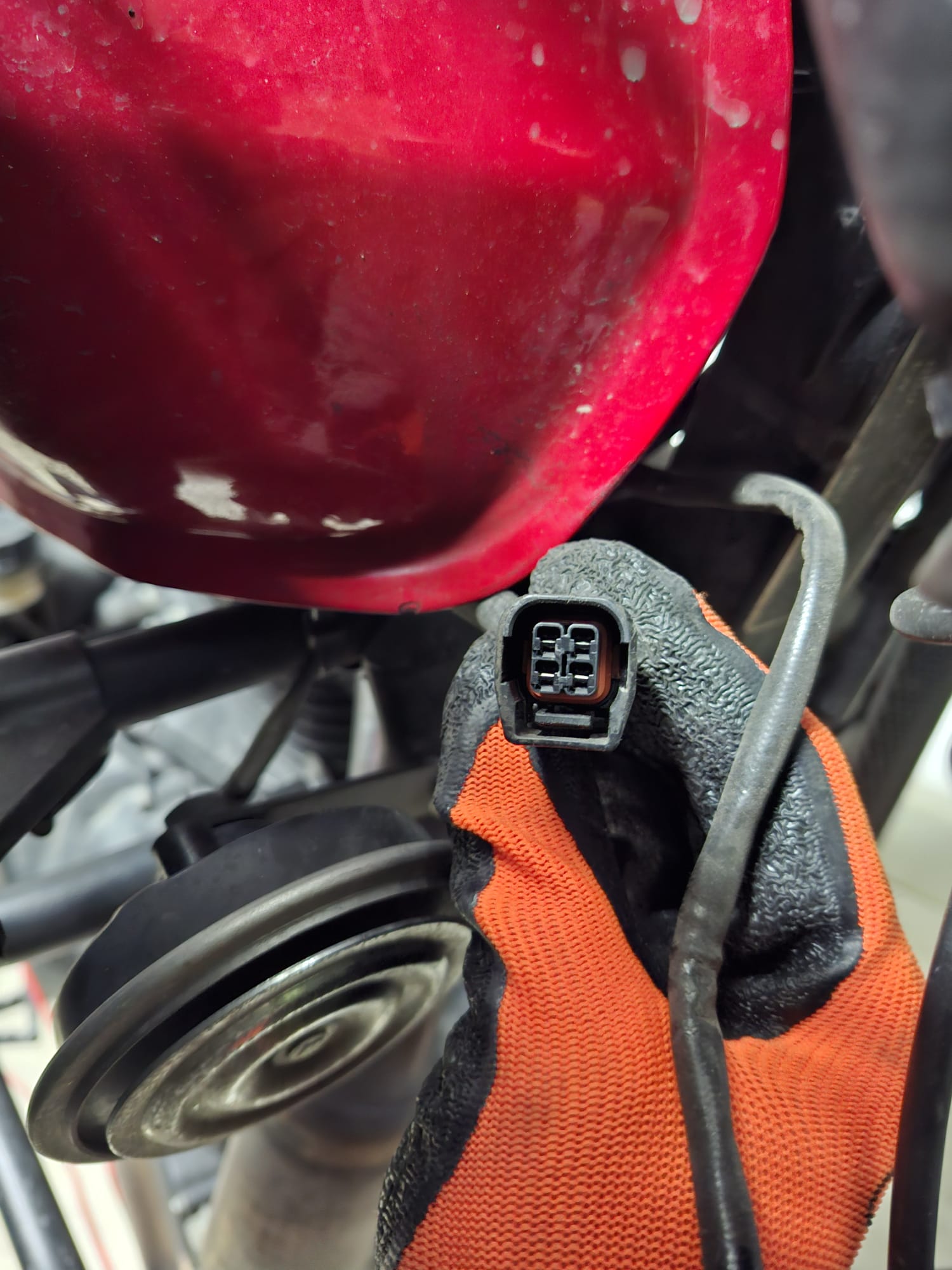

I you can send me a picture of your O2 sensor cable connector I might be able to help with a fx lite.

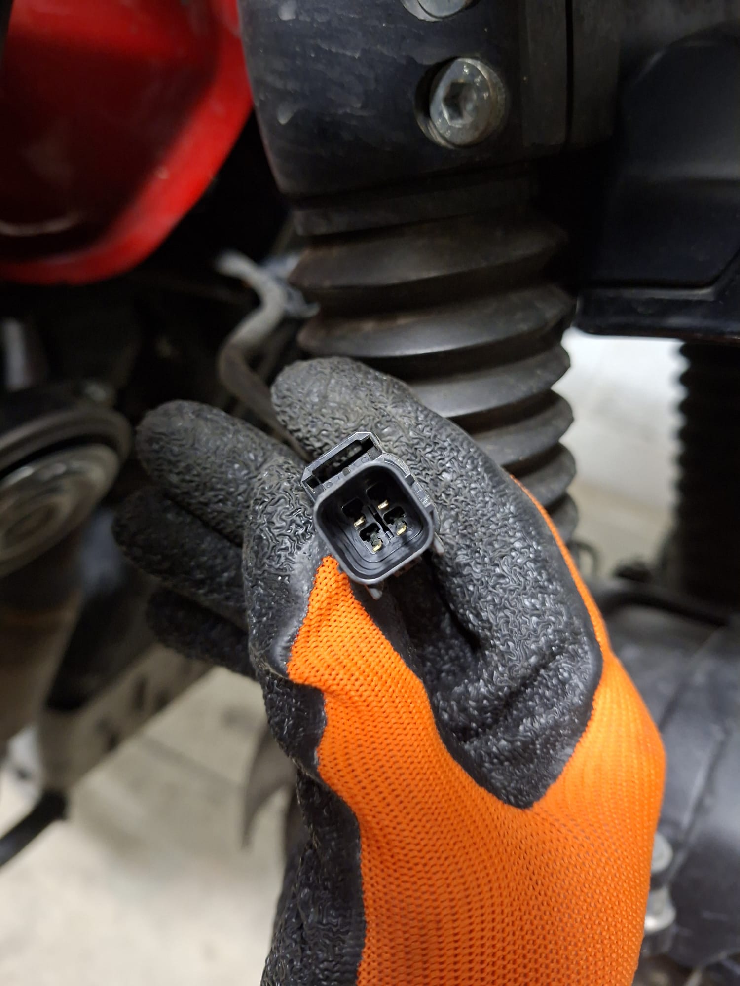

They should all be plug and play, since them being bike specific. I'll be back as soon as I can with a picture.
Here are the pictures of my O2 sensor connector

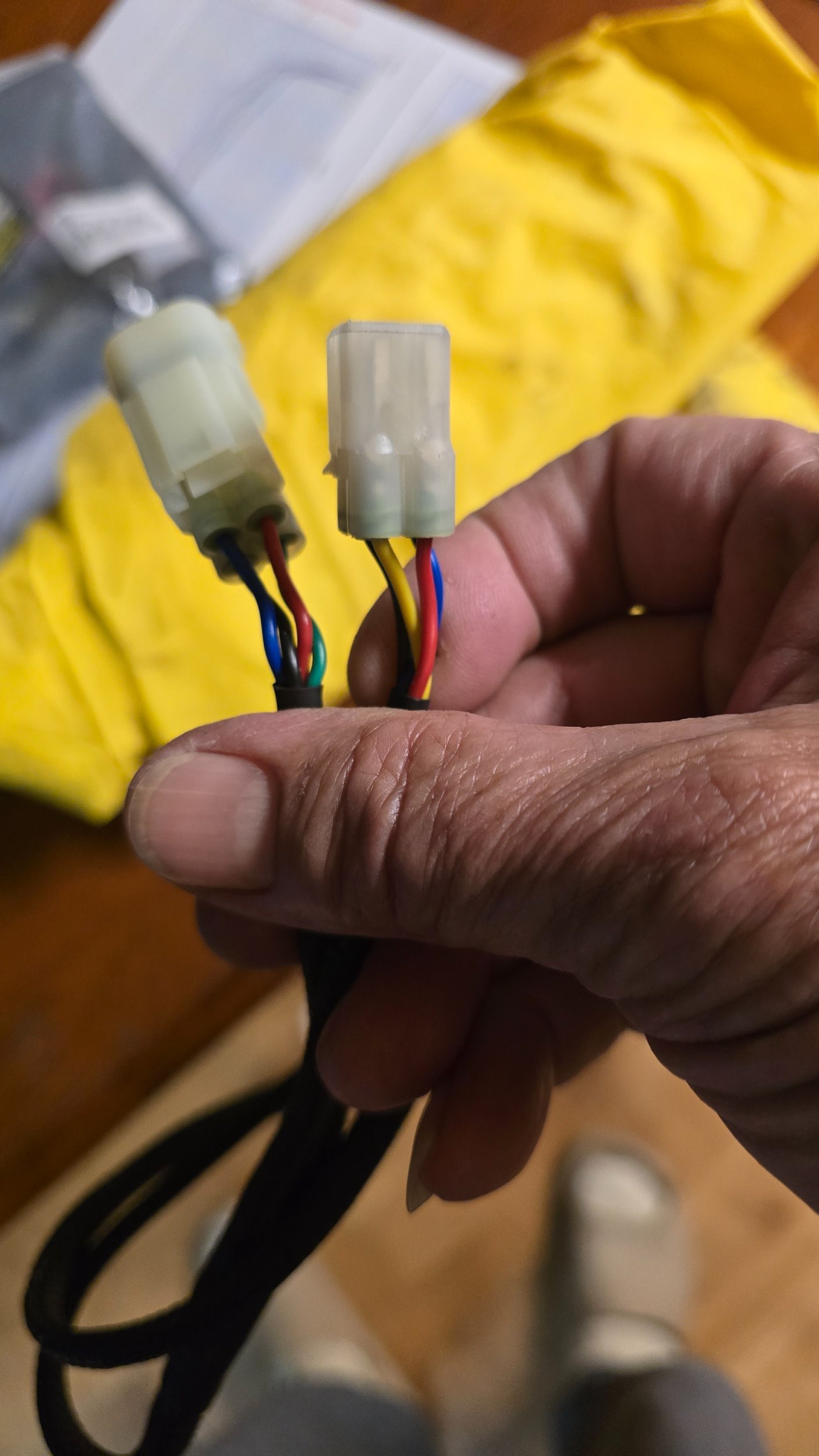

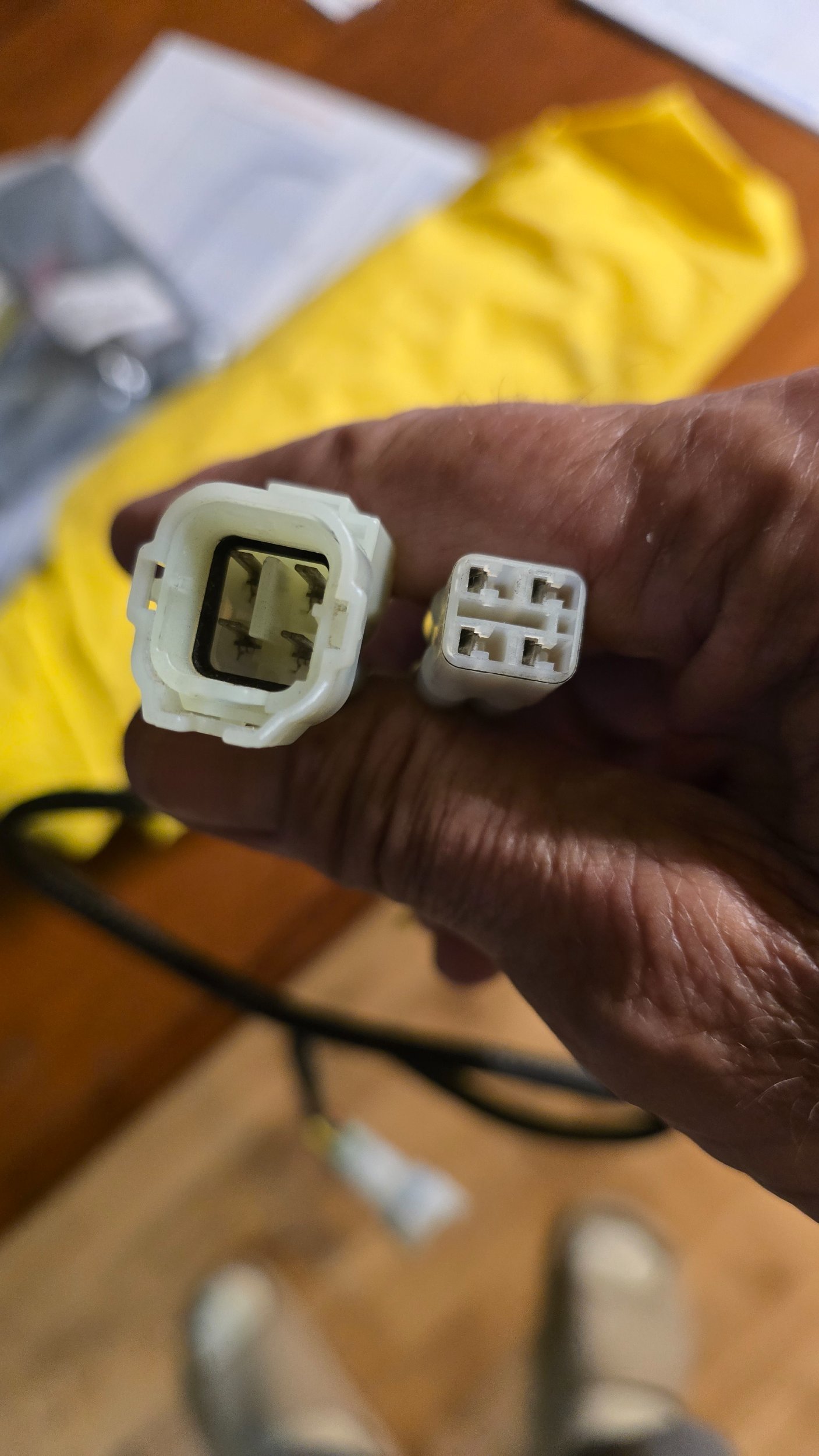

Cool, I'll send pics tomorrow of the fx I have with that connection.
All have 4 wires, the Dealer here has confirmed that the fx is all the same just different plugs for different models.

Ahh well, pics of the style I have available in pro and lite.

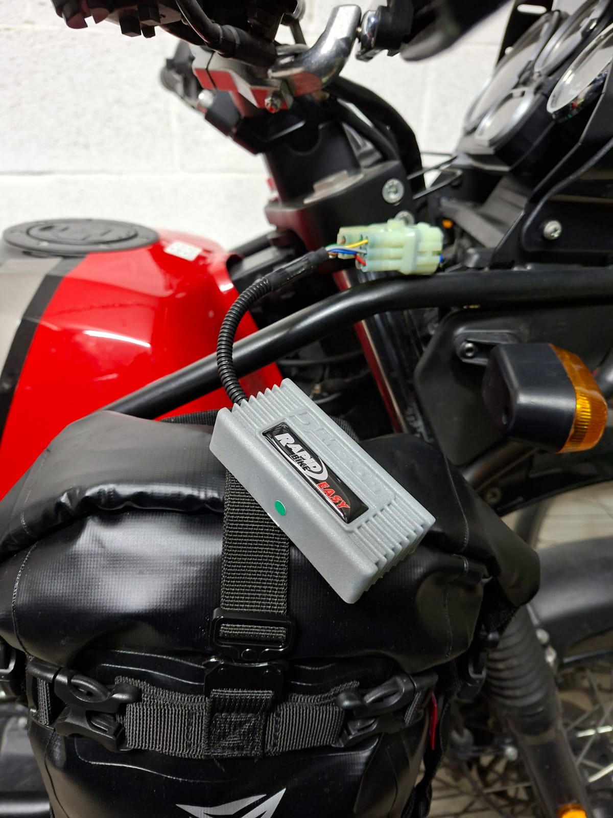

Only previous experience I have with fuel modules is the Fuelpak FP3 I had on a Harley. It run great with aftermarket mufflers and air filter. If I ain't wrong, I am almost sure it was a 6 pin connector in that case. Anyway for the Himalayan is good what we have. Not expecting miracles, just smooth out a little the power band at low regime and idle. I think it doesn't really change that much from one module to the other, in the end I went for the cheaper at my location (RapidBike Easy). I'll let you know how it goes.
Got myself one free hour on sunday evening and took the chance to install the tuner.
Installation was so easy I didn't even break a sweat, I had already set the tuner at the provided values by DimSport (which would be setting 6 & fuel ratio +2 for both the Euro V Himalayan 2021-2023 and many model of Piaggio and Vespa 125, 150 and 300) so I just had to do the wirings.
It could be worth to mention the tuner seems to be the same for all the bikes, since it's up to the owner to set the trimmers for his ride. The many kit you'll find around only add the specific connectors to fit the same tuner to that specific motorcycle. So, if by any chance you happen to find a second hand RapidBike Easy, you could grab it for cheap and then go to DimSport to buy just the specific connectors you'll be missing.
After being connected, the tuner should green light when you give power to cockpit, then start blinking green after few minutes you run the engine. At that point you can screw the tuner rear cover on and find the better place to store it on the bike.
And that was the hardest part. First time I've been pulling the fuel tank (not hard at all, but that left me with some questions about things I've whitnessed or not under the tank) and connectors are not that long actually: I didn't make it to go around the tank rubber mounts down to under the rider seat.
In the end the tuner is not huge, I managed to store it under the tank above the throttle body. Unfortunately I couldn't test it on the road yet, and I'll be away from home all week. At idle it sounded to be more... tiger-ish 🐯

So the connection was made to the O2 sensor only?
Had a short ride to the sea with my wife, just 50 km but you can tell already at idle and low revs the bike is really smoothed out a lot.
It seems before installing the RapidBike I suffered hiccups when playing with the clutch in traffic. I thought it was the bike personality, but since this roughness is now gone, I understand it was just bad tuned or poor fueling.
Also had no stalling, they were rare before already, so I might need a little more test time before calling these gone too. Environmental temperature is raising too, so it would be better to test in cold winter. At one time in traffic the revs dropped a lot but the engine managed to stay alive, so it's already a confidence inspiring result.
