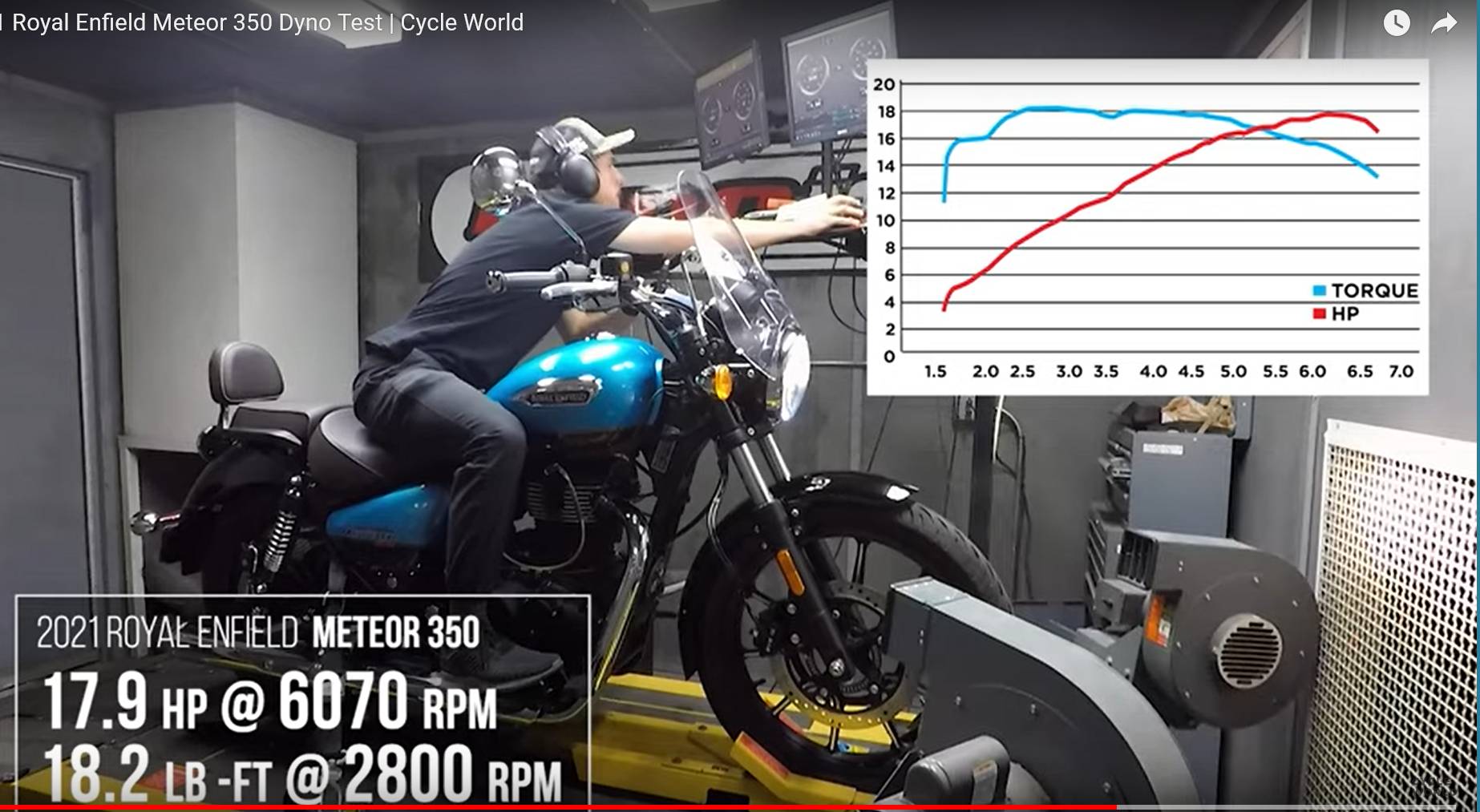

This was done to show the effectiveness of a slip on exhaust (negligible) but it is interesting to see the RWHP as being 16.26 only.
It would be interesting to see it done with a complete new system.
From what I have seen the header pipe also has a cancerous tumor looking attachment that hides behind the engine, a straight thru pipe needs to be found.

and one more:
seems right, torque is flat, I like it, but 50% more would be interesting.
