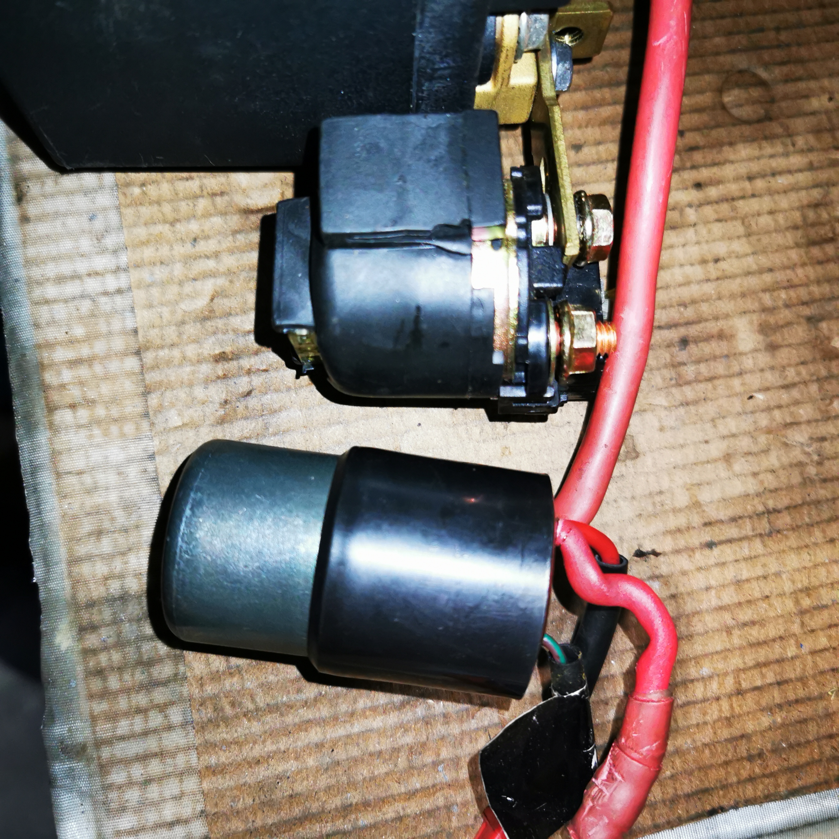

just finished stage 1
No emergency starter, just the bare minimum.
Seems a bit better than before which was not very good:)IMG_20230430_223632.jpg
I made the Relay a bit lighter, decided I didn't need the extra fuse and outlets!
This enabled me to solder the wires to the terminals and exit at a better angle.
1.3mm! if this was soldered I think it would be well sufficient for the task, but being unsoldered they will suffer from corrosion, all the more reason to do a Job on it.

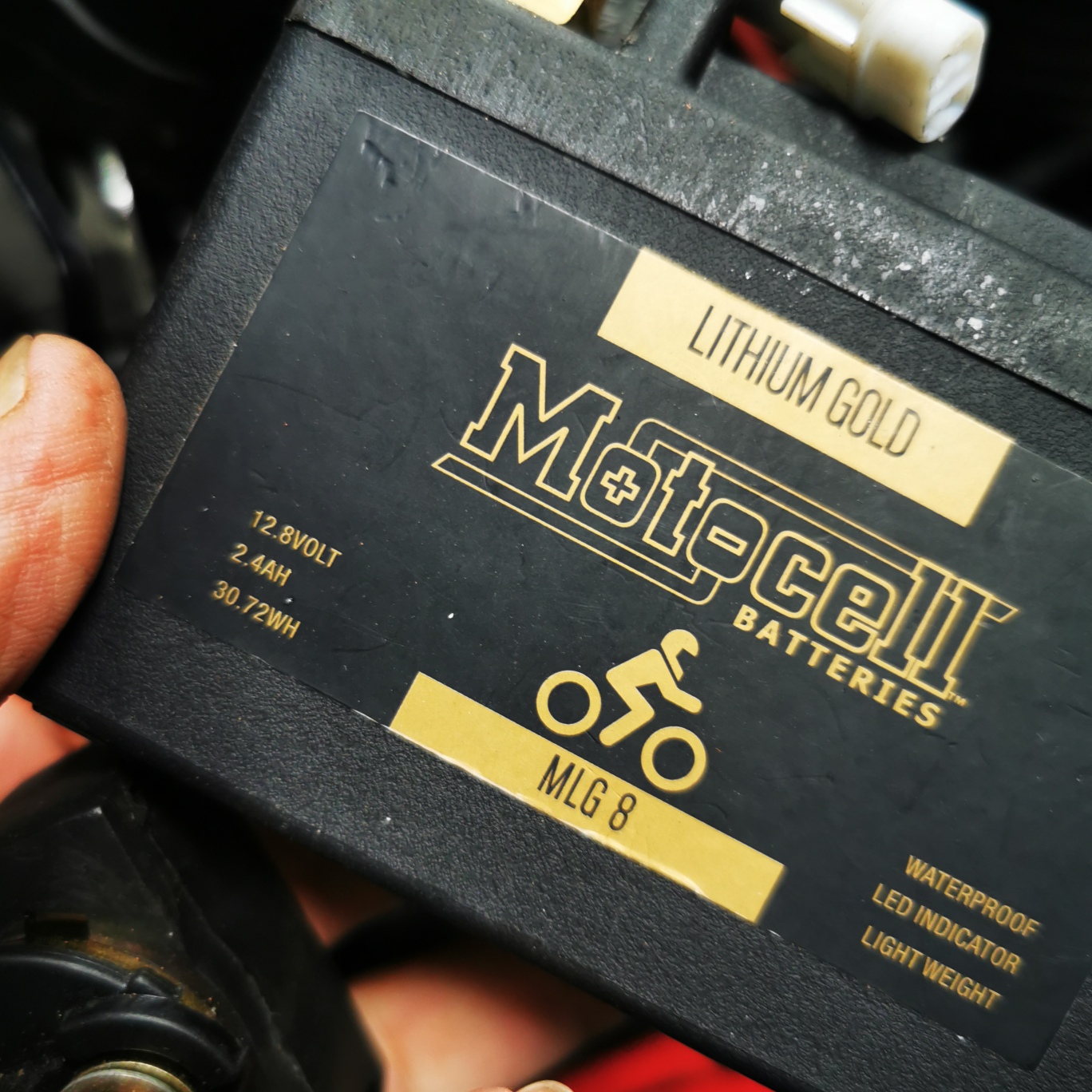

So far I am happy with the Modification to the Starter System, I am no longer stuck at TDC, it has the Grunt to get over it now, it seems.
Early days and I may fit a Decompressor Cam soon anyhow!
I have been able to start every time I wanted too so far:geek: Proving the "shitty little Battery" ( man it is light ! ) can do the Job, I am not sure if I would recommend this Battery ( a Sponsorship could change my opinion ) But it does save space and weight and has the Power to turn over a High Compression Himalayan:giggle:
Good to hear! I’m not totally sold on this battery technology for motorcycles yet but if it works long term it’s a win. I sure like the weight and size of them.
These Batteries do not like hard work!, they want to do it Quick and they have the High Volts but not the Reserve IMO.
But on Space and Weight they WIN!

The Starter Relay I have used is common enough, we have all seen them, I was looking for a better quality and water proof version when I found this. Could be interesting.
Might be big enough?
Cant complain about the price!

This could be a Fail again, the starter Relay held in and the starter did not release on 2 occasions, perhaps the relay is back to front?
I will wait until the new unit arrives and fit that the way it is intended, just in case ;)
Relay shouldn't have an orientation.
I tried mine and works both ways... 🤷‍♂️
Maybe the battery was a little tired?
