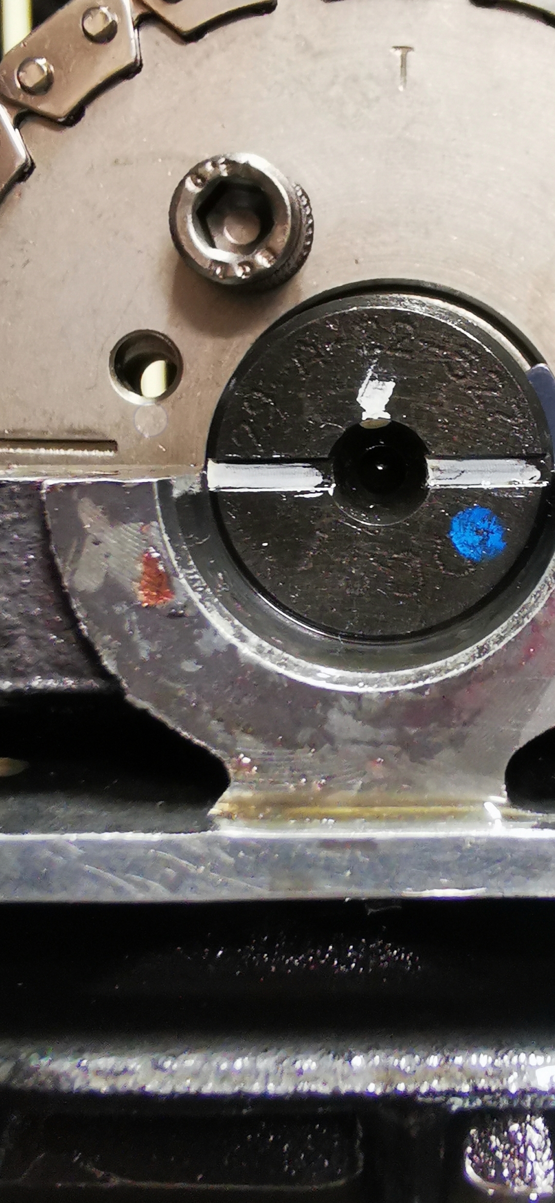

Timing the Cam was made M8M10-M20stainless possible with my new Cam sprocket, after lifting the Barrel, changing to a longer chain etc the marks did not line up.
Look in the hole where the pin would normally be, that's how much adjustment was needed :)

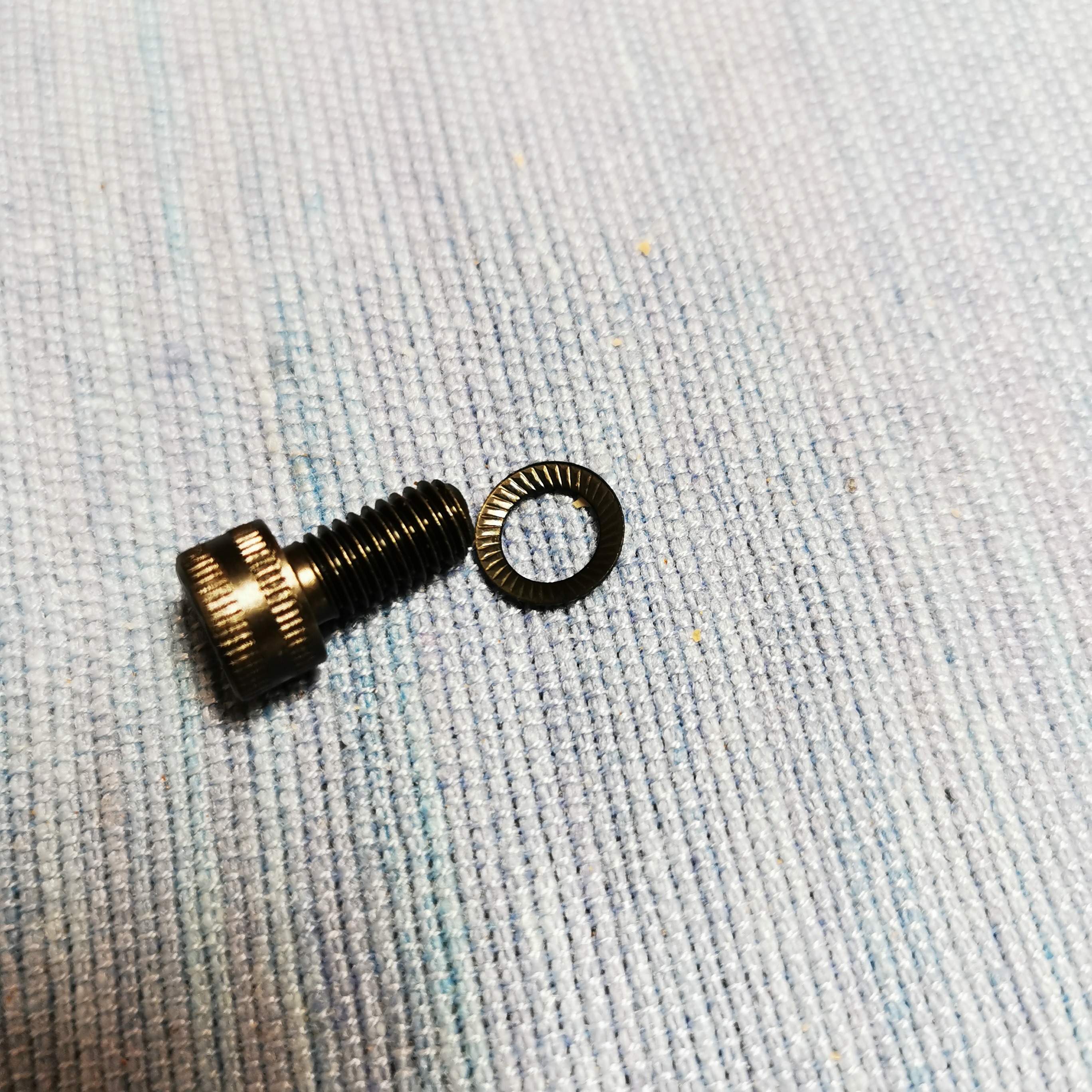

New bolts are 14.9 tensile tensioned to 16Nm and serated washers.

With the adjustable cam chain sprocket I can set the Crank at TDC with the chain tensioner installed then use the pliers to rotate the Cam to the desired position ( well so that the Lines are parallel to the case) and lock up the Bolts that hold (hoping :)) the Sprocket.
Previously I had to accept the position the chain decided.IMG_20240125_155955.jpg
