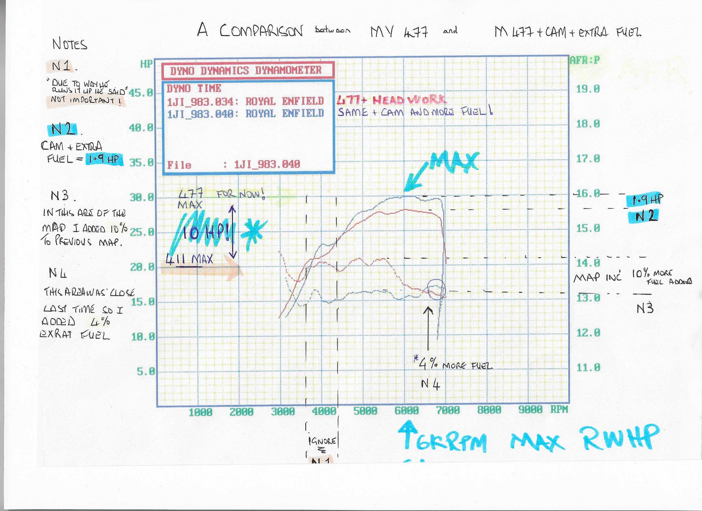

Here is a very interesting dyno chart from Dool that shows that up to 30 REAL HP (not BHP) are possible with various add-ons to the 477 upgrade: (for a bigger version right-click and open in new tab)
(Lately he went up to 31 REAL HP (on the wheel) by using the TEC camshaft (UPDATE: today we of course use our own HT-b camshaft for that) - and that value may be top of the line for a 477)
