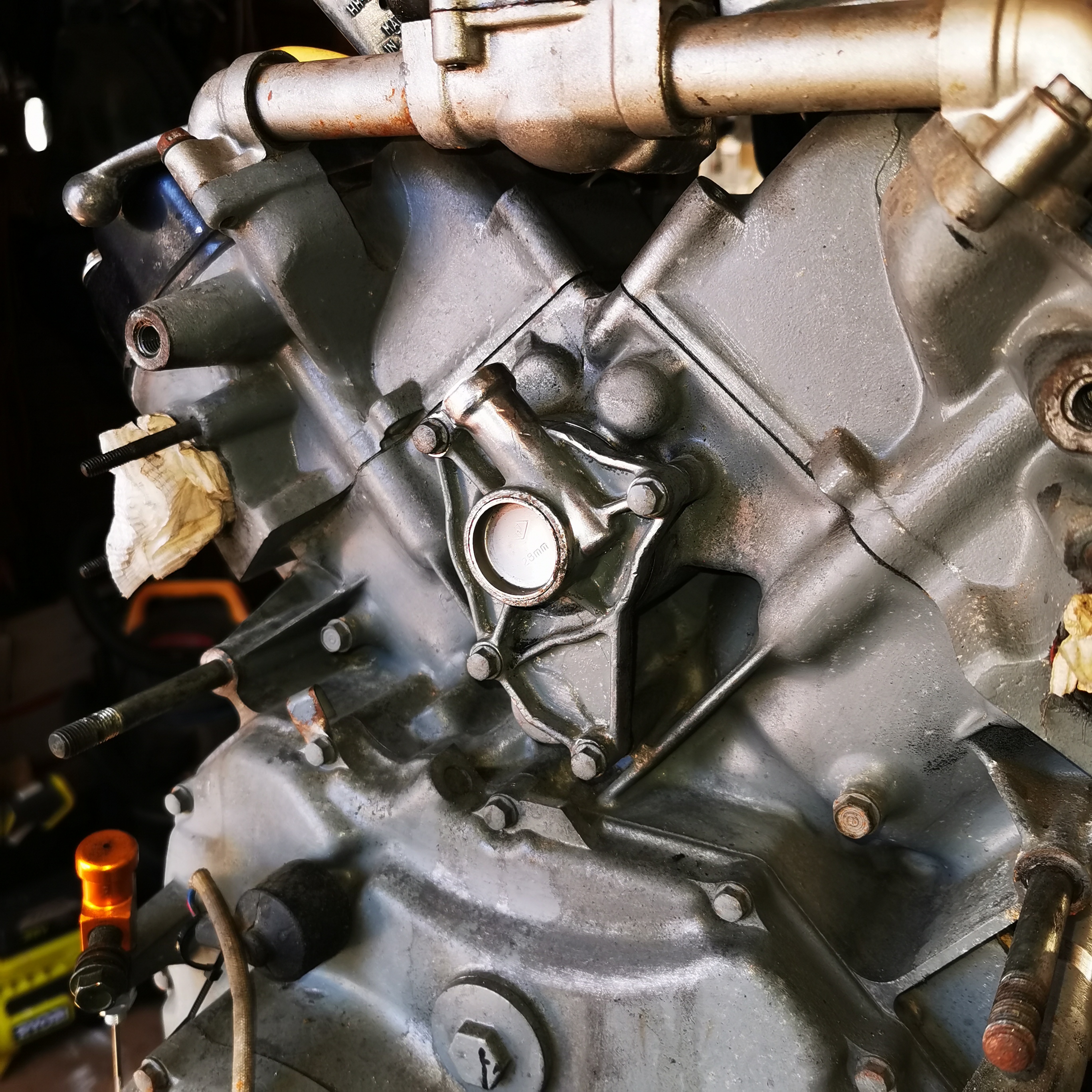

Butcher strikes again, the Camshaft drives the Fan or did, OS with it not required I decided to shorten the Camshaft and get it back inside.

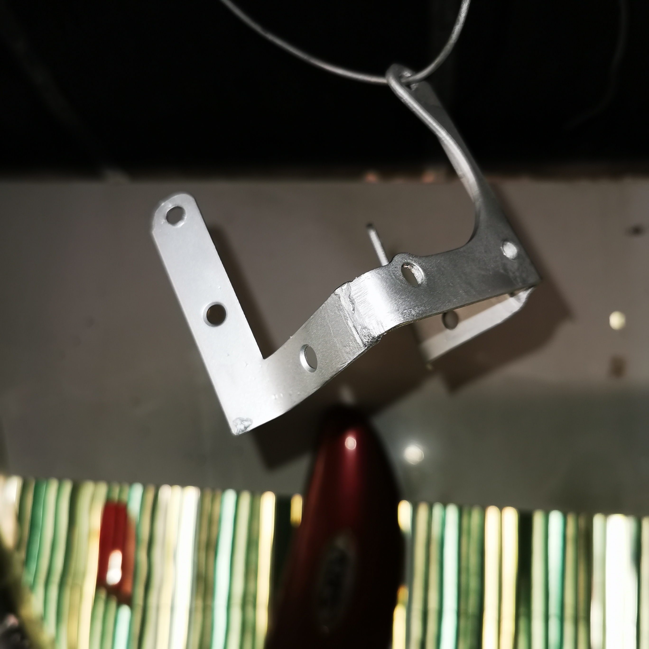

The thermostat outlet had to be turned to point backwards, so I needed to modify the bracket.
Front cover of the Cam is now sealed with Welch Plugs, 28mm at the front and 9/16 in the Tacho drive.

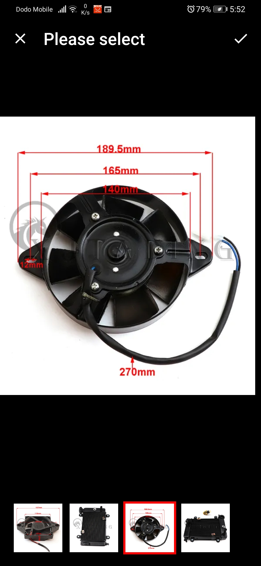

Yes the Radiator I am fitting has brackets for a fan. I gave up trying to get the OEM radiator to fit.
I am hoping to use an aluminum radiator from a 4 wheeler. Screenshot_20230831_175249_com.alibaba.aliexpresshd.jpg
Might overheat🤔
I am hoping to use an aluminum radiator from a 4 wheeler. View attachment 1257
Might overheat🤔
That should be provide plenty of cooling power, go for it (and cross your fingers :ROFLMAO: )!
