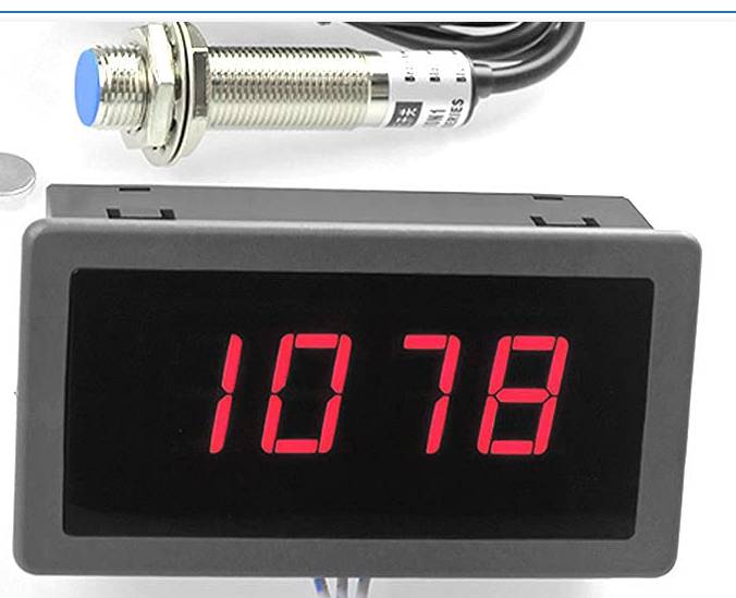

a while ago I purchased this item from Amazon:
and bc my mechanic had no clue how to install it I left it sitting on my shelf until I got the idea to ask Grok (my current fav AI) if it could figure out how to do it.
didnt have much hope but lo and behold, Grok came up with more than one suggestion.
I leave the initial discussion out bc it was mainly to clarify certain aspect and the final solution only concerned with positioning the hall sensor which is quite large was as follows: (if anyone finds a fault or has a better idea please let me know!)

This'll bolt right on your Himalayan or Scram—stable, accurate, and reversible. If you upload a pic of your bike's engine side or the exact model year, I can pinpoint bolt sizes. Hit the trails!
If anyone has a neodymium magnet (8–12mm disc, 3–5mm thick, N52 grade) lying around - please send it to me. I cant seem to locate one here in India. The ones available are either thicker or thinner of the wrong strength. Or I would have to buy 1000pcs in a lot...
I can not understand the logic here, why not take the signal from the ignition coil, seems less messy.
Gluing a magnet to the flywheel is not likely to end well.
sounds good, however likely the instrument needs a certain input from the hall sensor, how am I getting this from the ignition coil? afaik the hall sensor needs the magnetic field to count the rpm, how is that generated by the coil (I know some magnetic field is there but not in the same strength)
Amplify the signal?
What signal does the magnet enable with a Hall sensor?
More turns of signal wire on the high tension lead?
I gave up with the cheap digital tach from aliexpress because I couldn't understand the instructions, too few buttons for so many functions :)
technically the permanent magnet rotating with the crank induces a current in the sensors head whenever its field cuts through the space the sensor head is in. simple electrodynamics, the 3 finger rule of field orientation.
now, whenever a high voltage is run thru the ignition coil the same is true to an extend, however the hall sensor is calibrated to react to the 52 strength permanent magnet - and I have no idea how the field strength near or at the coil (or the cable to the spark plug) would be.
I will discuss the idea with Grok though.
got a reply:
No, a standard Hall-effect sensor will not reliably detect the ignition event if you simply place it near the ignition coil's body, the low-tension (primary) wiring, or the high-tension spark-plug lead on the Himalayan 411/410 (LS410 engine).
The magnetic field around the primary winding is very weak and messy (shielded by the coil’s steel core and the engine cases). A normal digital Hall switch (SS41, AH49E, etc.) needs a field of roughly 50–300 Gauss to trigger cleanly; you usually get only a few Gauss at the surface.
OK, there seems to be a solution with a little bit of work. My soldering and transistor tinkering days are 50 years in the past but I guess a diode, resistor plus one transistor arnt too much of a circuit for me to glue together. That replaces the hall sensor and input goes straight to the instrument. I have the entire discussion/instruction saved in a word file if anyone is interested. because my south india trip is nearing I will likely do to after said vacation - along with a 500cc markup of the 440 scram and subsequent test if the OEM ECU can deal with that (maybe plus fuelx pro plus but no PT 4).
