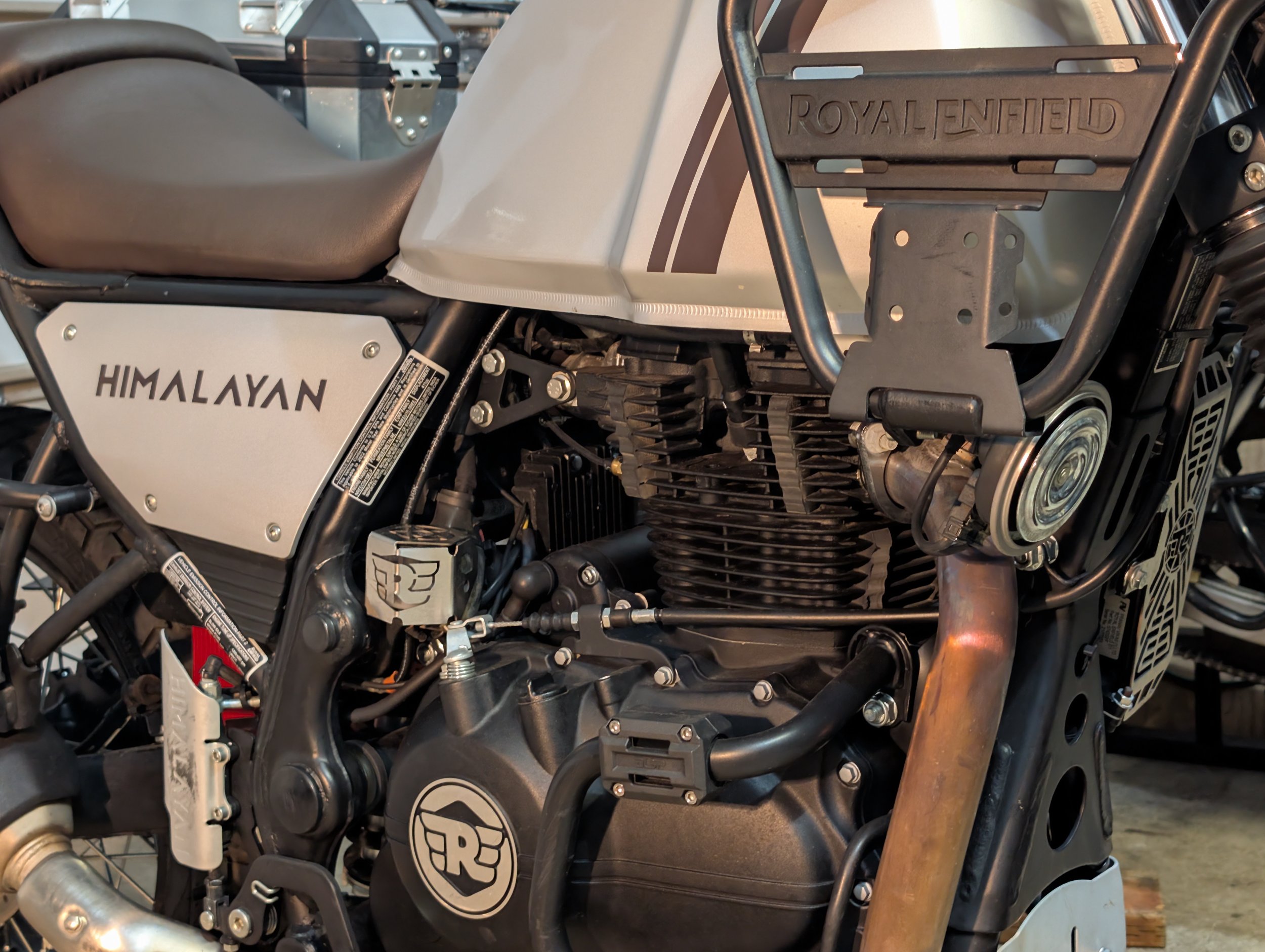

I own a stock 2021 BS6 Himilayan 411. Evap removed.
It has 3k miles
I recently did a valve adjustment, checked my timing chain tensioner (sits at half, chain stretch ok), changed my oil and greased the swing arm and linkage assembly. I have typical tappet noise and some minor timing chain noise. (My valves were WAY too tight. Less then .08 on BOTH. I set them to spec .08 intake .23 exhaust and the tappet noise got louder but chain noise reduced.) Lastly, my spark plug showed signs of hot and lean (ash deposits, some dicoloration). My piston has some black carbon, not a lot. For low miles, this bike seems to be.... problematic. Rough idle, backfire, louder than I expect mechanically.
I have low engine noise! (I put a towl over the exhaust and listened closely. Noise around oil pump and clutch basket area.)
When I put my head under the bike I can hear it clear. Are these engine generally loud in the top and bottom end, or is it possible I have a bearing issue? Do oil pump chains on these bike have a lot of noise generally?
I have a "chirp" when my clutch is cold. Ive read a lot about this on other bikes, mine has it. My clutch feels nice however.
I have only rode this bike about 100miles since I bought it. I dont trust it for distance or off in the mountains where I want to be yet.
Thank you so much for your feedback.
