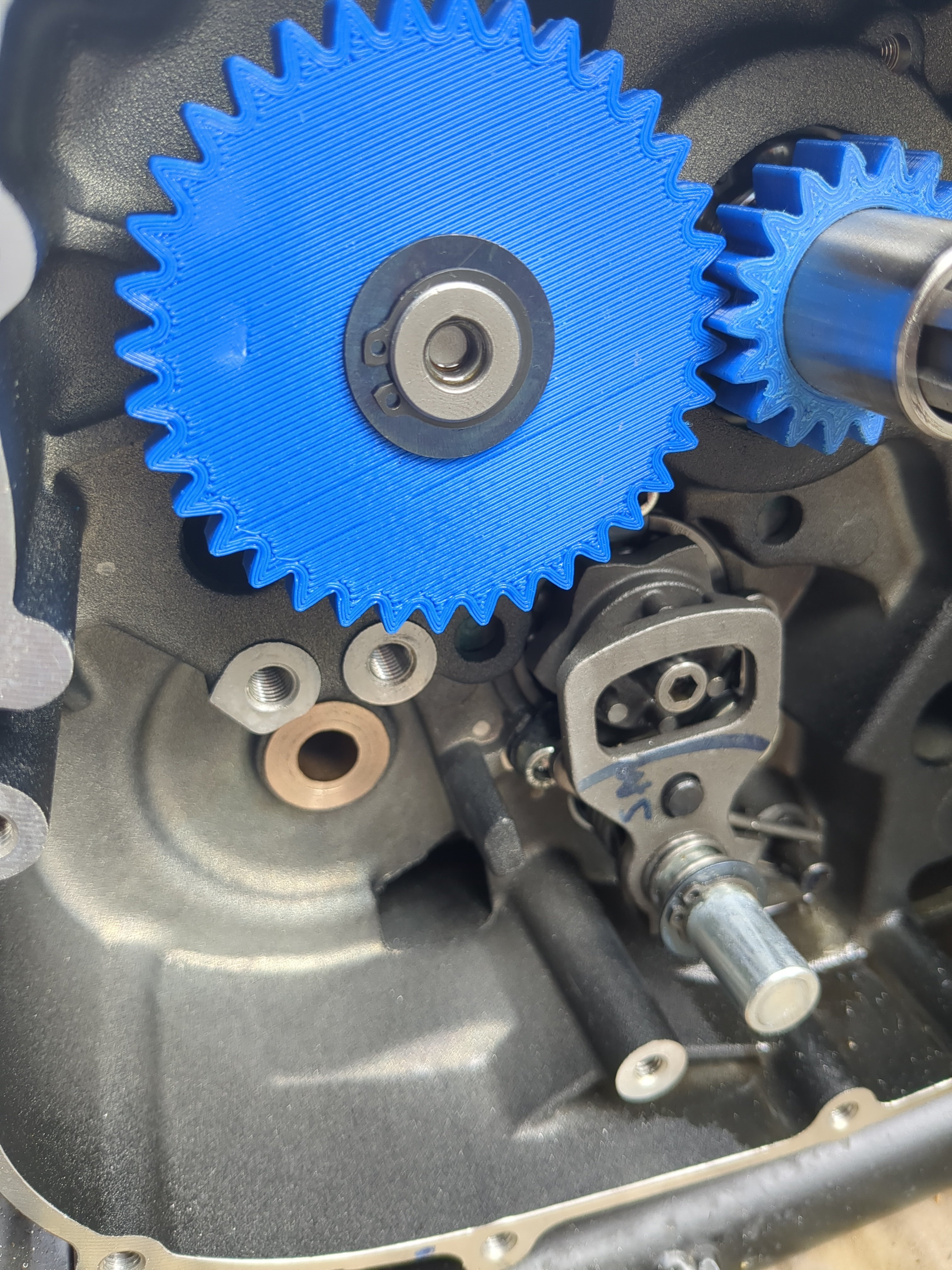

The good news is i found a bronze bushing that only needs a liitle bit of machining to fit. I already removed the coating inside the crankcase where the bushing will be placed. It is quite thin actually.

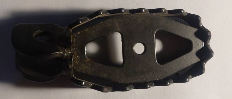

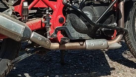

Anyone having ideas how to make the right footpeg foldable so it stays in the up position for kick starting? The passenger peg uses a little ball but that won't work because the main footpeg has a spring.
I'm currently busy on the 500 conversion of my own bike so that has priority over project kickstart unfortunately. The tinkering never stops though... :)
Depends how permanent it should be. If you remove the rubber it is easy to fix a wire or hook that clips on to the brake arm running on top of the foodpeg. May not look all that fancy but will work until a genius comes up with a better solution.
Yeah, that will do for now. Then i think we are sorted for the outside engine part of the kickstarter project. So now i only have to fit the bushing in the crankcase and then design the last sprocket and kickstart mechanism. That sounds easier than it is...

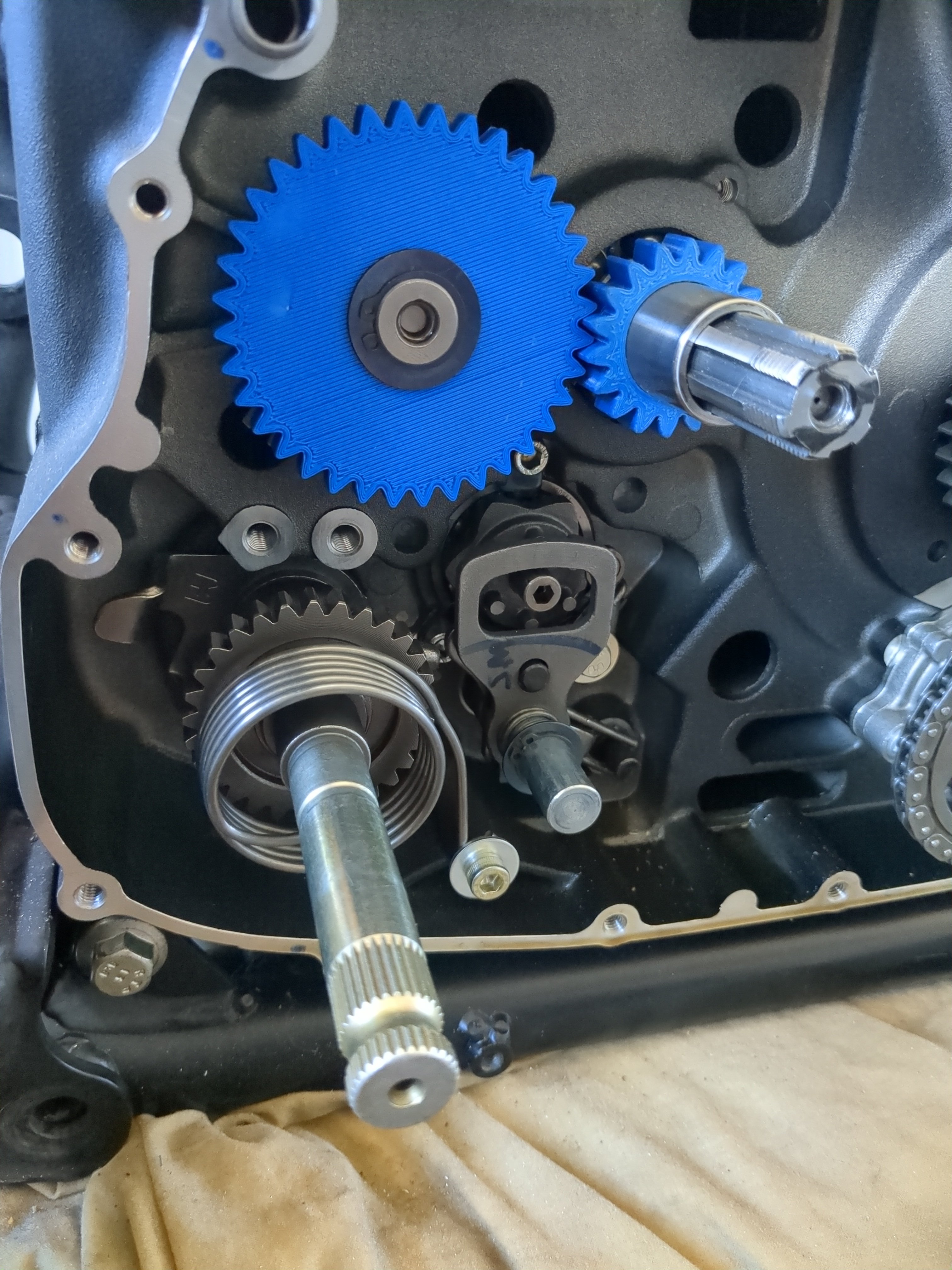

I machined the bronze bushing and fitted it inside the crankcase. The spring of the bullet seems a viable application in this project. Just had to make a little bent to fit it. Essentially all parts to make it work are now inside the crankcase. Challenges left now are making the right endstops and aligning the sprocket with the idle gear (big challenge!).

if its easy to make the plastic dummies you could mail them to me. i have a guy who makes sprockets 4 me, should be similar. may have to buy 10 each but i guess once it works i can get rid of those 😁
if laser cutting is an option a corel or eps file would suffice.
It should be a guy who has experience with gearbox/machine gears and not secondary drivetrain motorbike sprockets, thats a different league...
Maybe ask him first if he is able to replicate (and i mean not china style replicate) the tooth design of the sprocket on the clutch basket.
I think we also need a bearing/bushing inside the sprocket and the sprocket/teeth have to be chromed or hardened possibly. If he doesn't blink than it's worth a shot
