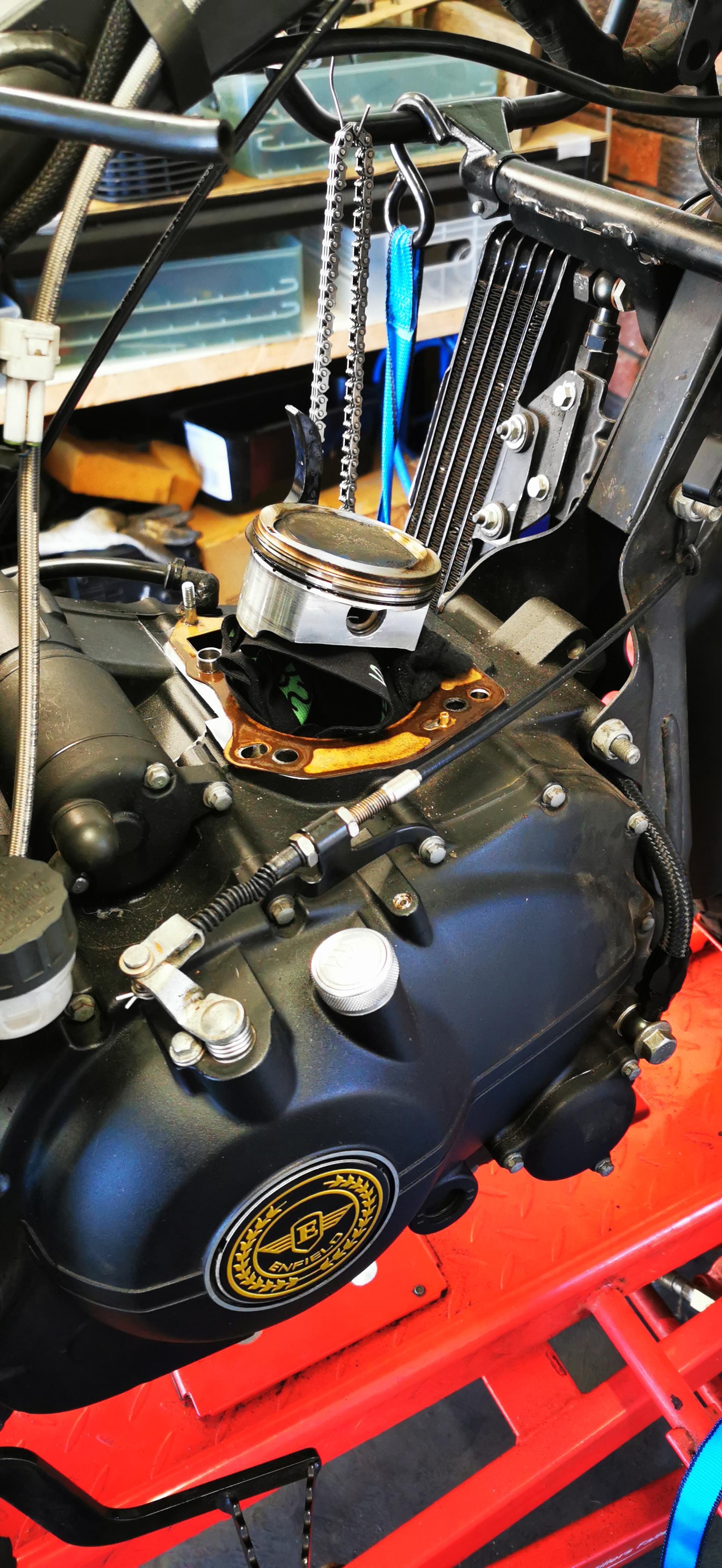

The many modification done to my first Himalayan have been great fun and resulted in a 48 % power increase over stock.
Now the time has come for it to go and the modifications are being reversed.
This is challenging but probably not going to be great fun :confused:

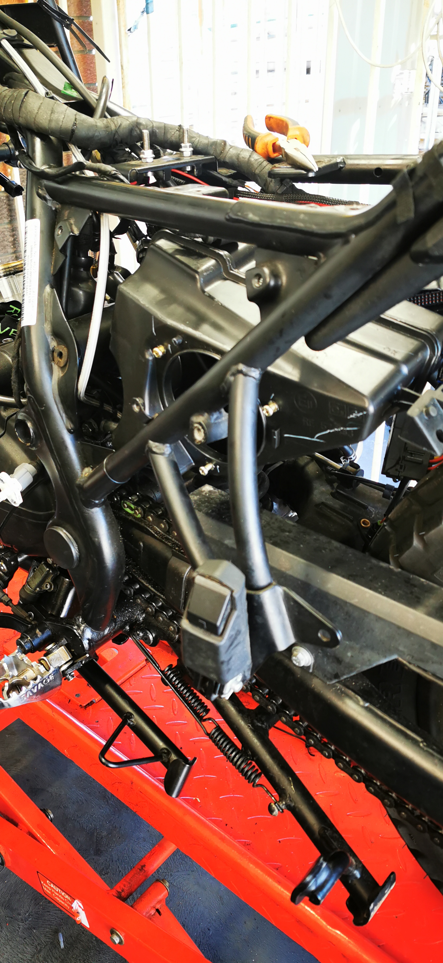

Air box Delete was nothing compared to getting it back in!
This bit is no challenge, I have done it before :cool:
Anyone interested some "big bits"? PM me.
big barrel, head to suit, inlet and throttle body 34mm, Red box, Delkovik Header pipe, Lextec Muffler.
Yes going to sell this one taking back to stock so it doesn't ever beat me 😉
