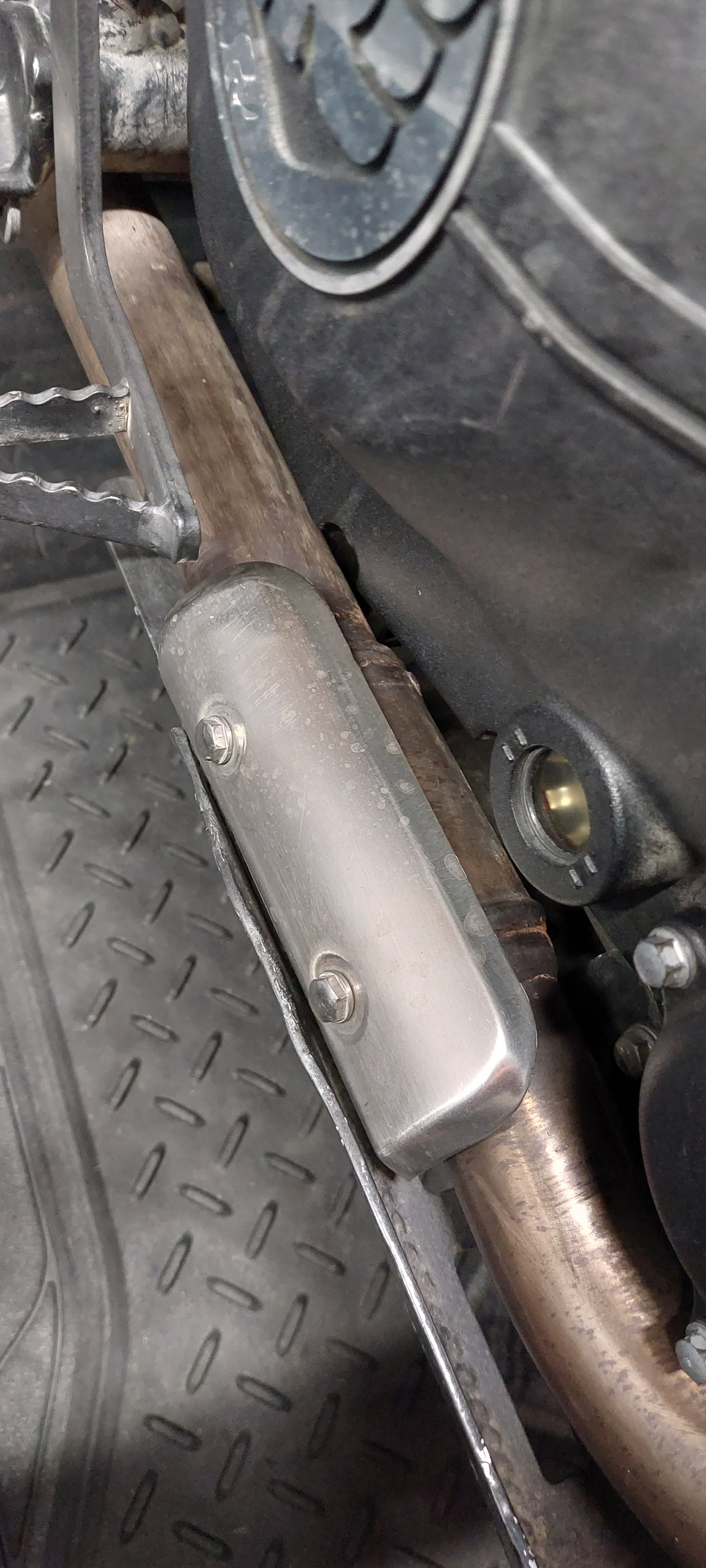

This is a BS4 Euro4 exhaust pipe - where is the cat located?

There are two. One in the bulge of the header pipe and one in the silencer/muffler.
this is BS4, they do not have the bulge - BS6 has. if it is in the muffler then changing my BS6 header pipe to a BS4 one should work if I want to get rid of the cat !?
But you also get rid of the O2 sensor surely.
Carby models would have no 02 bung, no bump/ no cat.
Next model had O2 bung, Bump and Cat horizontally mounted.
Then it had an O2 bung and a Bump/Cat mounted Vertically and closer to the exhaust port thereby allowing the Air injection to be deleted?
That's my understanding anyhow!

My 2018 Carby BS4 has a cat in the header pipe
. Under the head shield bottom of pipe just in front of riders RH foot.

My 2018 Carby BS4 has a cat in the header pipe. Under the head shield bottom of pipe just in front of riders RH foot.
that solves the riddle where the BS4 has the cat. so I really need a BS3 pipe.

A cat does not need any electronics to do its thing. That is why my stock standard carby has them too. A cat is just a honeycomb made from metals (platinum/rhodium, etc) that when it gets to the right temperature it acts as a catalyst for engine emissions to further oxidise/burn. That's why on BS6 it was moved closer to engine exhaust to guarantee hotter temperatures and to meet higher standards.
