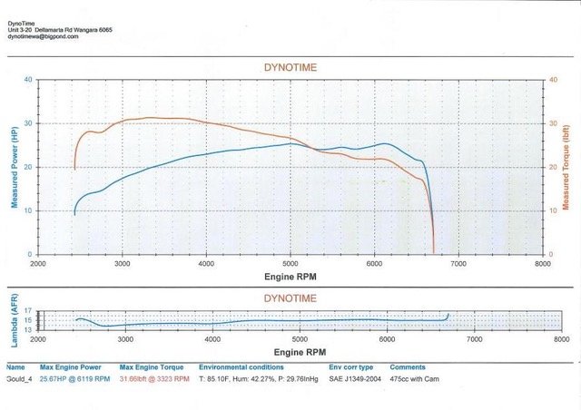

Tomorrow I return to the Dyno that all my Himalayan runs/Mods/Improvements were done.
This time its being done backwards ( again) run will be the 475cc (500) as run 1 then a week later run 2 will be full stock 350 to determine the Base line.
Followed by stock plus Cam only, I hope.
