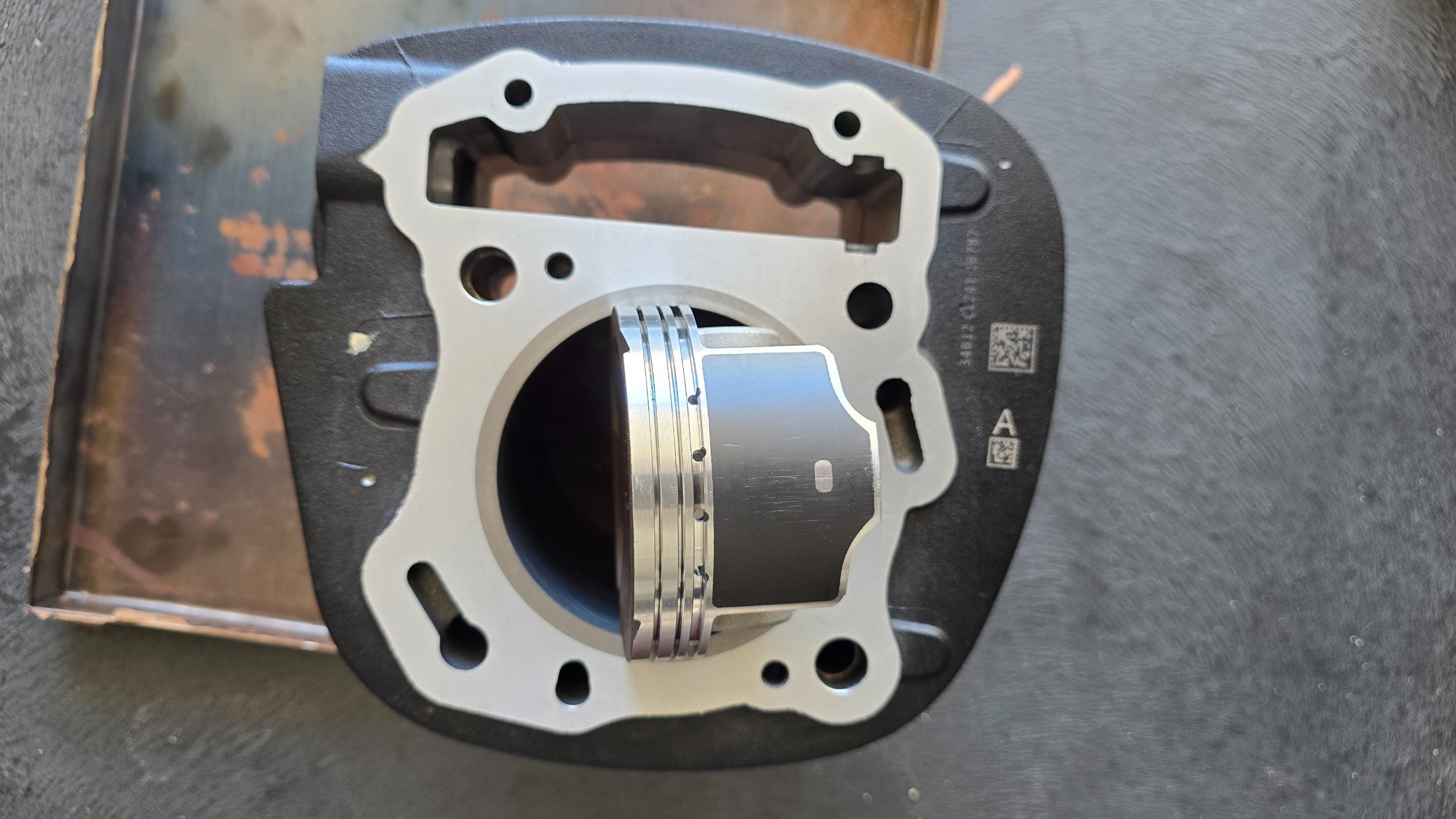

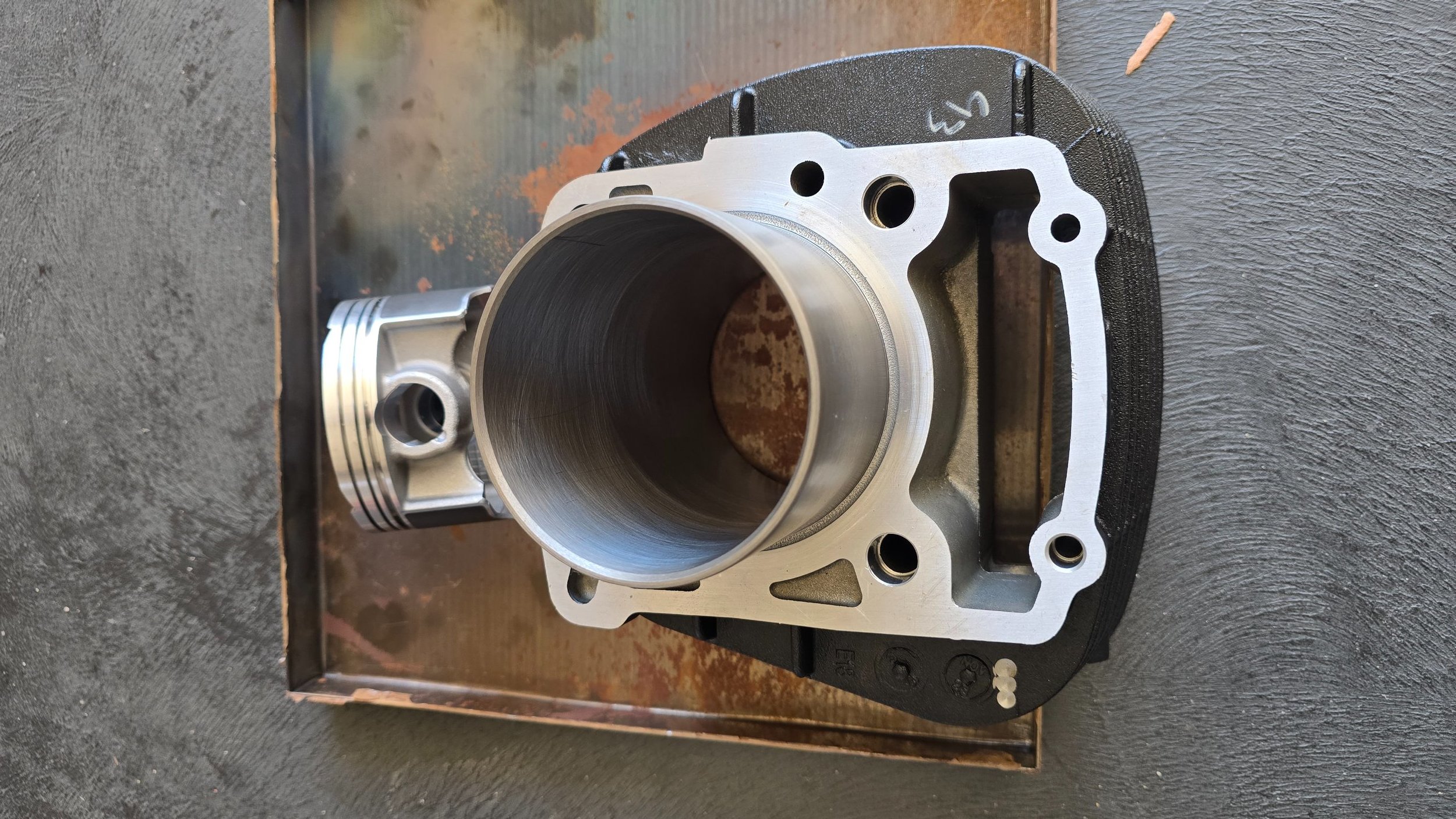

Well close anyhow at 442cc!
I figured the 410 was too easy and the 475/500 was a bit over the top considering the size of the crank bearings.
So somewhere in the middle perhaps is a good spot
With this costing me about A$550 (not including the barrel)so far I do not see it as a viable seller and am just doing it for the most important person I can think of,,, me
Very healthy 3mm of liner.
