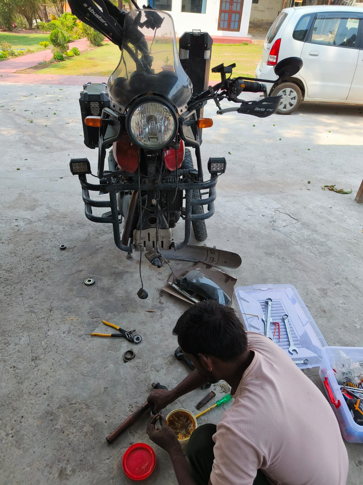

sam2019 Administrator Staff member Distributor Developer 477 Owner May 2, 2024 #1 Changed the OEM today in my 2021 Euro5 Hima because the steering had become very hard and unyielding: I used Japanese bearings for replacement Attachments WhatsApp Image 2024-05-02 at 16.45.05_64c913e5.jpg 282 KB · Views: 148 WhatsApp Image 2024-05-02 at 16.45.05_69d76752.jpg 124.8 KB · Views: 153

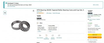

sam2019 Administrator Staff member Distributor Developer 477 Owner May 15, 2024 #2 These are the bearings I use. You need 2 piece of course, top and bottom. ca. 8 US$ a pop. Attachments Clipboard02.jpg 84 KB · Views: 175
