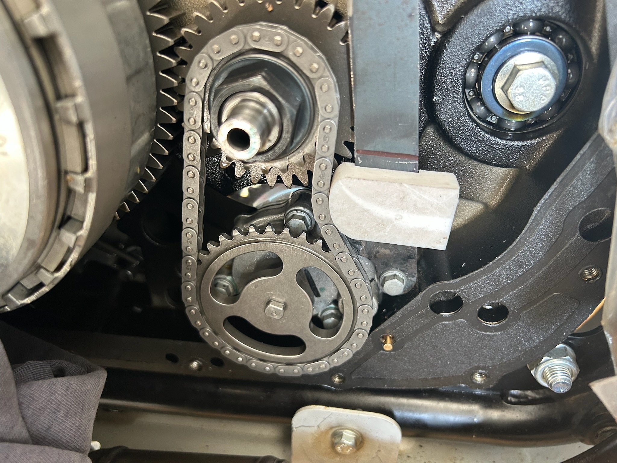

@Dool: is the oil pump chain normally so loose?
This is a 2019 BS4 right?
Thank you very much for the reply,
– yes, it’s normal for the oil pump chain to be that loose. The noise is not coming from there.
Recently I saw a pic where the owner made a rubbing block to reduce the chain slap, I wouldn't bother myself but it can be done
I will not put that small “block” on the oil pump chain. The noise isn’t coming from there, even though in the video it might seem like it is.

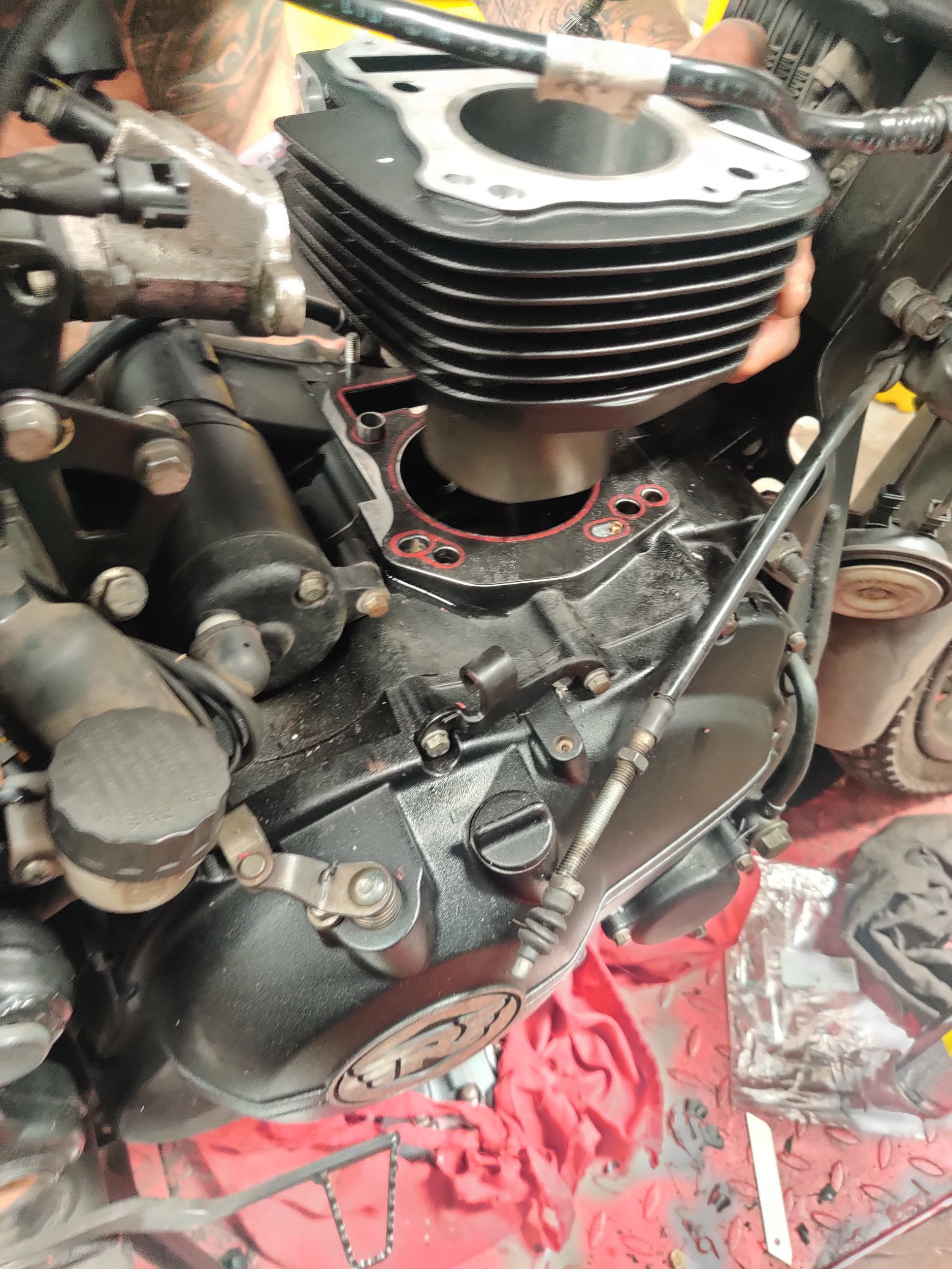

Hello everyone,
I found it.
It was the pinion rubbing against the cylinder...
We disassembled everything, replaced the piston, the cylinder, the rings, etc.
It takes a very long time, and it is very expensive.
Good luck to those who will have this problem.

I think he mistyped - the only thing that can rub against the cylinder is the piston. however, what he really means is: seized
btw: here is would take 45 minutes and cost about 100 US$
A seized piston is almost always (and I am careful here) based on low oil. In rare cases it could be overheating but only when going very slow for extended time in high ambient temperature.
Piston pin? That can also rub against the cylinder.
Yes, i have only seen piston pins come out in Harleys due to excessive bigend wear.
Piston seizure is likely in this case, but would changing the parts solve the problem...
Hello everyone,
Indeed, I wrote my last post incorrectly.
What I meant to say was that the piston was rubbing against the cylinder.
Replacing the cylinder kit, the piston, the rings, etc...Very expensive and time-consuming!
…After only 12,000 km! I always maintained the bike properly, particularly the oil, and I never rev'd it very high.
