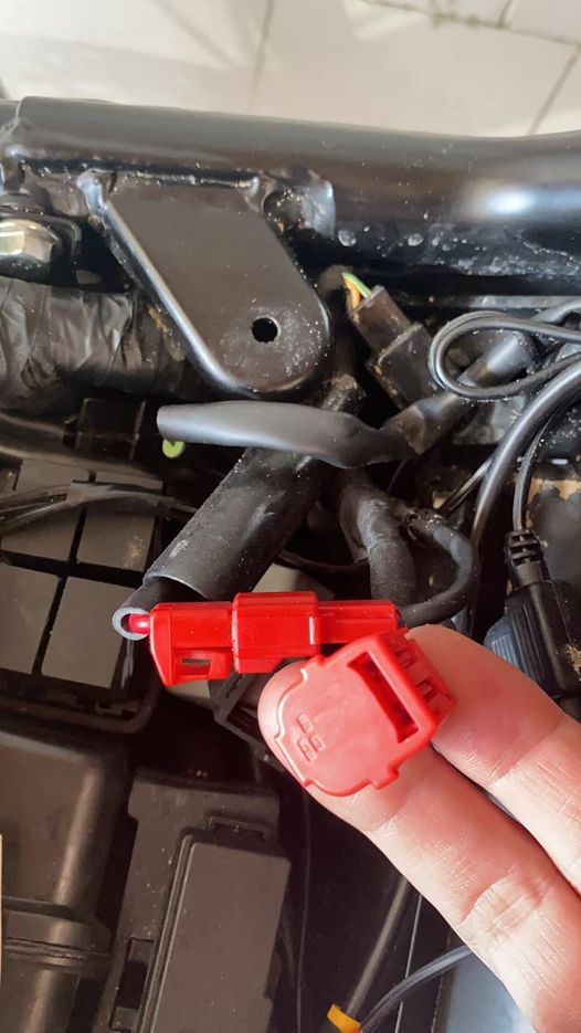

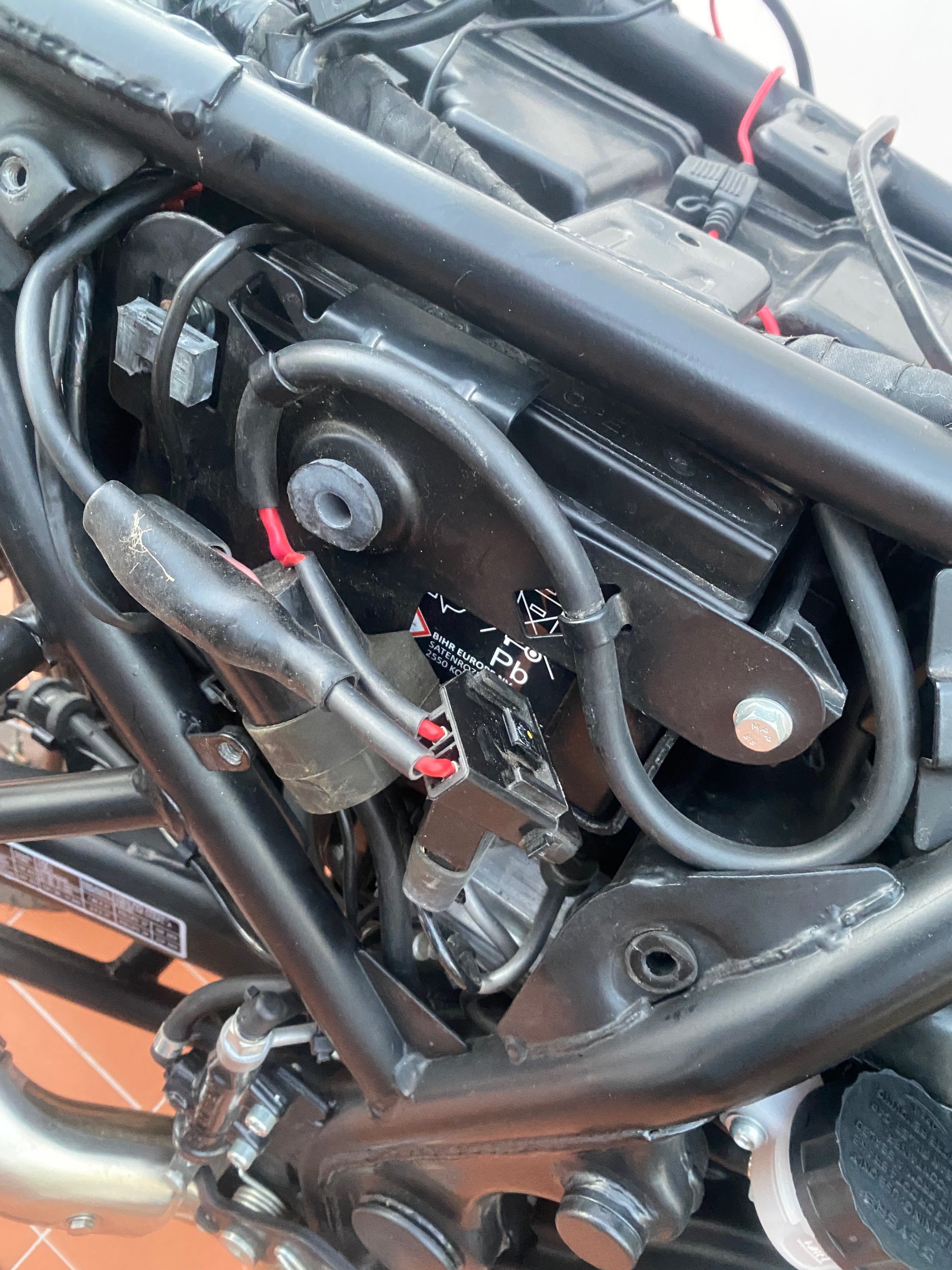

Apparently the plug for the cable that connects to the dongle is different from the simple one used by BS4 in the BS6 variant. That latter one is Honda compatible.

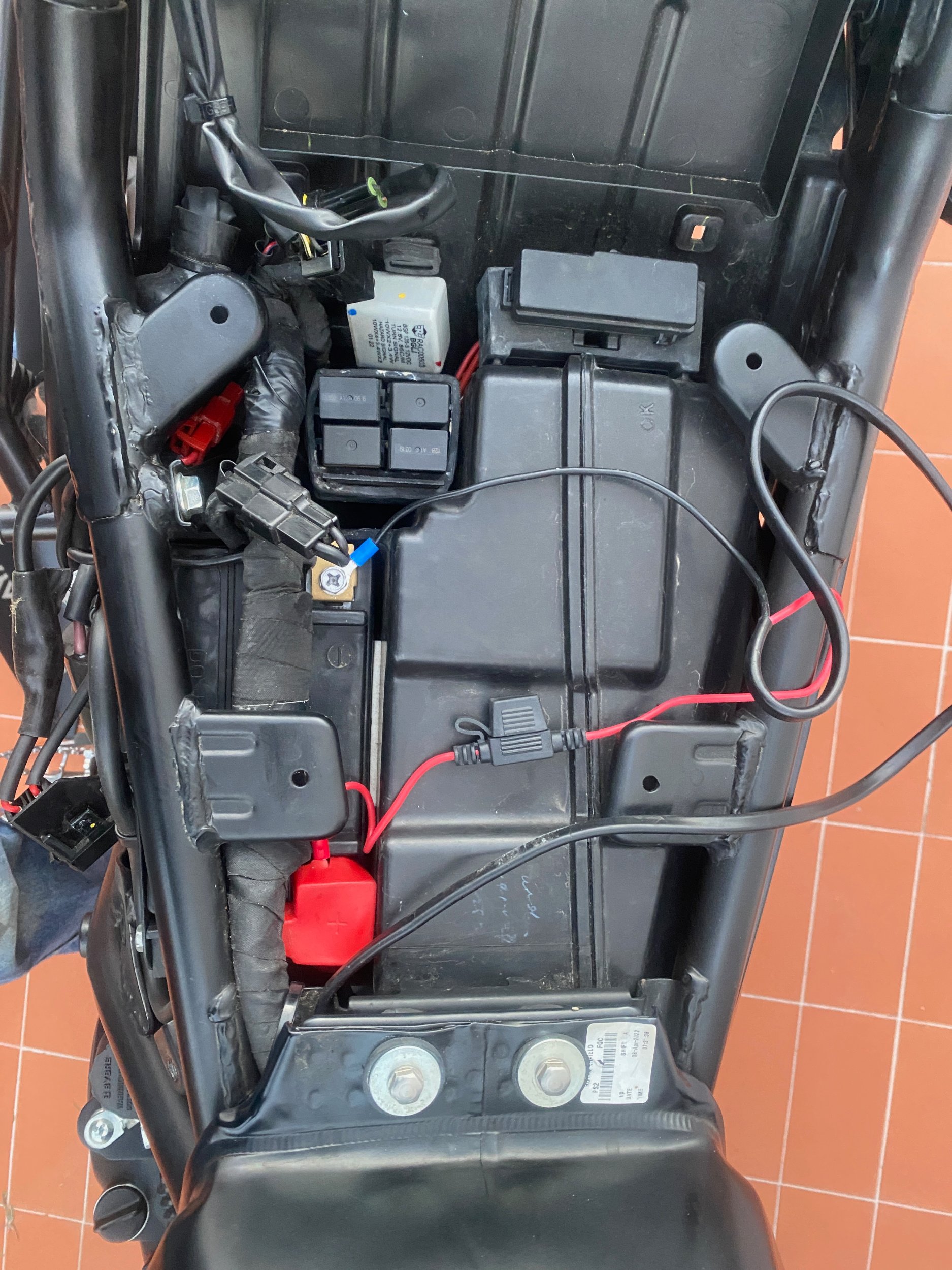

So for now here is what I have got from Amazon so far for about 15 US$: btw: the CD is useless - does not work.

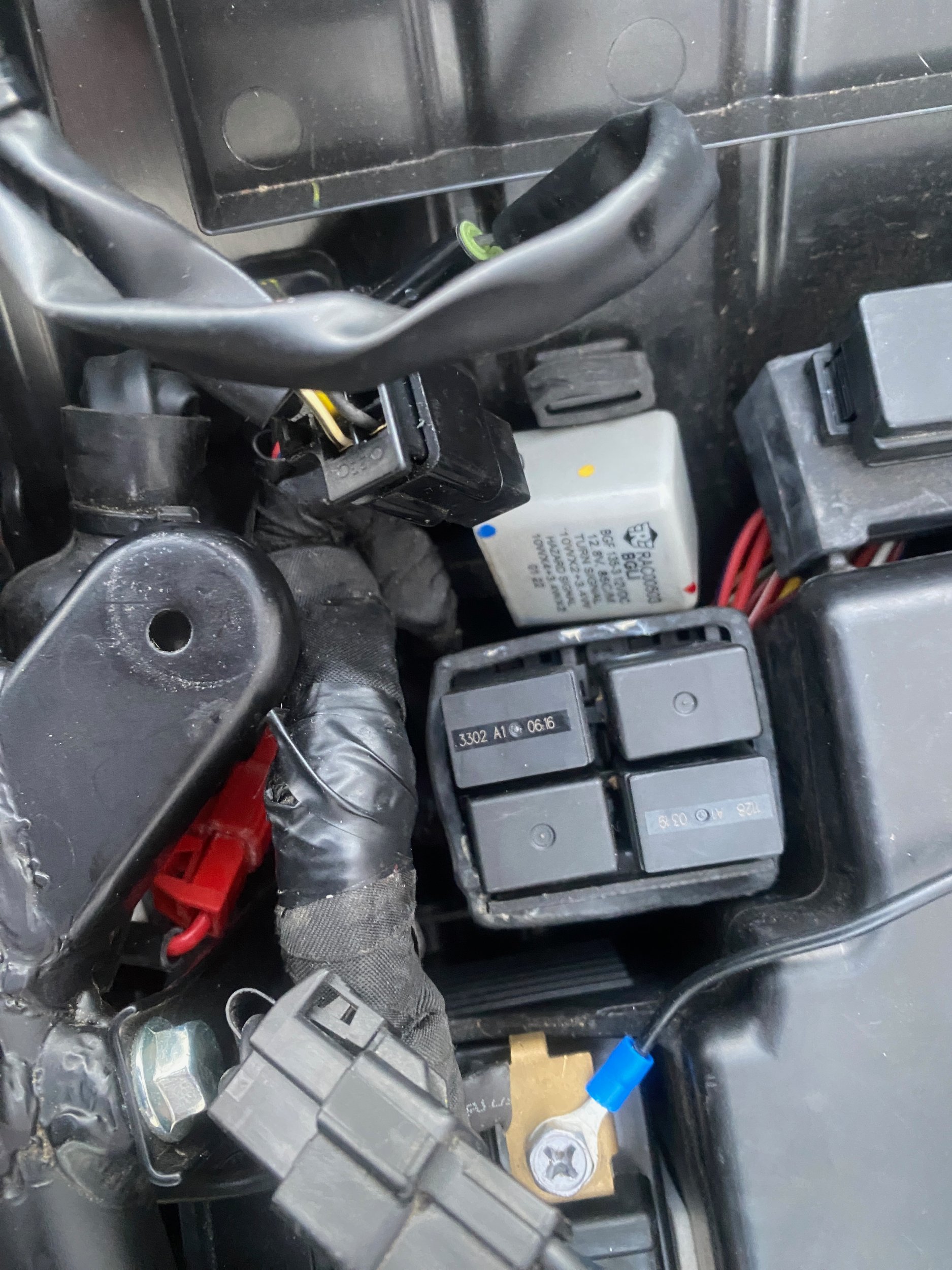

BS6: It seems every time you have problems with the relays this LED comes on. This video in GERMAN explains it quite well. This is the one I may use for translation titled: Help, my Himalayan does not start up":
This is the plug for the cable:
