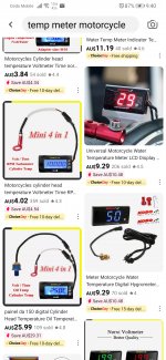

I"d love to but we have not been able to find a location for the oil temp sensor (like we did on the Himas) - maybe there is a way to catch the sensor data from the head sensor somewhere in the harness and then figure out which instrument would take that input and add it to the cluster.
I would try one of these that use an eyelet. Screenshot_20240203_094049_com.alibaba.aliexpresshd.jpg
If you find one that fits bring it. I cant order from Aliexpress - it has been banned in India. I do not so much like those multi purpose thingies because inadvertently one will choose the wrong setting, e.g. have time or volts displayed while your engine fries ...
