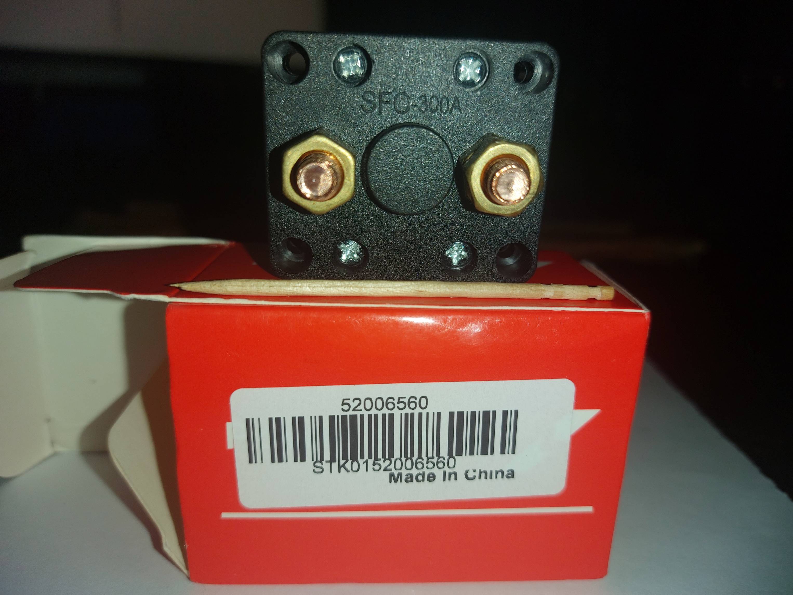

What IS easy however is installing this switch. Place the switch in the space next to the battery under the seat. Its also a quite ingenious theft protection - unless someone carries the bike away on a truck.
The toothpick is not part of the set - its just for size comparison.
This switch is widely available on ebay and amazon. Just google for SFC-300a
